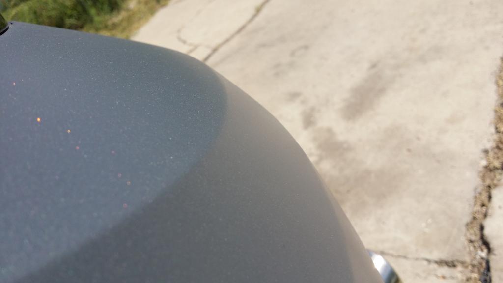

It's 25% gunmetal with 25% black + 50% pearlizer with some silver holographic flakes. It's cloudy and really hard to pick up the flake on a picture but in person the flake goes crazy lol. For some reason the flake comes out the most with the moonlight.

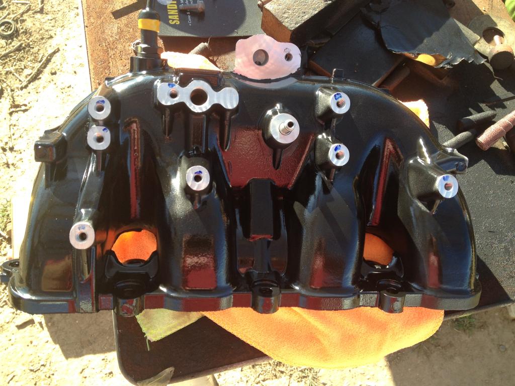

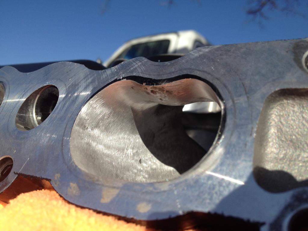

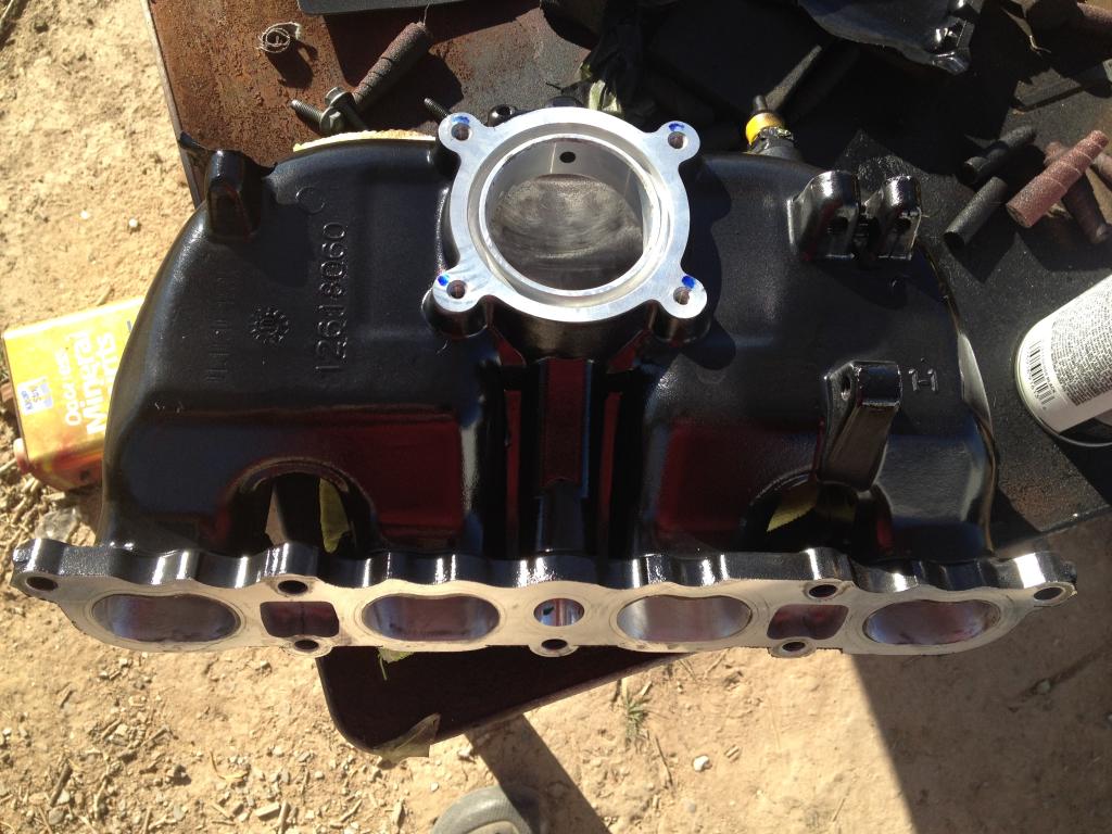

Finished porting one of the LDK manifolds, and am now painting it high-temp gloss black.

You can somewhat see the flake here. Really effin hard to capture in pics lol

Nice effect try and get one at night to see if you can see it better

Just plain dupli-color engine enamel in gloss black. Porting is easy. You just need an air grinder with 3" extension from harbor freight, or a dremel type tool with a 1/4" collet, not the 1/8" one that comes with actual dremel tools. It is all smoothing, not reshaping the runners or anything complex like that. Just make the walls smooth as possible and try not to touch the speed hump portion too much at all. I was able to get my ports all within .05-.1mm of each other.

Fair enough. Not sure you'd need a retune for ported manifold but I don't know LNFs well so I can't comment. It'd be interesting to log how differently it reacts with each mani but I need an LNF before I can do that. I'm not happy with how the paint turned out but the flaws will be on the underside of the manifold anyway so whatever:

To me it looks pretty good lol

Thanks. I'm beating myself up because I like perfection. But can't justify another can of paint if I expect to flip these two manifolds. I'm pretty sure wgr73 tunerlocks his tunes or I'd swap you manifolds just to see the difference in trims and throttle response. Aw well, eBay here I come!
