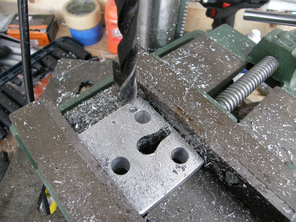

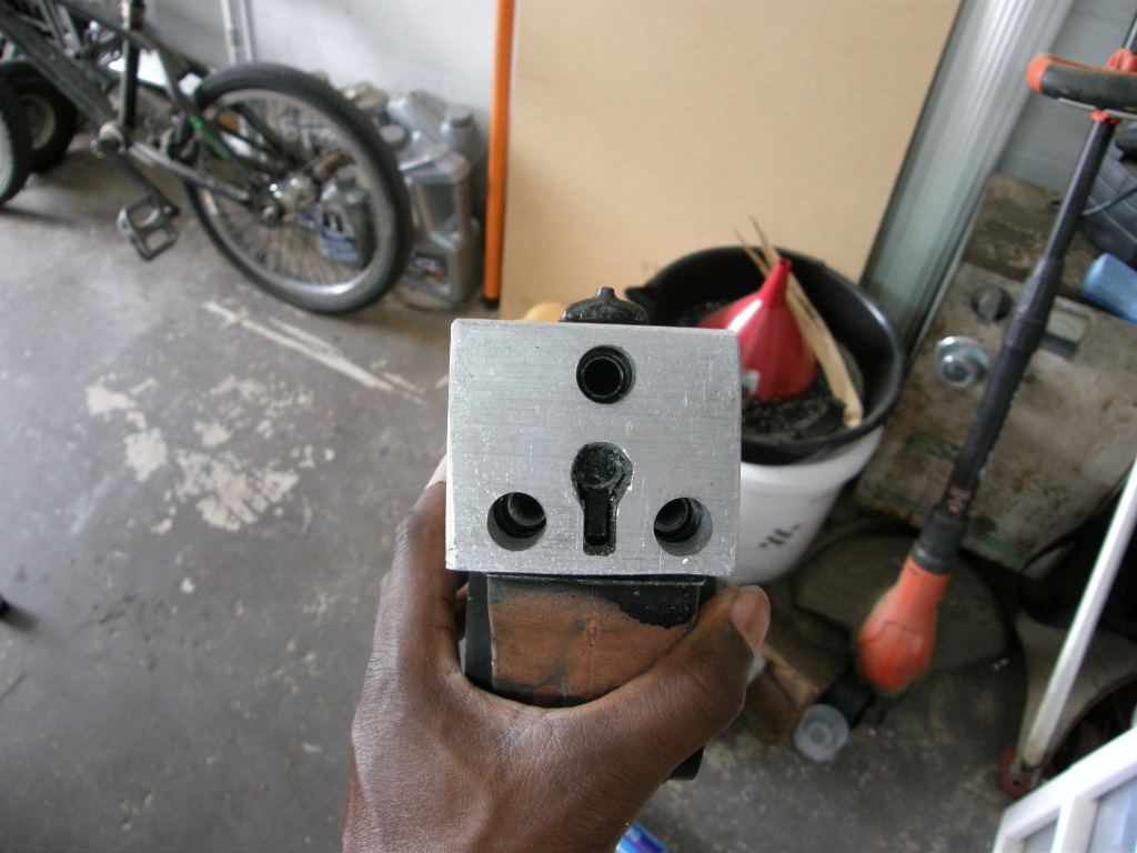

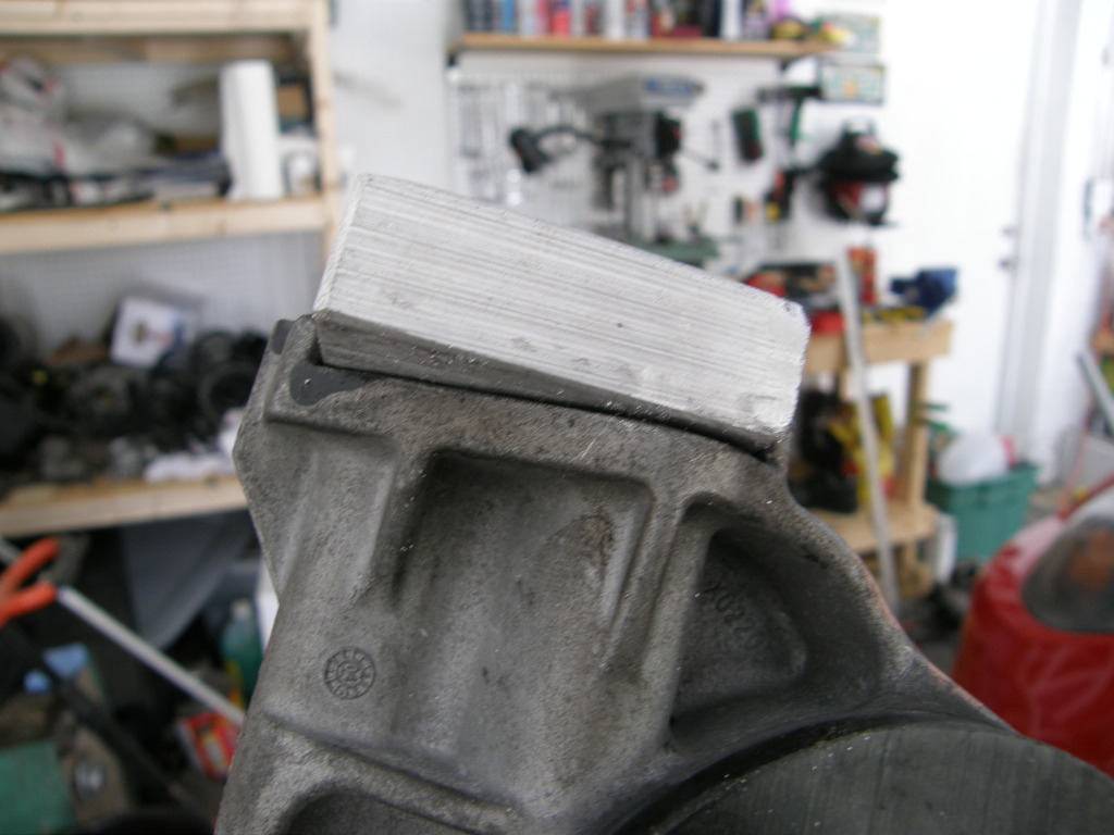

Made my own rear engine mount spacer 1/2 thick ,More for axle bind then wheel hop.
, i'm using the stock front mount becasue its flexibility will compensate for the raising of the rear of the engine.
When i find a chunk of poly urethane i'll make a offset bushing for the front mount.
The holse are even,its just the angle of the photo that makes it look odd.

Damn man it's huge 1/2 post some pics when it's gonna get installed

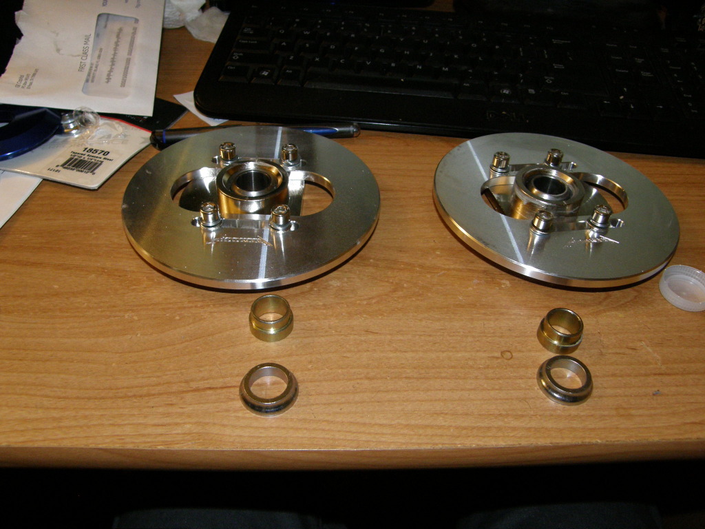

Yeah my header is pretty close to the fire wall now. It's installed i just need to spap a pic next time i have the car jacked up. The axle aliment is better ,but still not straight, but at lest the axle bind is gone, i'm not even sure why i was getting axle bind because i'm not that low. just barely tucking tire on 18's.
Tomorrow goes on ottp's rack spacers (when they get here hopefully)
and then i'm gonna try and figure this out. Should be fairly stright forward...

Originally Posted by phatnackySS
Very interesting! Where did you get those? I'm guessing the bushings to adapt to the stock shock rod?

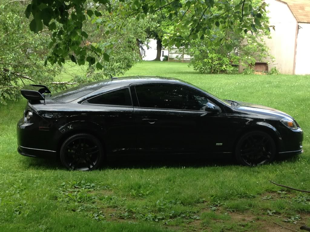

this

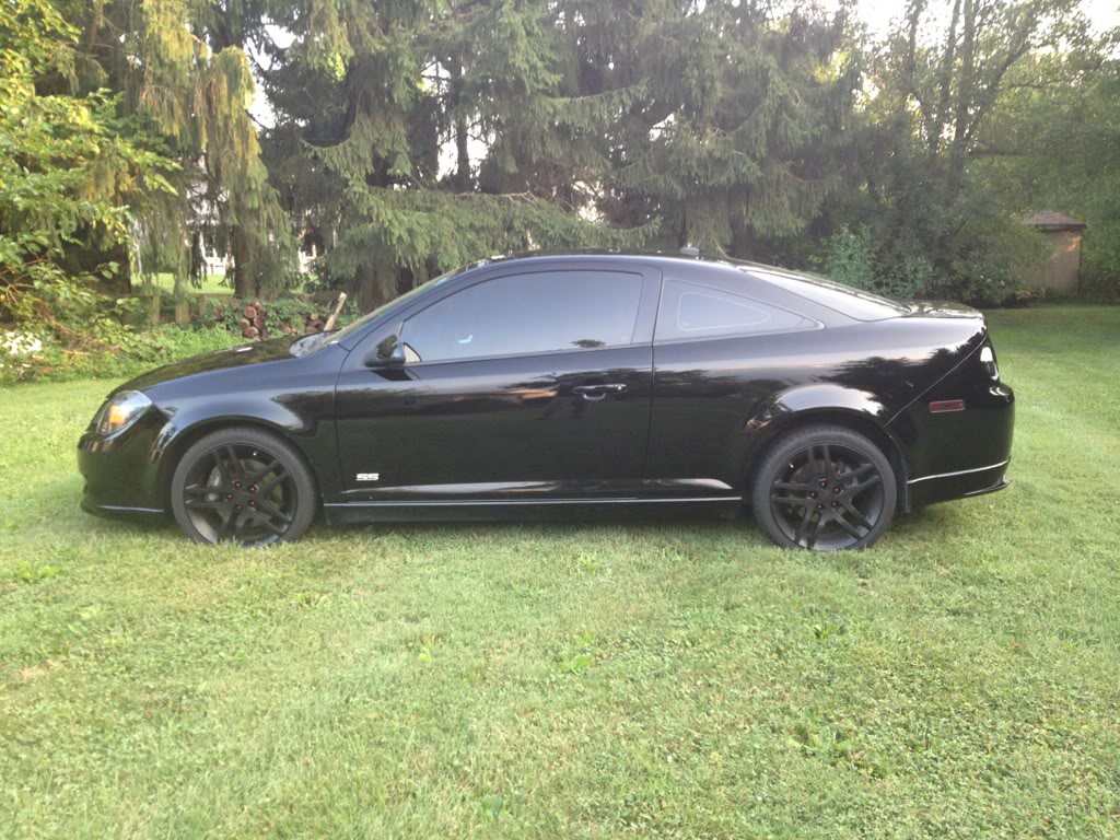

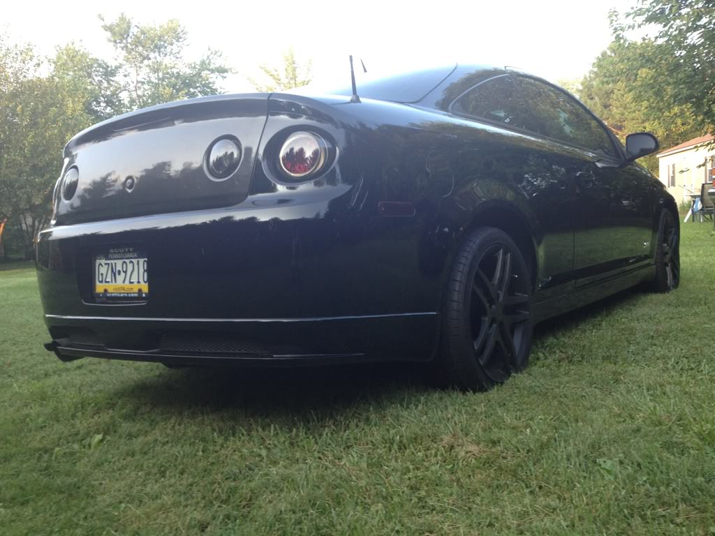

to this

Originally Posted by 1995chevy
this
I'm sorry but this car looked bada$$ before, murder'd out batmobile, I know its your car, but damn, it REALLY looked sick before
