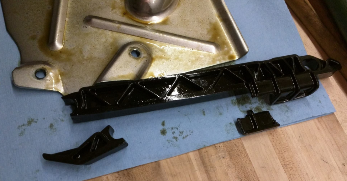

Hmm, what have we here? Shouldn't there be a guide there?

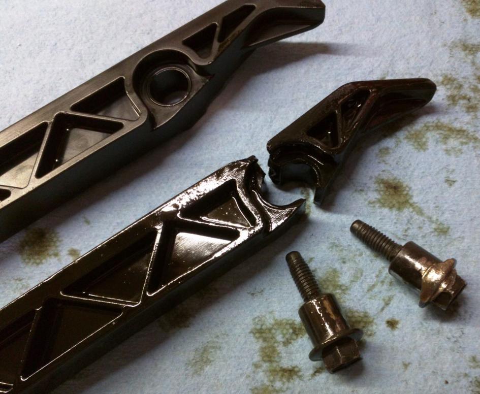

Yep, that there is broken.

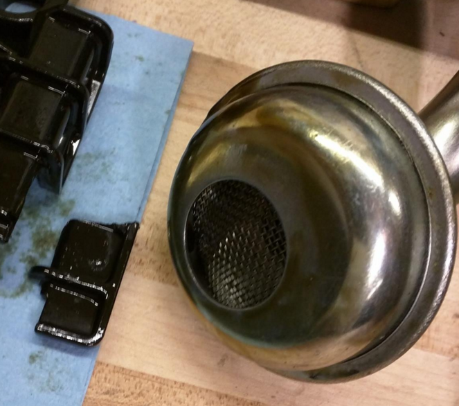

Good thing I decided to drop the pan too. Found this bugger inside the oil pickup.

Hellabroke
