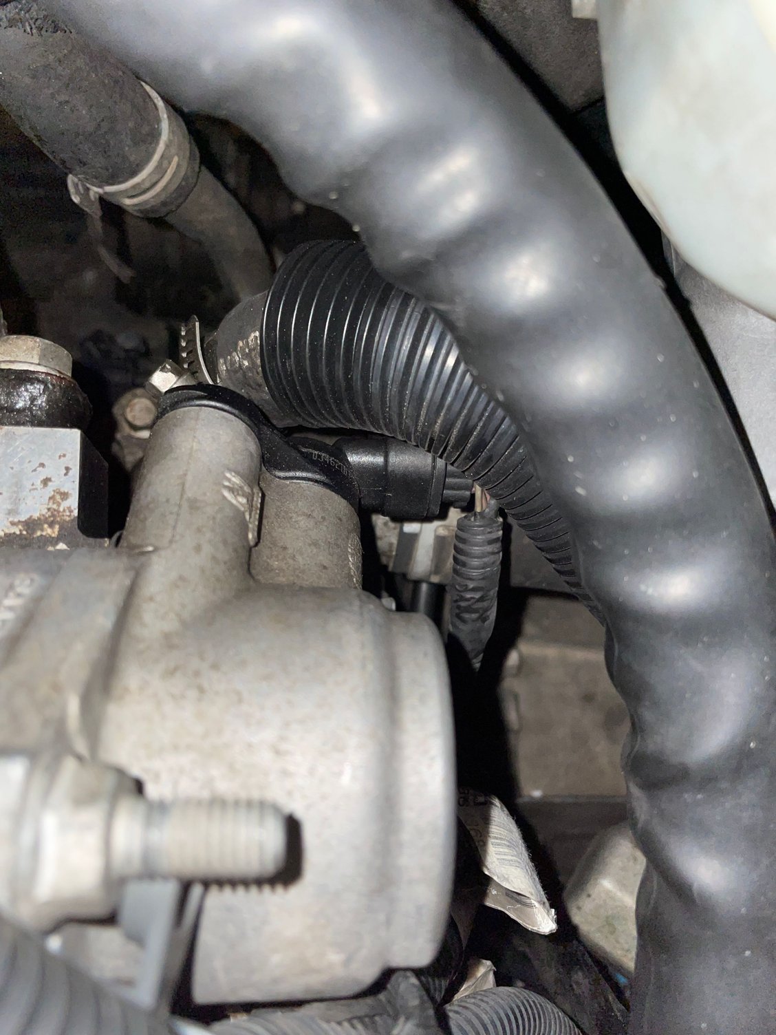

Did you remember to plug your cam sensor back in? It's located on the end of the exhaust cam, right above the thermostat; circled in red below.
It appears to be plugged in, would you agree?

Looks like it. Have you cleared the code and it keeps returning? Does your car start up right away or does it take a handful of seconds and/or two attempts?
That code essentially means that the Cam sensor and the Crank sensor are not in agreement about the engine's position. The cam sensor (iirc) is used to start the car, and then the crank sensor takes over. When the cam sensor is not reading or reading incorrectly, the car will default to starting with the crank sensor, and that can cause extended cranking times. Typically, this code is caused by someone removing the housing, but not reinstalling it properly... or timing the engine incorrectly (timing chain).
How many miles/km are on the car/engine? Every replaced the chains or the timing chain tensioner?
