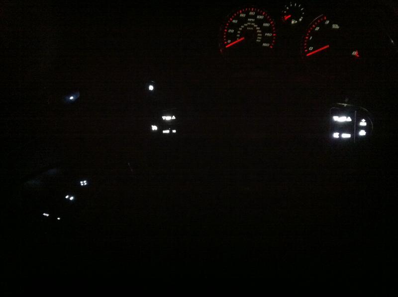

gumby3558's Avatar
Joined: 12-07-10
Posts: 113
From: Florence SC
im having trouble with my install in my 06 ss i cant get the d/s window swicth and my driver info button to be bright. i know its not the bulb its the way it is trying to disperse the light
jest gotta play around with different things you'll get them right.

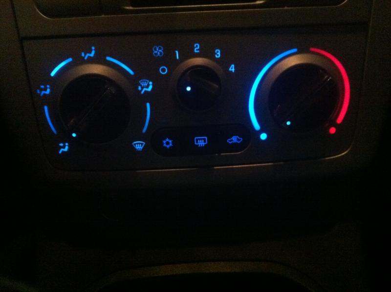

im trying to do my hvac bright white... is there any way to get rid of the blue film?
I thought I posted up on this Its pretty much impossible. The light blue that it comes out as really looks good though, its what I have In my car.
yea sorry I must have missed it. it does look good with the blue tint its just not what i was going for lol but i guess it is what it is.
