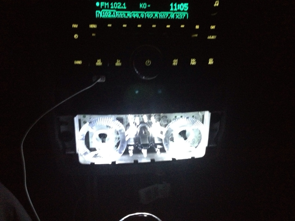

so i changed my HVAC board to white LEDs and it looks great when i powered it on

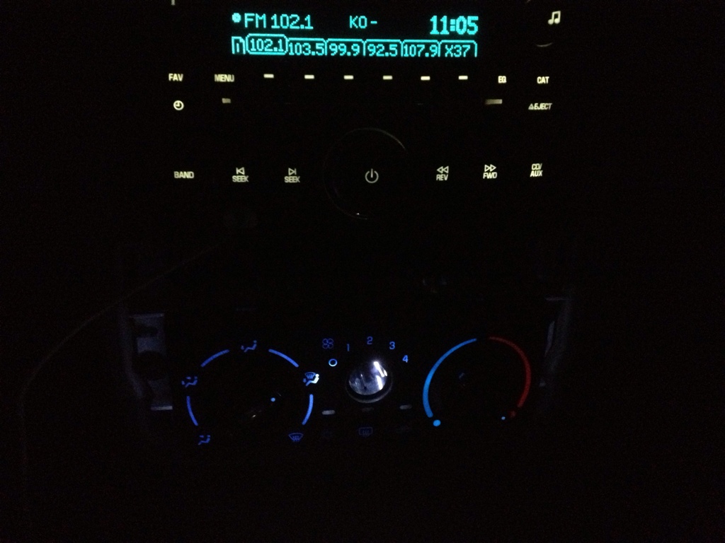

but when i went to put the faceplate back on, i get this ugly thing

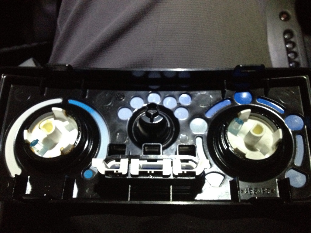

so i took a look at the back of the faceplate and noticed a blue film/tint on most of the ares that light shines through
so im just wondering what the easiest way would be to take off this film? other people here that have posted pics of pure white or pure red HVAC controls, what did you do? most people change to blue leds so it doesnt matter for them but it does for any other colour it seems. im thinking of grinding/sanding it off or perhaps a chemical removal perhaps acetone might work?

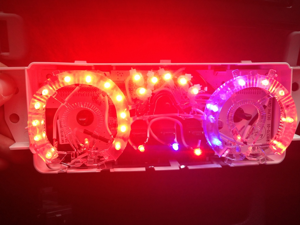

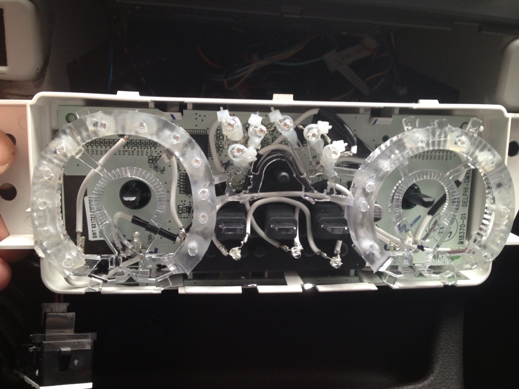

so i achieved a red HVAC control. took 28 LEDs soldered in and it is very bright...

very makeshift job.. not the cleanest but it works lol

right right ya that i can tell but great idea to overcome the fact that just replacing the 4 incandesants with LEDs would loose light output
Anybody discovered the solution to this? Does acetone work? I like that clean white look and im getting a blue hue to my white leds =(

you cant remove the blue tint. i tried with acetone and it started to remove the black paint of the hvac itself. it seems they painted the hvac from the back of the plate and then put the blue tint on top. unfortunately cant be done with white leds
