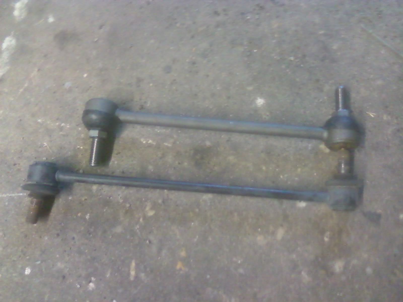

Depending on the space behind your endlink you may be able to fit locking plyers between the endlink and the sway bar and between the endlink and the strut tab. Here is a link to my how to although not as in depth as this one: Clickyhttps://www.cobaltss.net/forums/how-...s-pics-271421/
Oh and to whoever was talking about them being thicker and stiffer, check my link above. I have a direct comparison.
