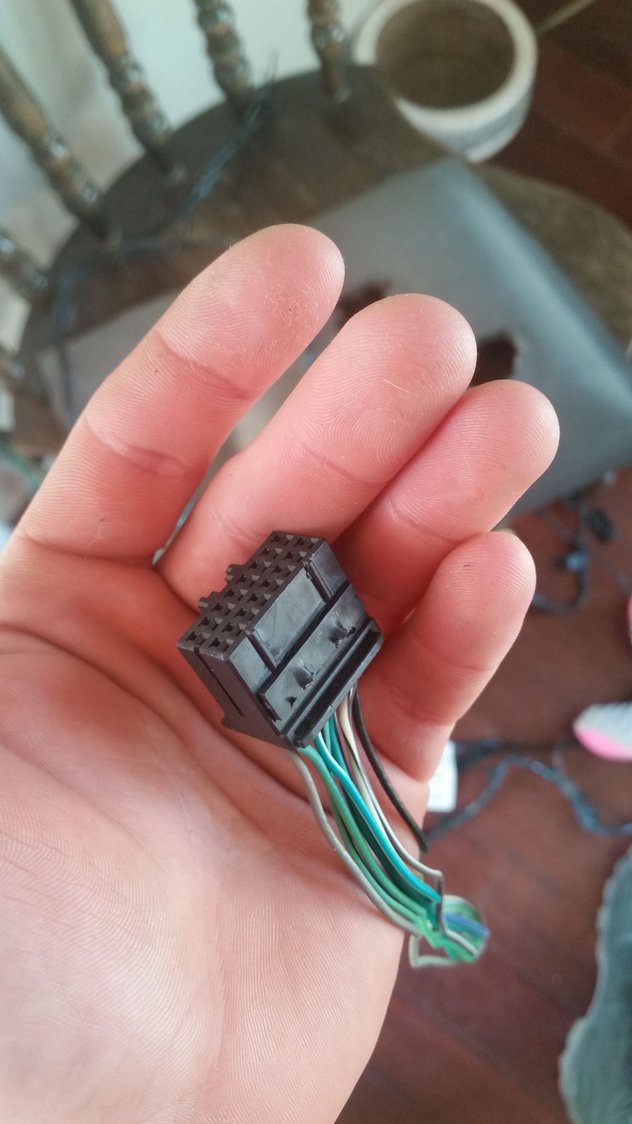

I would like to do thus but does anyone know if it is possible to use the harness from the lsj that it came out of on to my same year le5 I would rather try to plug it in behind the driver rear seat where it disconnects then start splicing **** thanks

Me again as my car is still in pieces loi just need to know if I go through all the trouble to make one out of the two harness and then hook up the green to #13 will it even work due to the lack of wires from one harness to the other I don't carr really if I have on star I just want the compass and auto dim
Thanks
2.4l headliner harness
Lsj headliner harness

I know this thread is old but to the person that started this thread & especially to the person that posted the schematic of the mirror connector... THANKS!
Because of this thread I resolved an issue I always had with my car... no compass. I ordered a mirror from an 07 HHR off ebay from LKQ for $40. I went to install it & if it hadn't been for the schematic I wouldn't have gotten the map lights to work. Those are so cool to have. Besides adding the arm rest, this is my favorite mod
