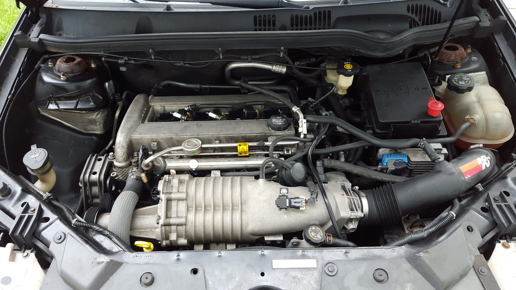

2006 SS/SC 132k miles. Got it for $1,800. Cylinder 4 has 37,756 miss fires. Car sounds like it is running on 3 cylinders. Valve train looks fine, cylinder leak test tomorrow when I get the tool. Car is almost stock aside of the K&N cold air, Magnaflow exhaust I think 3" but I won't know till I get it on a lift. dings and dents but the perfect candidate for a sleeper.
First of all 350whp is what I want to hit and the ZZP LSJ Turbo kit is the route I'm looking to go. 17" rims with 225/45 give or take. Stiffy and reverse trans mounts. Speaker upgrade what ever will fit in factory locations. Aftermarket single din media without the cd player (I think) Body Kit I'm tempted to get something as close to stock and remove the spoiler and get a new trunk lid (right reverse light has rust around it)

Are you planning a rebuild or just getting a newer block? The #4 piston is most likely destroyed and has scraped up the liner pretty badly.

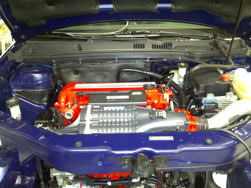

Also I have access to a few great machinist, plus the experience of my dad whos daily is a red 06 SS/SC and has a fully built TVS 06 blue SS/SC and is a GM Tech
Pic of the TVS Name:  IMG-20110413-00033.jpg

Make sure it isn't the coil pack or coil pack harness . Maybe a spark plug but hope the leak down test comes back good.

Red you say? That car looks Blurple to me

Blurple is the built car. This is the Red Daily I spoke of. My dad has 2 LSJ SS/SC

Ok compression test 1,2,3 had ball park 160 Cylinder 4 had 40.. going to pull the head this weekend and see whats going on. Changed the plugs to the NGK 1 range colder (took them off my dads car that is waiting on the cam's getting the hex on correctly to remove the check engine light for the cam correlation)

What cams is he running on the TVS car? I was going to tell you in the PM but I forgot, you can also get a brand new gen 3 shortblock from zzp for 2 grand.

Comp Cam blower cam, but the cam correlation hex wasn't set properly and he never figured it out, so the car hasn't been street legal in a few years

Ya I was going to mention that comp doesn't set the hex properly. ZZP and OTTP sell camshafts that are supposed to be drop in with it already done. The comp blower grind is that the 210/218 dur 423/436 lift
Xtreme Energy™, XE252BHR-13 Blower Applications

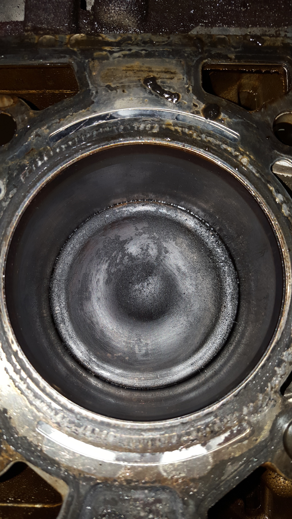

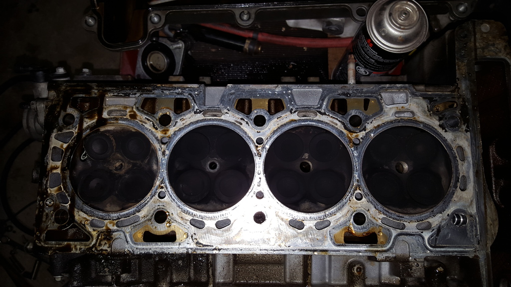

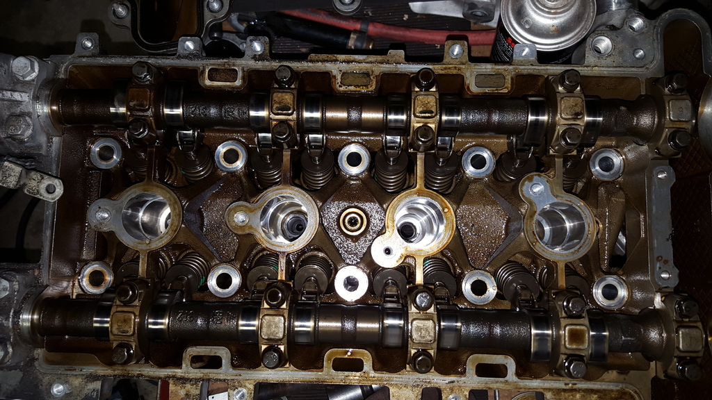

Pulled the cylinder head valves are good, cylinder sleeve is good, we're guessing it's a bent rod or the guy didn't drive the car enough if the ring is broken

Size:  284.5 KB #4 we put a plug in and sprayed enough brake cleaner to submerge the valves to see if they leaked reason it has a plug and looks cleaner
Going to end up pulling the block and getting it honed for some forged pistons, eagle rods, speedtech springs, #80 injectors per BlkWdoSS's recommendation of what he ran with the setup, WOT box also now that I am aware of its existence, probably the GM upgrade clutch, fodanza alum flywheel, rotated trans mounts, I'm thinking the GM upgrade axles too.. The car will be making at least 400whp any opinions?

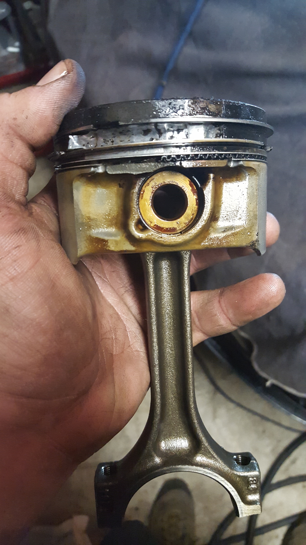

Usually the third ring land breaks, and if it wasn't driven hard or for years the damage to the sleeve can be minor. I'd bet you pull the piston and the side of it is held together by the sleeve. The rod isn't bent unless he hydrolocked it. Also you'd notice it much lower in the bore than #1 piston.
We have a winner lol
It held together very well, I could throw another stock piston in and call it a daily driver but where is the fun in that my 3.8l slomaro can do that. Now I gotta see how long it'll take the machine shop to get me some custom JE pistons (old friend parts at his cost)

Be sure to check the bore and make sure it isn't out of round. With that many miles its probably out of spec. I don't know how much a set of JE pistons are but mongo usually has diamonds for around $425.
