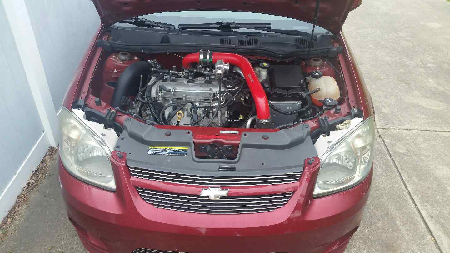

cobalt-ss-engine.jpegcobalt-ss-side.jpegHello, I'm new here. In October of 2017 I bought a Red 2009 Cobalt SS turbo 4 door LNF F35 with 64,000 miles on it. I found it on the internet in Orlando Fl and bought unseen and had it shipped to Delaware. I love it. It's the fastest car I have owned, not that I have owned any fast cars, but all that matters is it makes me happy. It can break loose at 40mph in 2nd with 25psi boost. It had some mods when I bought, but all I can tell is the intake and exhaust mods. It would seem that 25 psi is much more than stock so I assume the calibration is different.

The hot side charge pipe is aftermarket with added BOV. Take a better picture of the turbo, might be able to tell which turbo is on there.

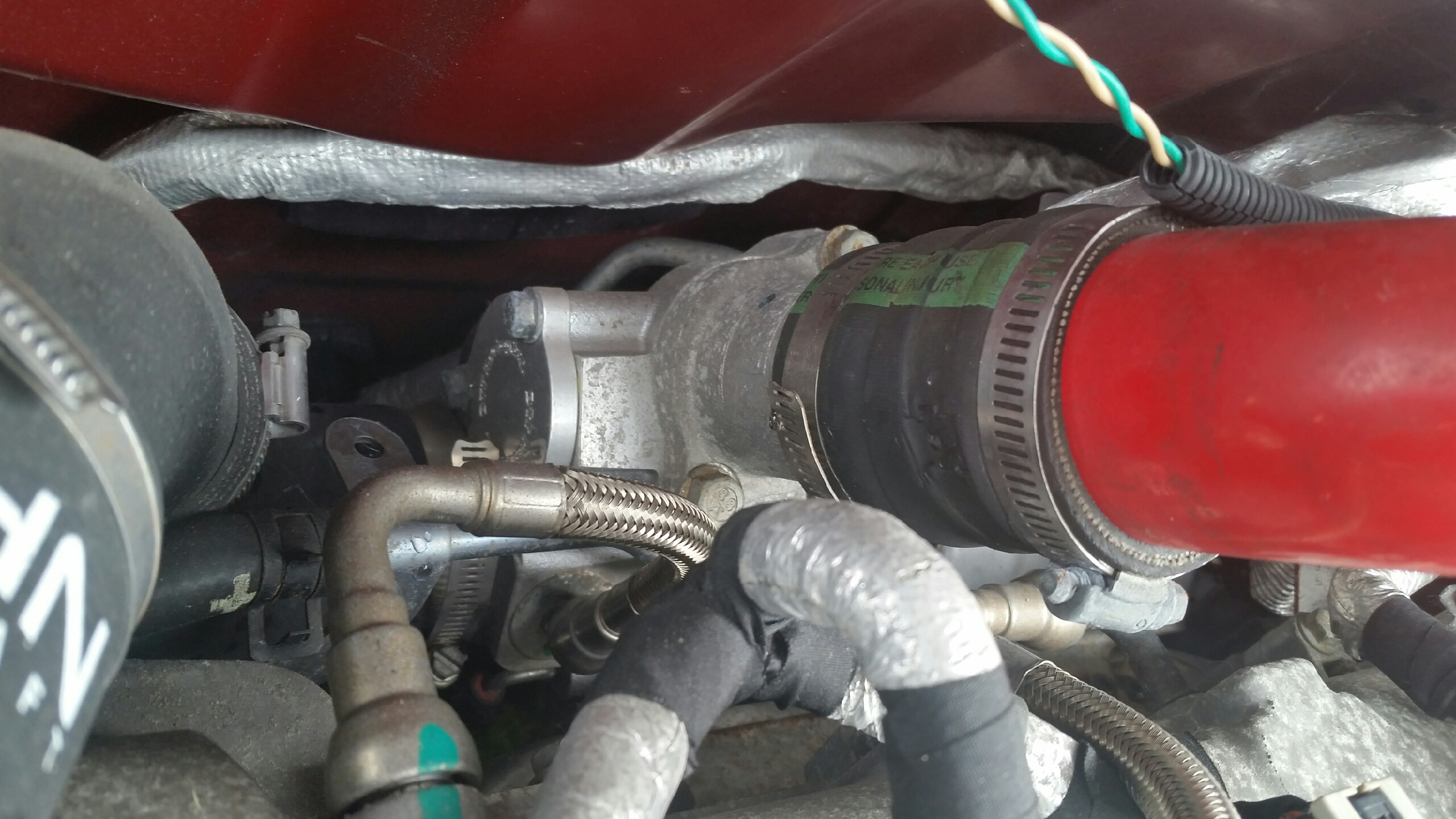

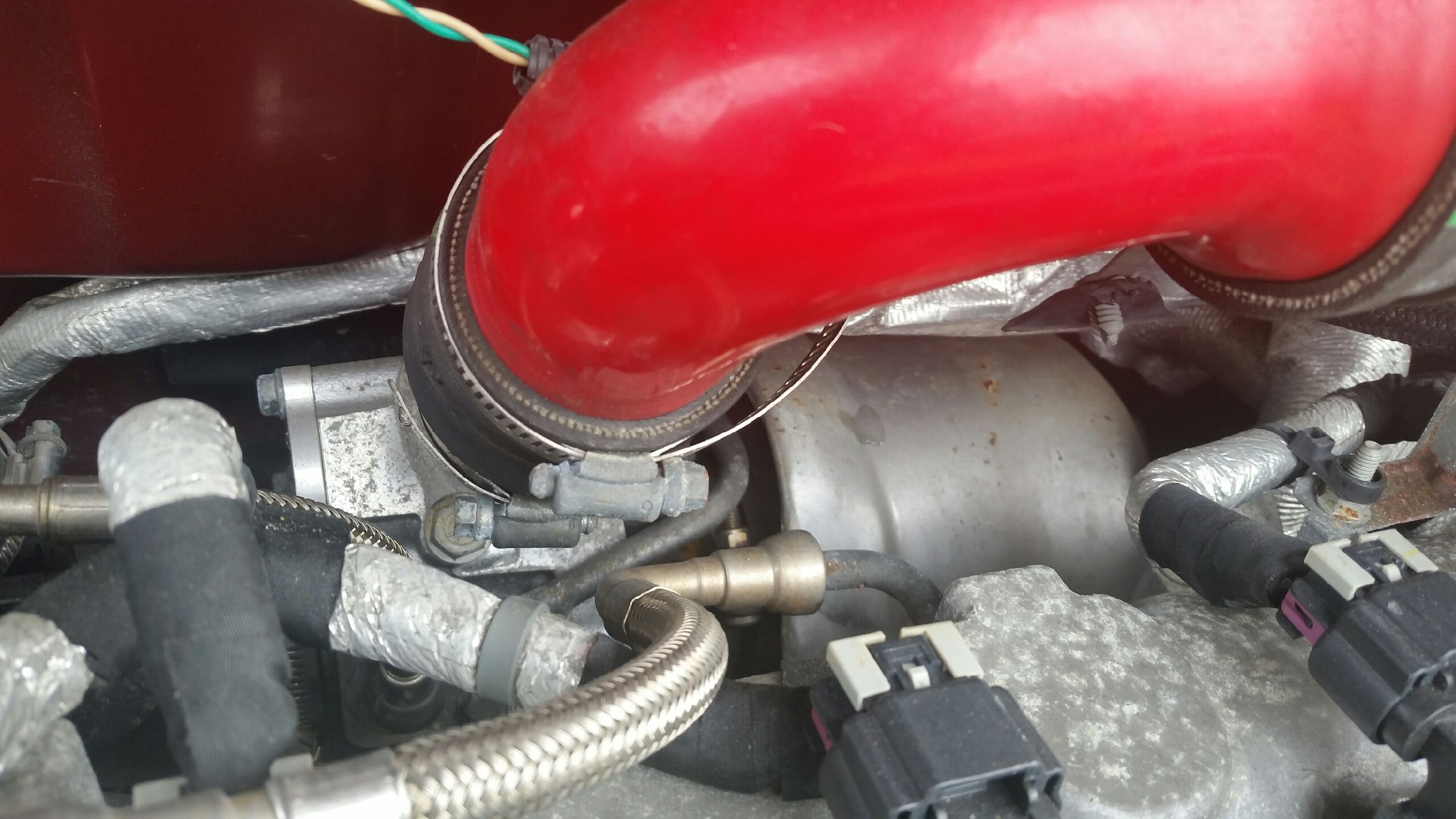

pics of my turbo to help ID it.
Does anyone know what turbo this is?

Hard to tell but looks stock to me
Old Jun 11, 2018 | 08:06 PM
I second this assessment

Do yourself a favor and get rid of those way too big worm style clamps and get T bolts on that charge piping. Factory intercooler?

Aftermarket Bpv on turbo or a block off for a Bov on charge pipe

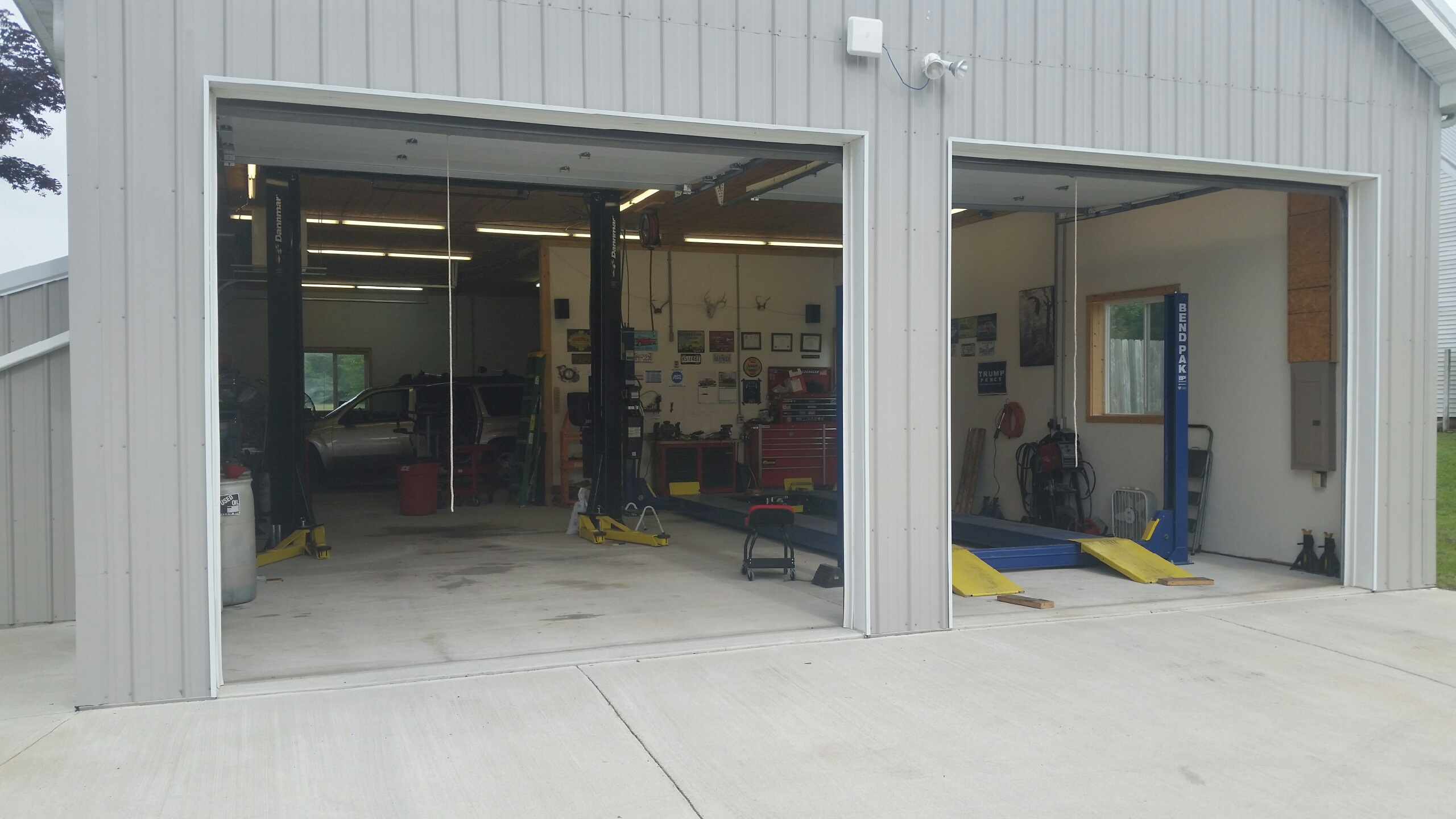

Any opinions on the ZZP South Bend Stage 4 clutch? I bought that one based on ZZP recommendation and I added the Fidanza flywheel. It just arrived and hopefully by the end of the week I'll have time to put it in. It's been a busy month and no free time. How long should it take a 1st timer, Not my first clutch (I've done many over the years) but my first Cobalt and first time dropping a sub frame. Is a day enough time? I have a lift and screw jack to support the engine. Is it possible to bleed the clutch from the bleed screw with a rubber hose in a jar of DOT 3?
