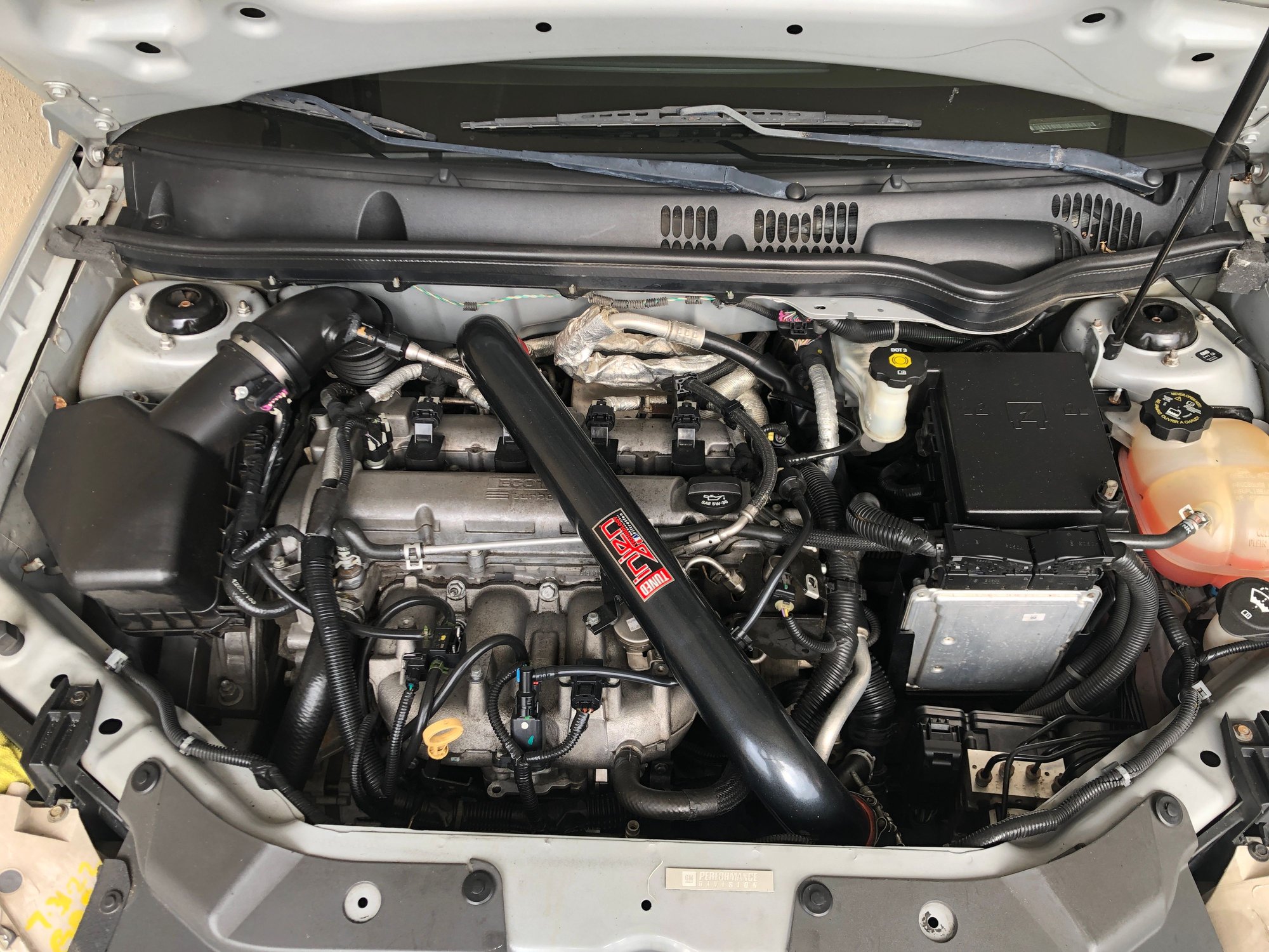

Pictures below. Better too big than too small right? Can someone help me identify:
-Intercooler, this looks like the stock piece
-MAP sensor(s), are the stock? Or GMS1?
-What is the plate on the bottom of the intercooler?
-Is there a way to tell if the PCM is factory or tuned from the outside?
Engine bay birds eye

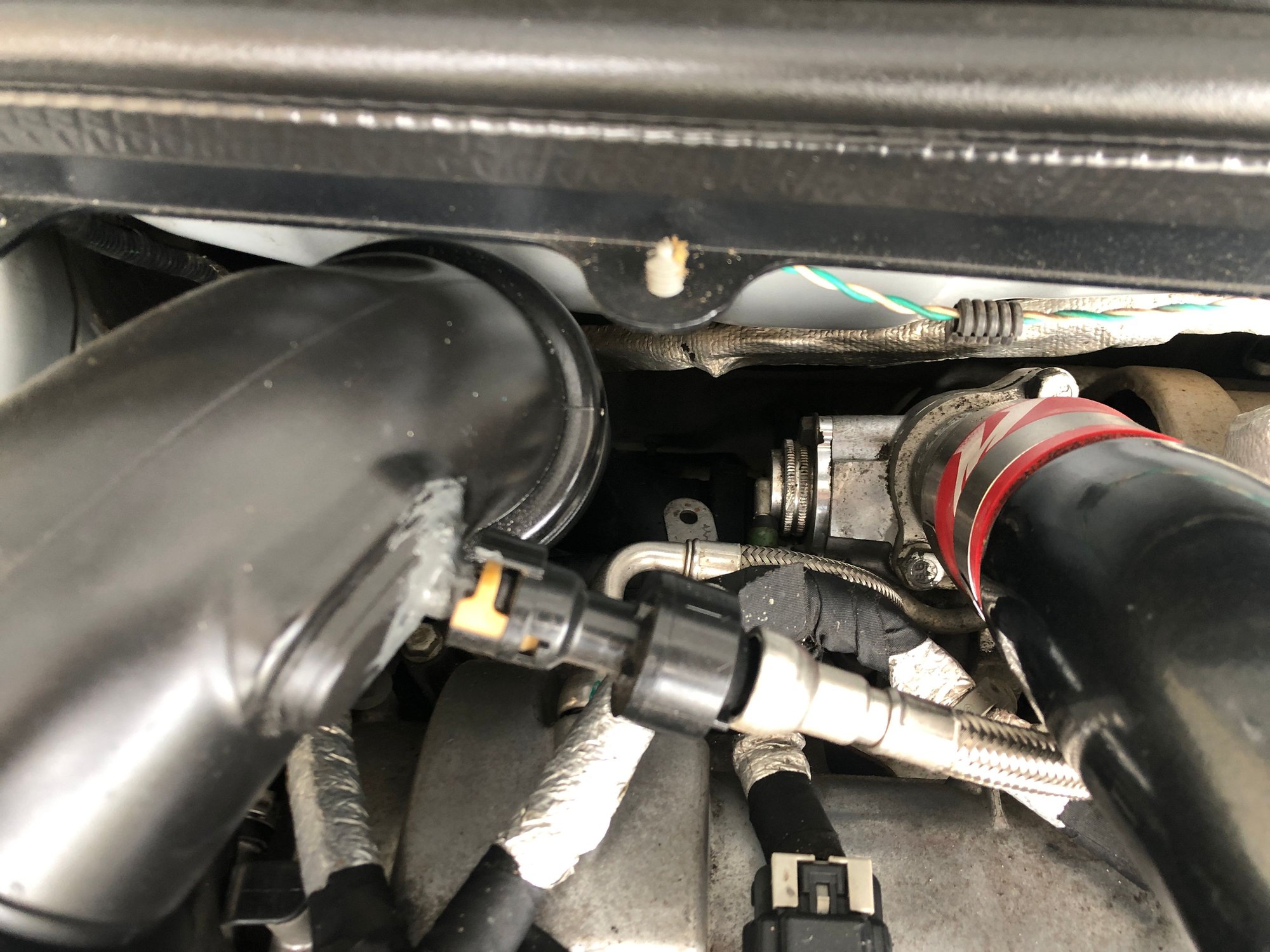

Can someone confirm to me that I am looking at the factory MAP sensor and NOT the GM stage one option?
Just noticed this lovely JB Weld repair to the (I believe) PCV system. Turbo looks relatively clean.
This is a stock intercooler, correct?
This is the driver-side intercooler end tank and a little bit of the pipe coupling. That coupling is pretty oily and is dripping some. What is that plate this is zip-tied on the bottom (it is bolted on the other end)
Overall the car looks nice (not the greatest photo but my kid was asleep and his bedroom is right behind that rear wall and this thing is pretty loud. Also I can't push the car back in if I had rolled it out)
Old Nov 2, 2022 | 11:24 PM
The intercooler is the stock unit, but not being held up by the stock brackets, it is hanging very low. I might have a spare set in storage.
At least the map sensor in the intake manifold is the stock 2.5bar sensor.
No way to tell if the ECU is tuned from the outside, you need software to determine if it is. Trifecta will have the ECU locked down, vs most HPTuner tunes it will be available.
Also things to note, you have a forge bypass valve and it will need some semi regular maintenance to keep it functioning well. You also should look at replacing the elbow from the intake box to the turbo, the JB Weld on the PCV nipple is not a good thing. A vacuum leak at that point can cause all kinds of trouble since it is post MAF sensor.
The final note is the car really needs a boost leak test, given the look of the intercooler I'd be surprised if it isn't leaking.

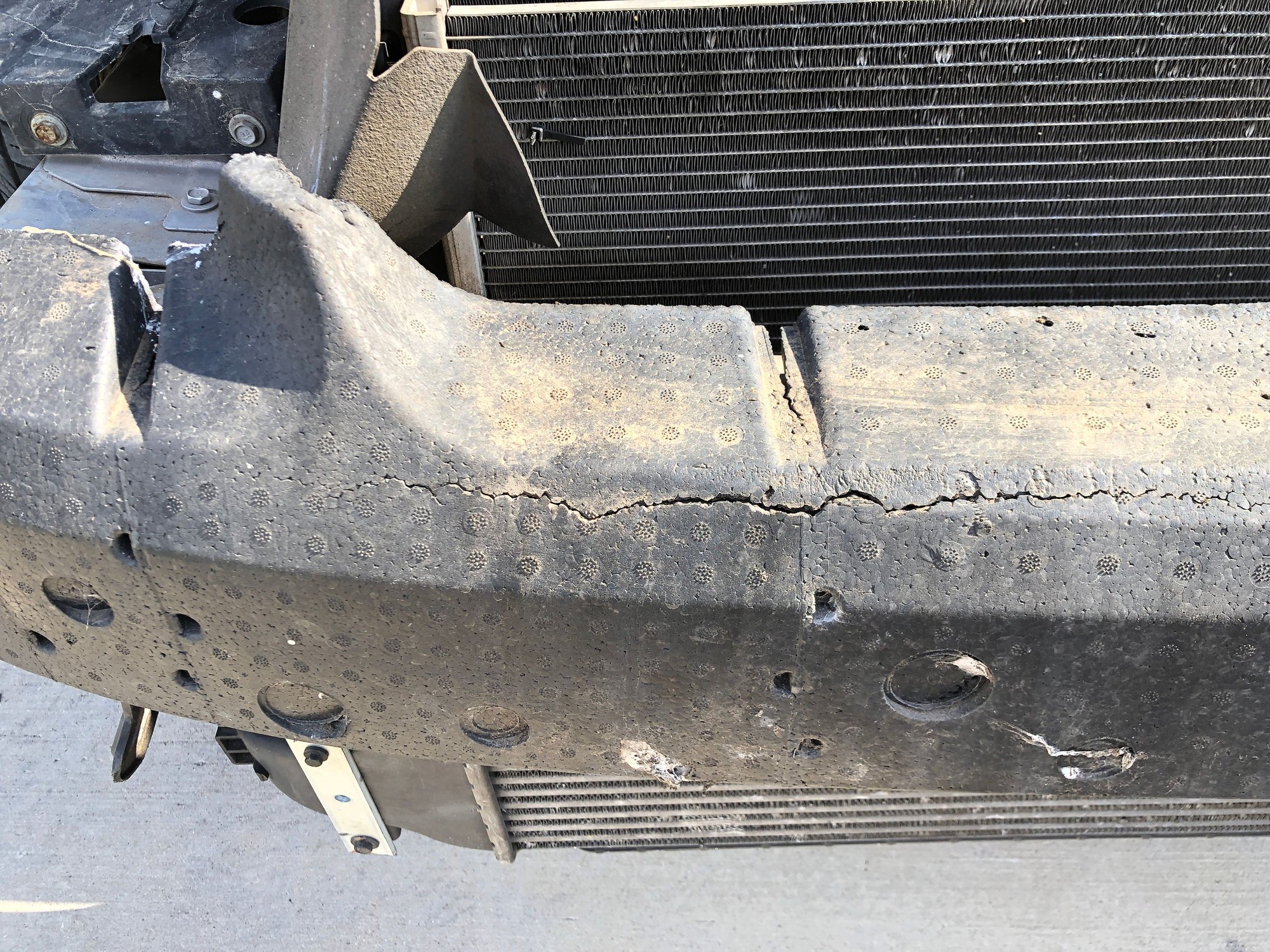

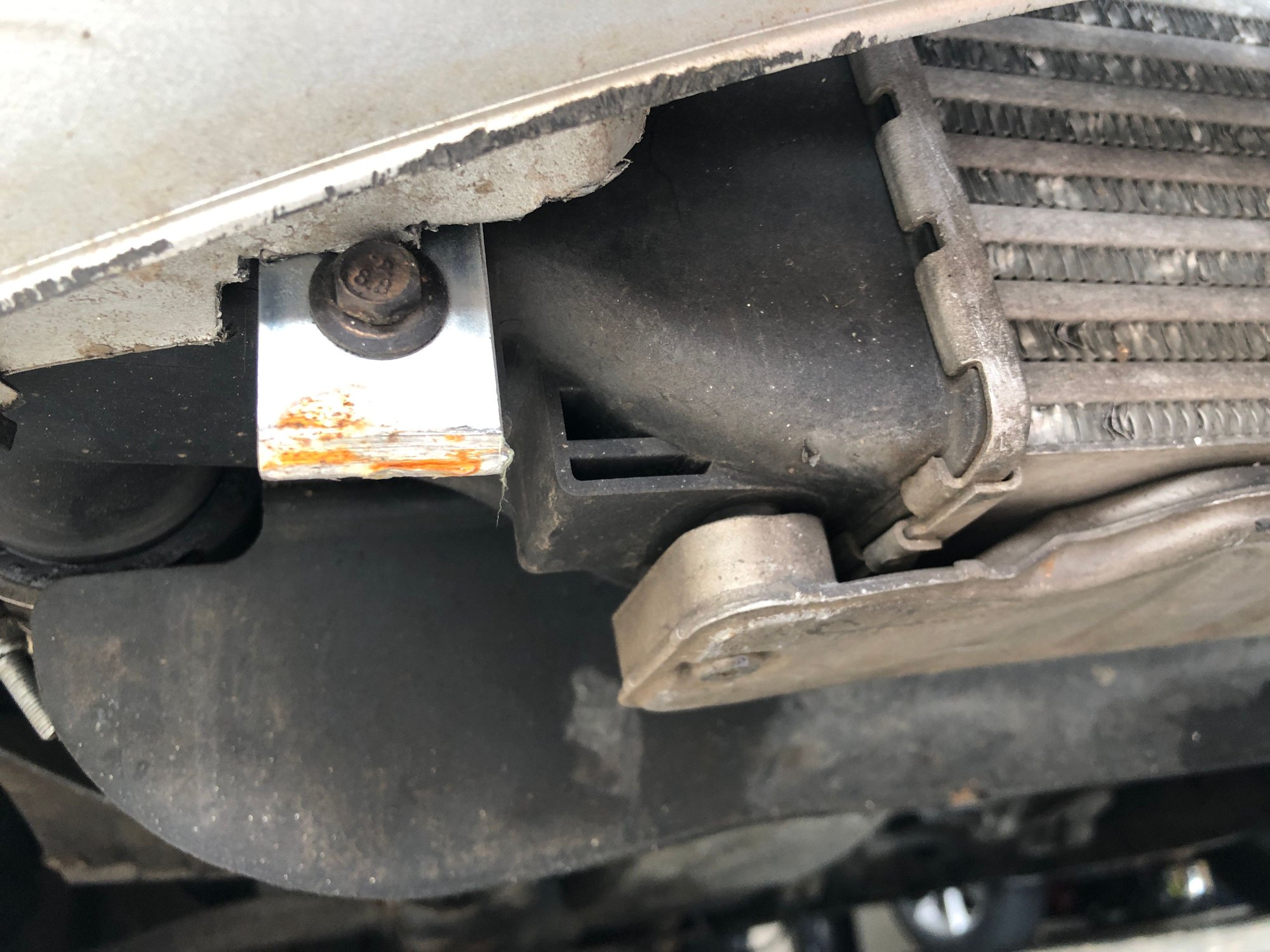

It is confirmed. The car has been in at least a minor accident. I had the front bumper off doing some looking around for cracked IC parts or other boost leaks and discovered:
- crash bar is dented and bent in one spot.
- crash foam has cracks from an impact
- passenger side crash bar mount is crushed slightly
- radiator mounting brackets are 'wonky'

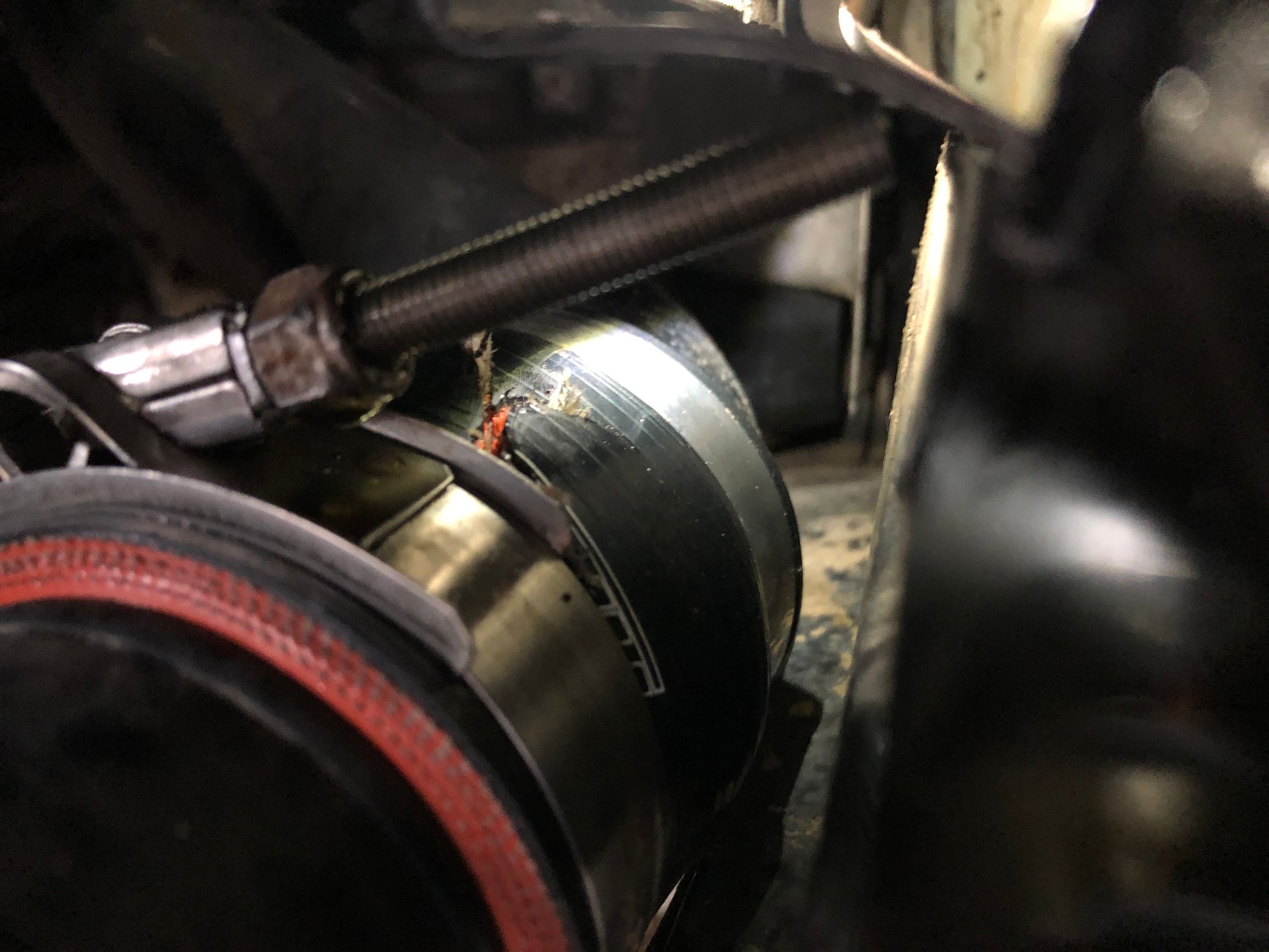

At least I was able to discover and fix the boost leak (until another one developed that has yet to be found) and fixed the low-hanging IC problem. And everything fits relatively nicely back together as far as bumper and headlights go.
Whoever did the last work on this car wasn't just bad, but savage. Mismatched bolt sizes, stripped clamps, nasty homemade brackets. It is a miracle the car functions as well as it does (fingers crossed it continues to be basically reliable).
The next major fixes will be to track down this other boost leak that has appeared and get the smoke out of the exhaust fixed.
Busted bumper foam
Passenger side crash bar
So much for a clean Carfax hahaha
Pretty good sized tear in the hot side IC coupler
