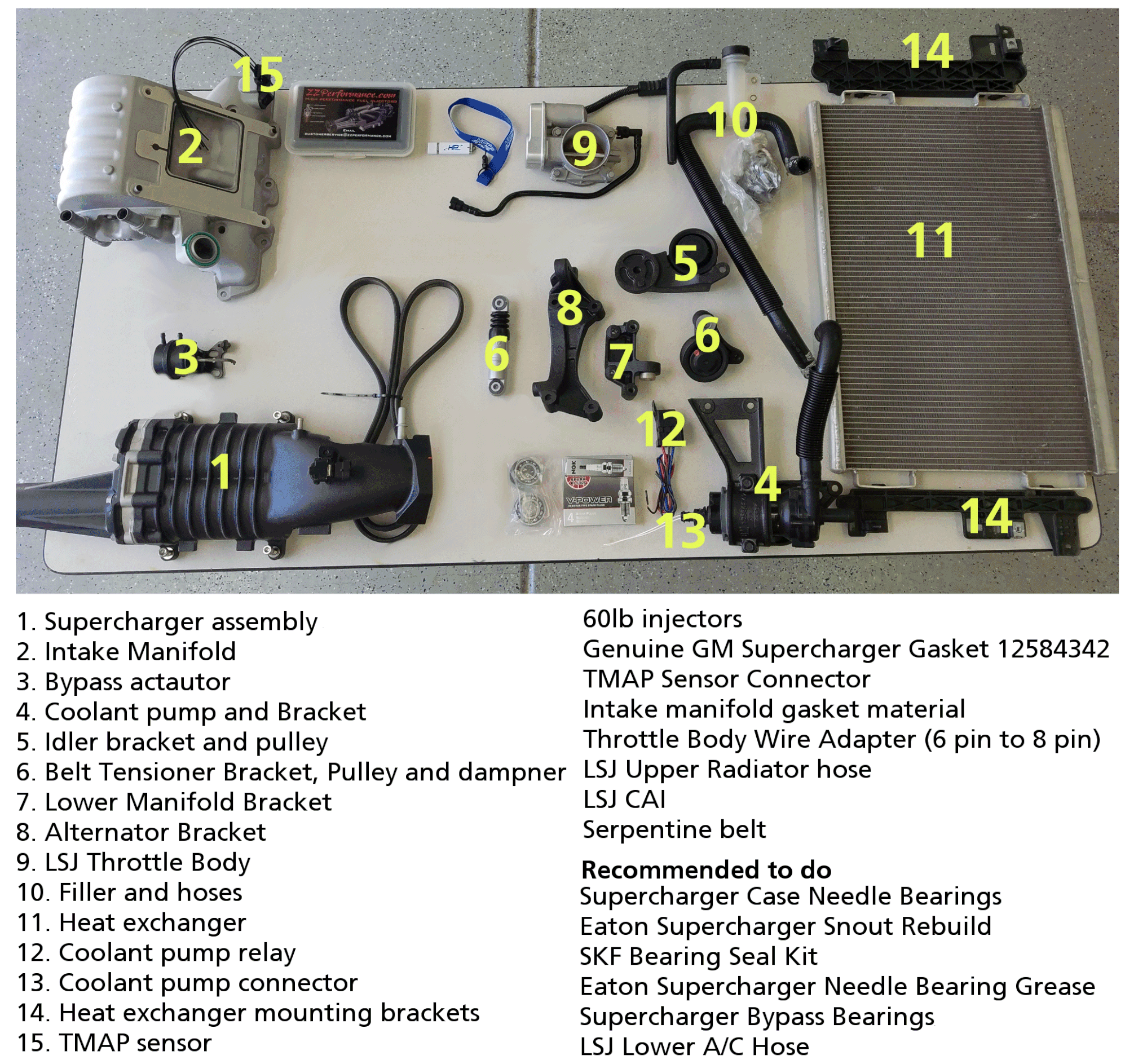

Auto is a perfectly fine trans. Has been proven to hold up to high torque. Eco724 already owns the car so IMO definitely worth adding a supercharger. If wanted to you can source the parts used and/or do the install yourself you can really do it on a budget.
what are exactly all the parts that I would need? I have a friend that could do it, just don’t know all of the components.
I could send you an entire list + what it would cost to include rebuilding components for the used supercharger etc.
Your looking at $1500.00 or so to start.
I wouldn't mind this. I already have the m62 with the 3.1 and the manifold. Just need everything else... And a place to actually do the work.
That would be great honestly! Knowing everything every little bit would be great
Try to get as many of the numbered items from Jeffrey Reiland (mongorat427) forum member.
Not listed are nuts and bolts, mainly the smaller manifold bolts and longer alternator bracket bolts.
