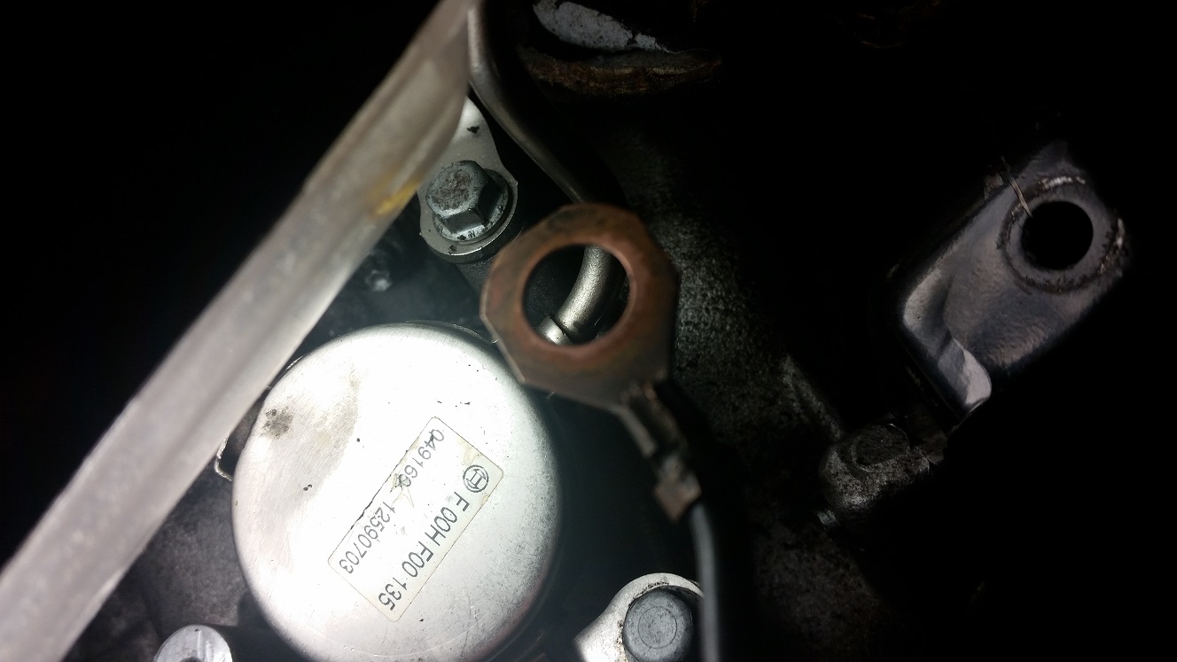

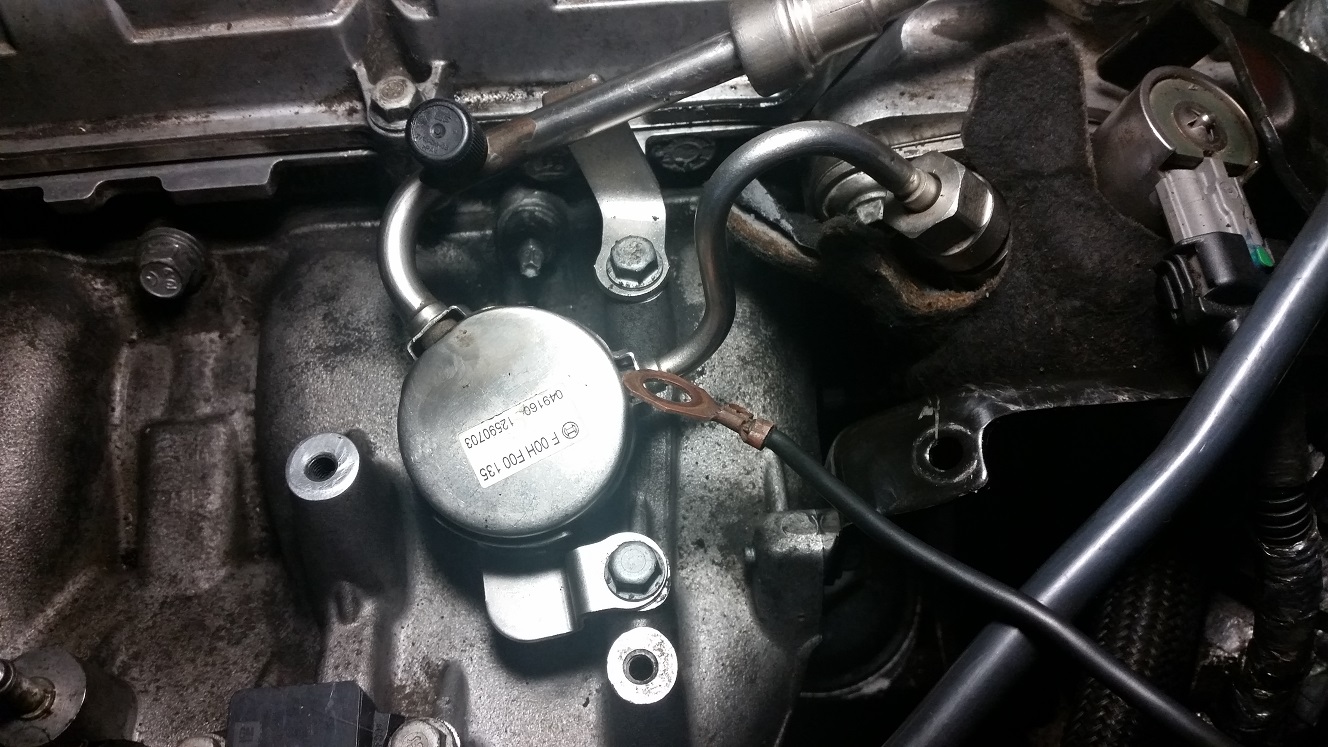

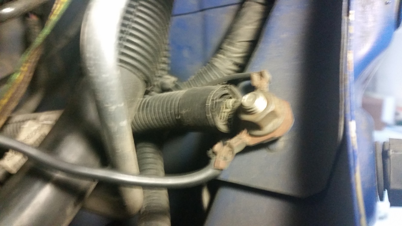

I recently purchased a HHR SS. I am in the process of replacing the head gasket. Almost done but I have a ground wire that lost the tag I marked it with and I don't know where it should hook up to. It is in the area of the high pressure fuel pump. It could connect under the intake manifold as well.
The end of the wire connects to other ground wires in the front driver's side of the engine compartment.
BTW - tons of great information on this forum - I have gained knowledge from many posts.
I attached 3 photos showing the connections
1. showing a closeup of the connection I need to find a home for.
2. showing where the wire connects
3. the general location of the wire

Old Mar 13, 2018 | 11:41 AM
pearljamfan's Avatar
Joined: 03-12-18
Posts: 10
From: Baldwin, WI
Originally Posted by Kolt
there is four grounds, looking to see if there is anymore, one under the alternator and another under the oil cooler on the trans. the two top right is by the fuse block
This image is perfect
My lost connection is #3
Many thanks
