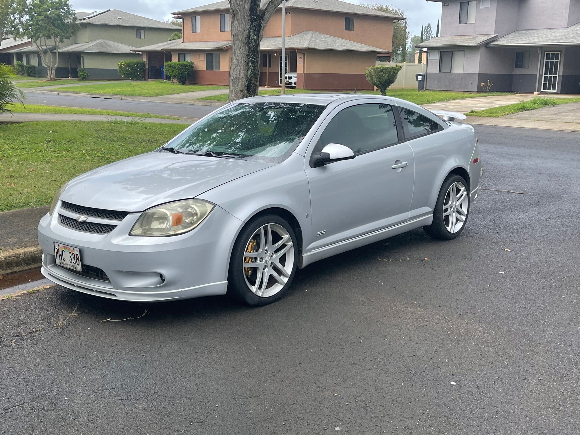

Finally got my hands on one of my teenage dream cars, 2008 Cobalt SS TC. If anyone has any tips/a remote tuner they recommend I’d highly appreciate it.
I knew the car was gonna be a bit of work when I go bought it (had 3 BOV’s and a VTA diverter and rough idle)
I bought it, replaced the charge pipe with a solid tube pipe to remove the BOVs. Rewired the GMS sensors because they were wired incorrectly, cleaned the MAF sensor, checked the purge valve, etc, but car still runs extremely choppy. When I disconnect the MAF, it idles not correctly, but a whole lot better.
The cobalt has a K&N CAI, Hahn intercooler w/ piping, a Ktekt steering system, short throw shifter, and only 63k on the clock. Wondering if anyone has a remote tuner that could supply me with a solid tune to fix what’s going on. Ordering a forge diverter valve this week, and have the correct o rings on the way (lower tmap has a green o ring on it). Any help is appreciated. Currently throwing CEL P0326.
