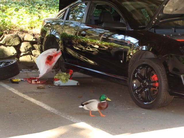

Ducks tryin to help me work on the car last week... lmao
