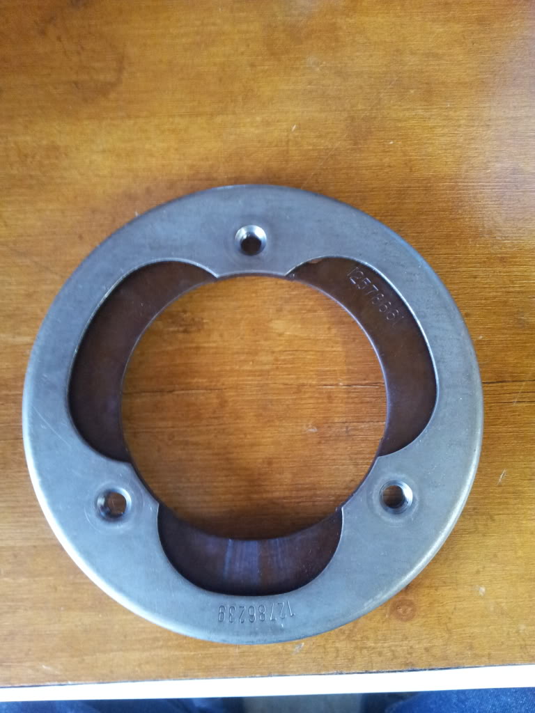

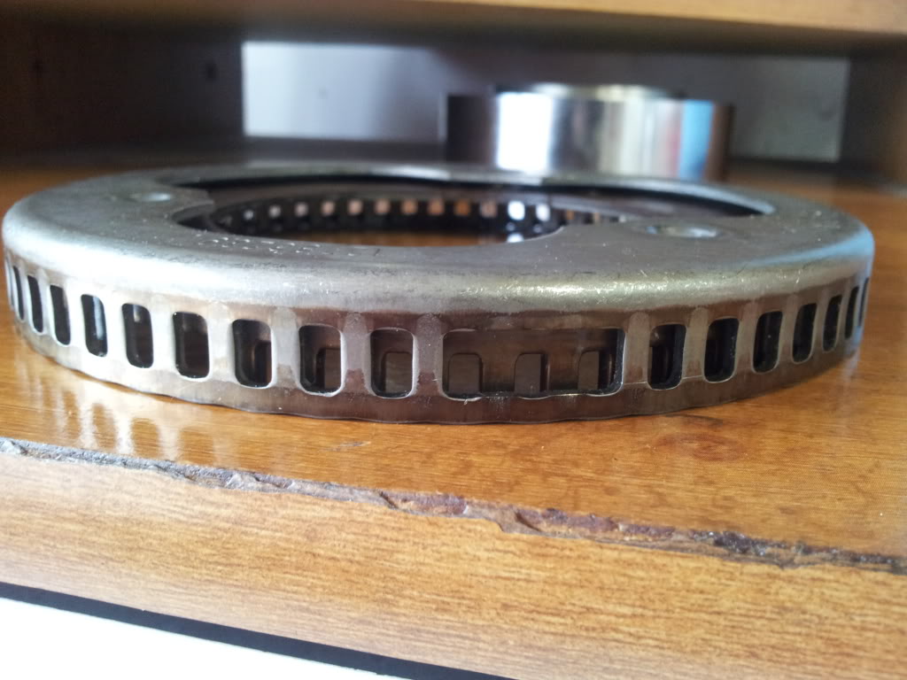

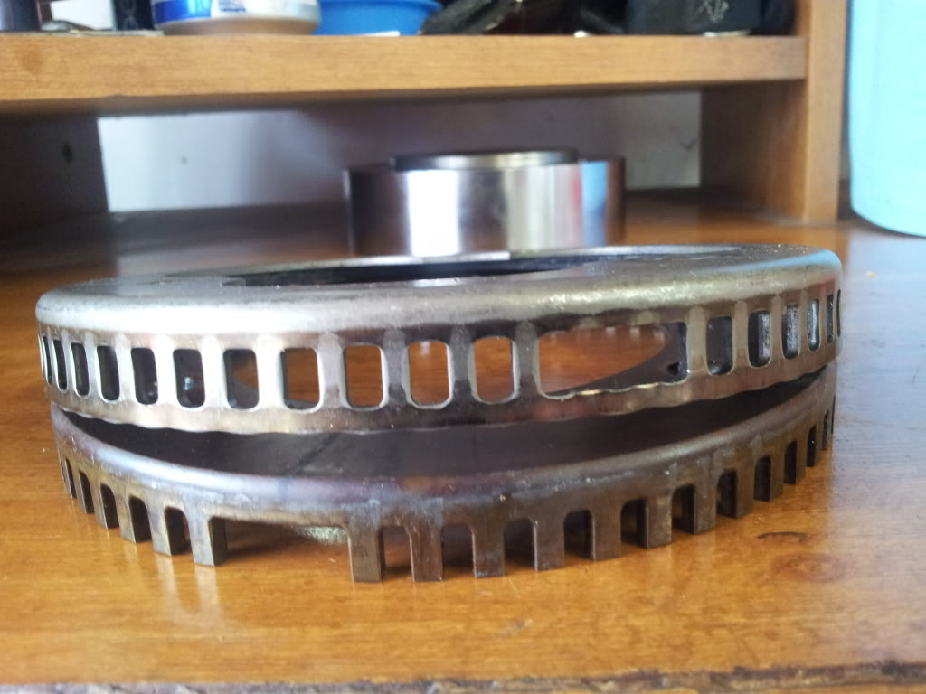

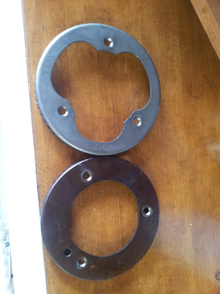

Tjolley's Avatar
Joined: 02-01-11
Posts: 2,799
From: modesto
The lsj and le5 r different.
