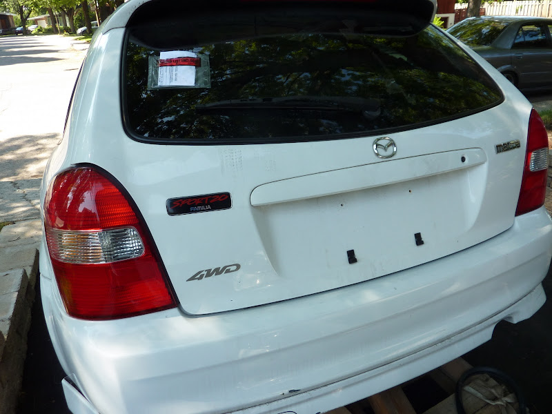

Swapped the ADM for the EDM/JDM Hatchback Tail Lights.
They are very visible and I love how they look..
ORIGINAL
UPDATED
Here is a $ LOONIE on the Stock Bumper and the JDM Bumper. It is 6" Shorter at least. I can
t wait to see it on the car.
Original
6" Shorter

- Body: Paint Front and Rear Bumpers from a JDM SPORT-20 and Install. Remove Stickers from running boards and repaint. Repaint Both A-Pillars.
- Exhaust: Reposition APEX-i N1 6" shorter due to the JDM bumper being 6" shorter.
