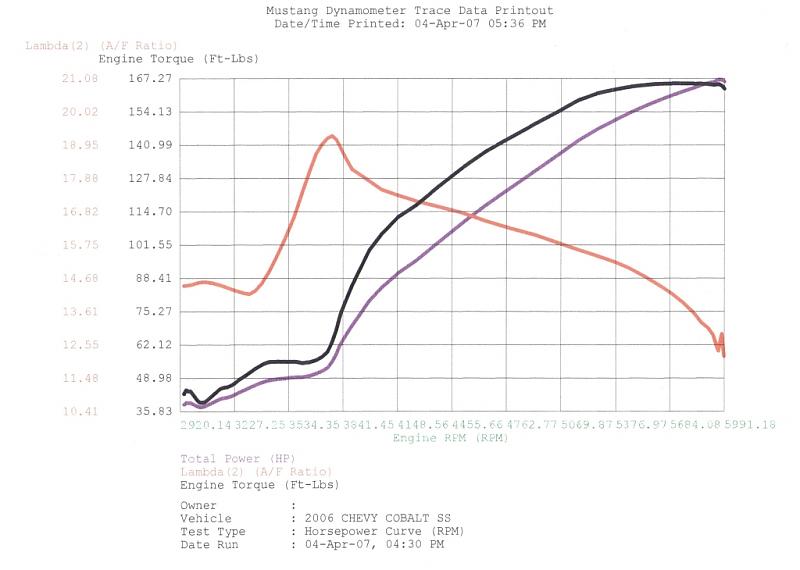

Ok here's the graph from the dyno showing the lean spike...
Keep in mind, this wasn't a normal dyno run. This was just the tuner getting on the gas to see how the car handled boost.

lean spike? that was lean the whole time. damn... but by good luck I didn't mean anything bad by it, but it's gonna be a bitch..... but def see if you can get a tune off someone with a turbo solstice... even though I know hahn locks the PCM's

Spike was a bad word choice.... it jumps up... but gradually comes down. It's way lean... no doubt about it. The guy tuning it said the PE table was way high... so it should be rich from what he said. I don't know though... he didn't give me a good look at the tables he was working with.

probably gonna have to mess with the few VE tables since you basically upped the volumetric efficency over 100% now with boost. thats gonna be the fun part... and that being off will definitely throw off the PE table like that

VE tables are 5-dimensional. There's no tuning those just yet... not until we have access through HPT or LS2Edit to at least log or lock cam angles with VVT on this motor.
