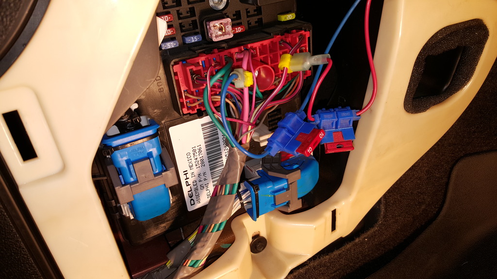

Fixed it. I suspect an aftermarket moonroof is in the car. It shakes and has a mesh shade, these wires run up the passenger side A-pillar towards the moonroof.. Anyway in the console fuse panel section I discovered a wire tap with two 10amp fuses. Moving it around caused the computer to come on and off. So I chalked it up to a poor install. I secured the connection pin and taped it to the wire loom so it does not flex around again.
