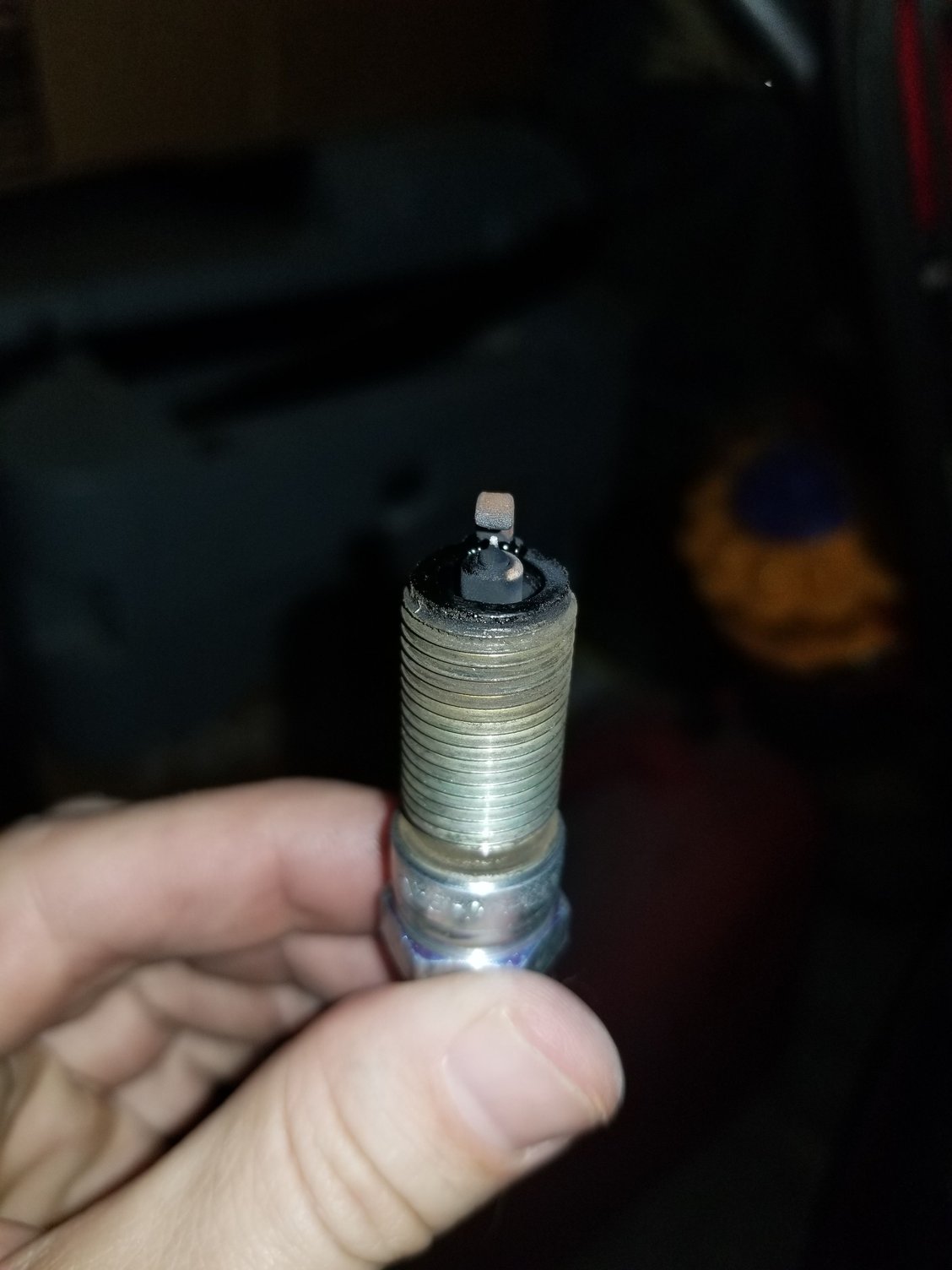

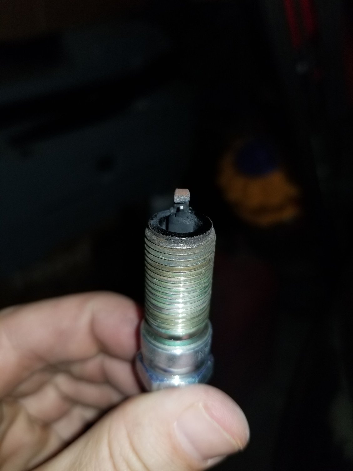

Lastly, could I get some input on the spark plugs? I pulled them and took some pics. I'll post them in order from left to right.
#1 - looks consistent with what you see in the photo, a little gooey black carbon buildup on right side.
#2 - light brown on one side of insulator, gooey black carbon buildup on the left side.
#3 - looks the best to me.
#4 - like 2, it's brown on one side. But otherwise looks good. All plugs seem to have the gooey carbon buildup around the bottom of that last thread.
Thank you all!
