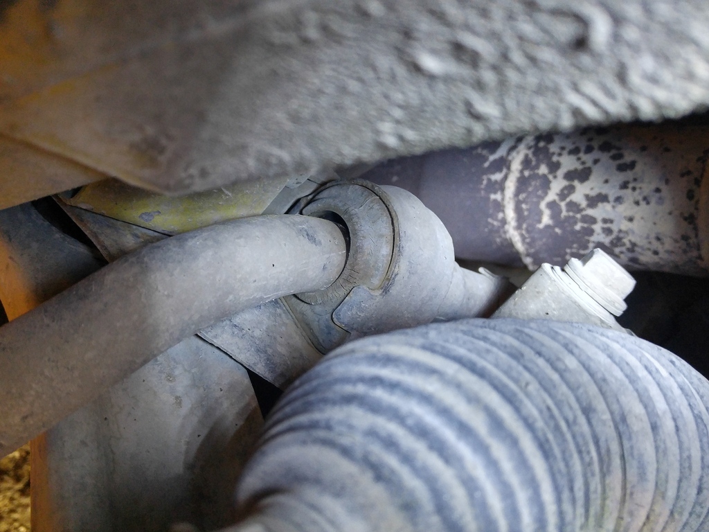

I grabbed the swaybar by the bushings and shook it as hard as I could and I didn't hear any noise or feel any play. I also smacked the entire swaybar with a rubber mallet and everything felt solid, but who knows.
If the I-Shaft doesn't fix it, which it probably won't knowing my luck, I'll replace the swaybar bushings as I think they are relatively cheap.
Thanks,
Chris
By hand my sway bar felt fine but when i looked at the bushing i saw this. I ordered new prothane ones off Jegs for 10.99.
http://s1211.photobucket.com/user/mm...qxv5.jpg.html][/URL
Visually they look OK, nothing like yours.
