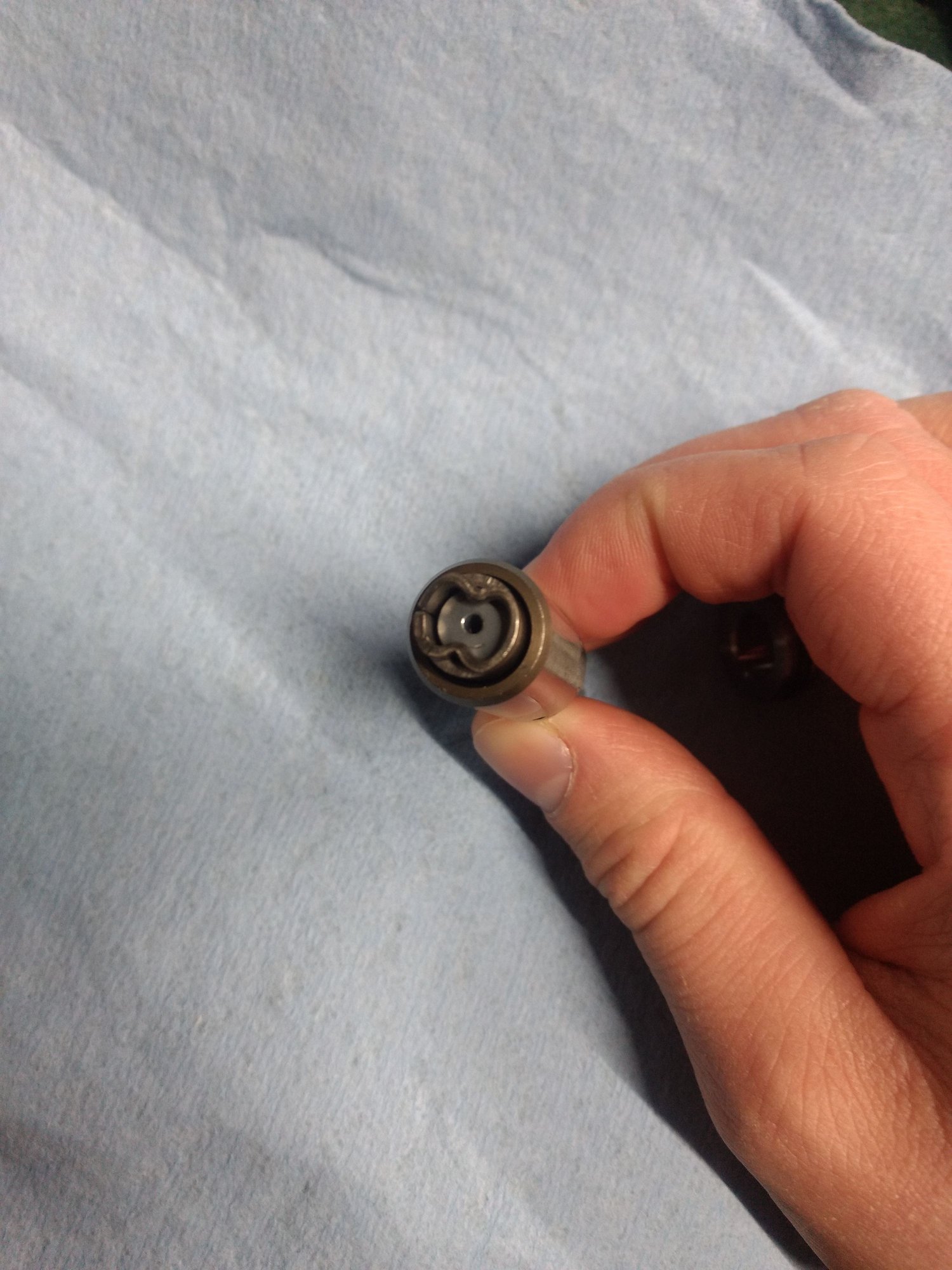

WELL!
My tensioner does not have a spring .... There is no notches or anything .... No possible way to make this thing set or move or whatever .... It's just a thing .... That slides out when oil pressure gets behind it ....
I guess .... I tried to move the little crimped piece on the end and it doesn't do jack ....
As you can see in the last photo, the body of the barrel has no notches or anything .... Just smooth with ports at the bottom for oil pressure.

The spring should be inside that body. That video is good.

Likes: 10
From: canada
On your second picture, the spring is inside that. Push down on it with a flathead and turn it either way until it pops out lol. This must be a winter project or something because I would've given up already if I was you

Originally Posted by steelmesh
Danke this explains a lot.
I'm a newb .... I gather it's set now. Just needs installing .... And according to Powell it self sets.
Yup .... Definitely helps.
Now to make this shiz work.
Yup!! 👍👍
