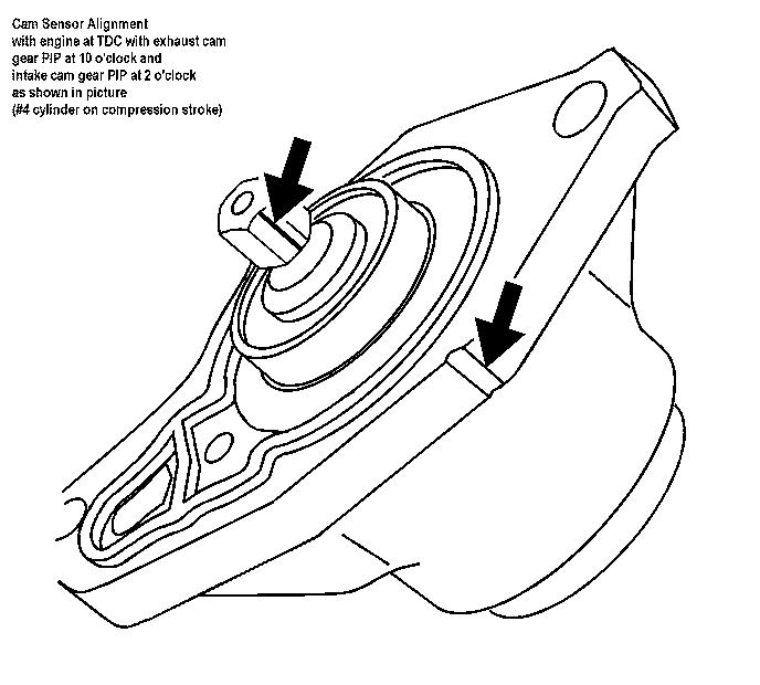

R u sure u dont have the cams swapped around?
Also wat cylinder did u put at tdc?
Also its just not any tdc has to be the compression stroke on number 4

The cam sensor has to be lined up on number 4 compression stroke.
If u lined it up off number 1 ur 180* off

I thought the book said #1 cinder compression stroke
how to time the cam sensor housing

So I should retime it off cylinder 4 then adjust cam sensor?

I see you're new here, but the guys who are giving you advice in this thread are old heads. Take their word as gospel. Just do the re-time.
