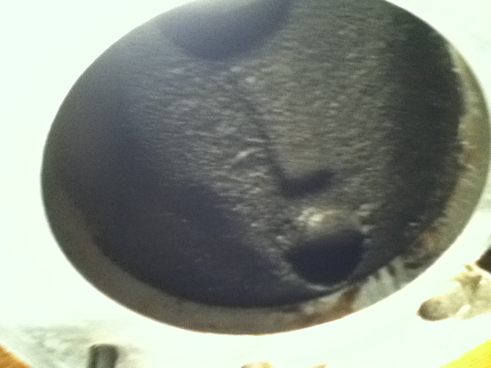

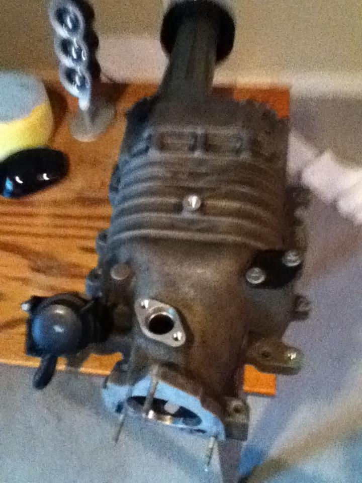

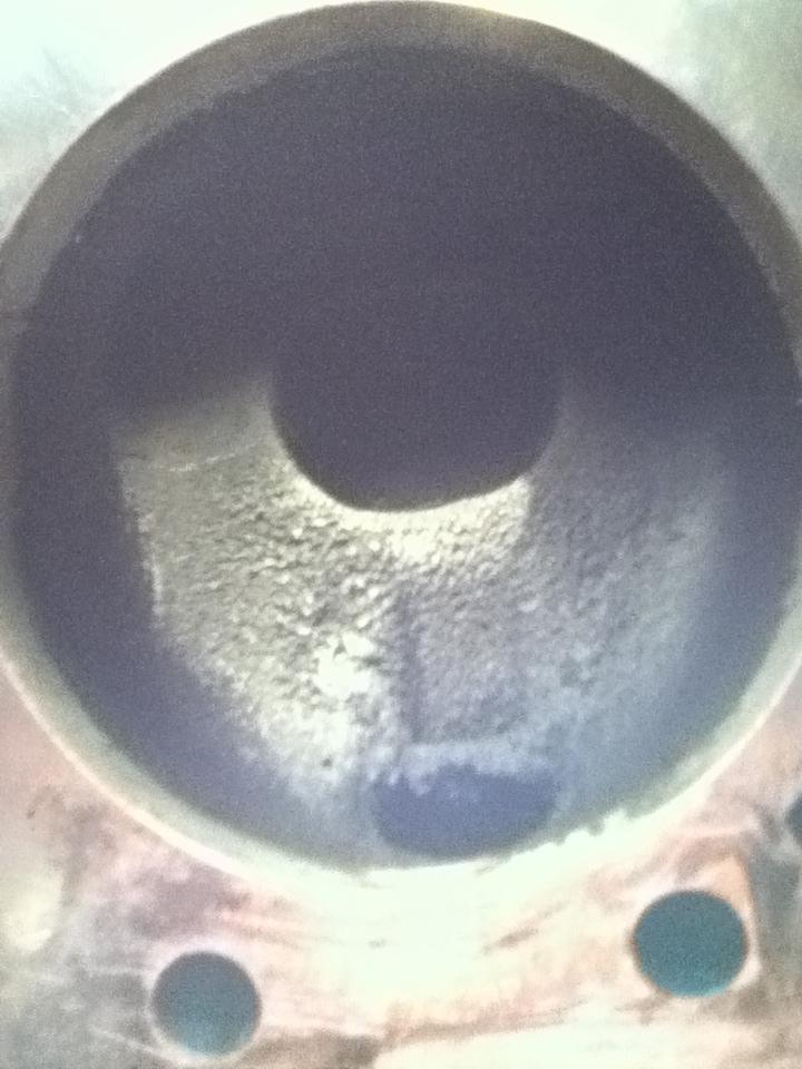

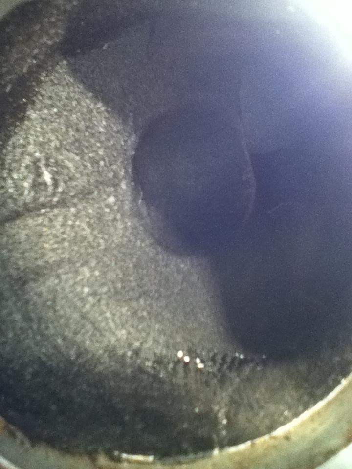

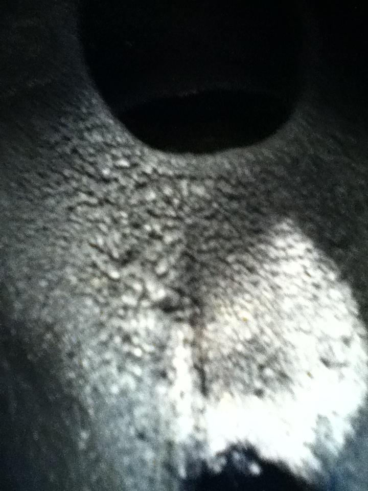

oil in m90 supercharger
so how bad is that? i am cleaning it now but it wasn't on my car so i have no clue how something like that happens. just need info so it doesn't happen to me.Name:  image4_zpse72b4ad7.jpeg

I'd be more concerned if it didn't have any oil. Superchargers are required to have oil to lubricate them.

It's normal.... It's due to the pcv system venting oil vapors into the intake tract.

Not in the locations his picture show
