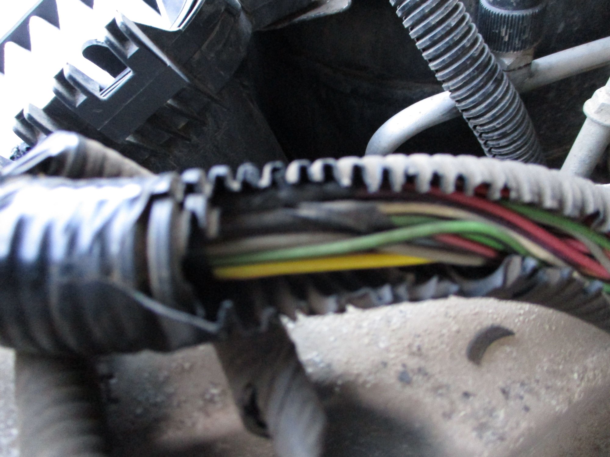

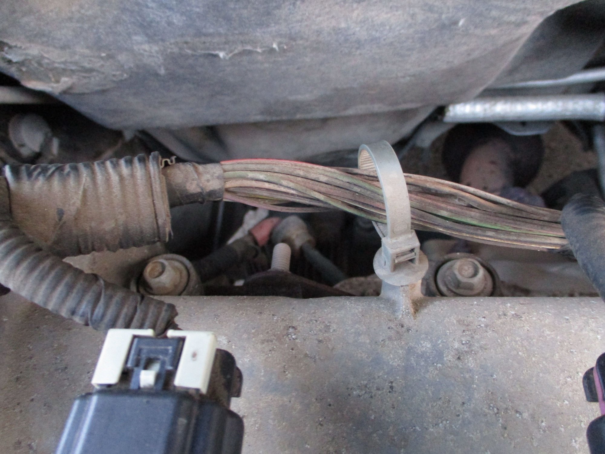

Hey so a quick update, I went out with the code reader and did NOT start the car, I turned the ignition to 'on' and connected the device. No codes popped up. The yellow check engine light, however, was still on. Because I saw no codes on the code reader I decided to start it up and voila! Yellow check engine light was gone. Decided to take it for a spin for about a mile and there still wasn't any codes. Came home, turned the car off, took the code reader inside and decided to go for another spin. Unfortunately, the check engine light came on again after about maybe a mile or two of driving. This time, I managed to snag a picture of exactly what the code reader said, I'm going to upload a photo. I'm going to presume it has something to do with the wiring, I'll going to upload a few photos of what the wiring looks like underneath the hood (it looks pretty nasty) If it is the wiring that is faulty, how much does it cost for the repair usually? And can it be done by an amateur such as myself?

If your scan tool can monitor the output frequency of the MAF sensor, you could watch the signal and see if it randomly drops (I think below 300Hz or so) or isn't reading proportional to airflow, clear the code before doing this test as it will have to fail twice to set the DTC code. Easiest thing to do is to inspect the wiring by looking for any signs of abrasion on the wire loom tubing or the wires themselves. I see electrical tape on some of the wires which could be masking a problem if it wasn't put there from the factory. You could also look for cracks/damage in the wire insulation, you would probably see corrosion or bare wire exposed. Water will draw into the wire and over time cause corrosion further away from where it gets in. Also check the MAF sensor connector for corrosion or bent pins. Good Luck!
