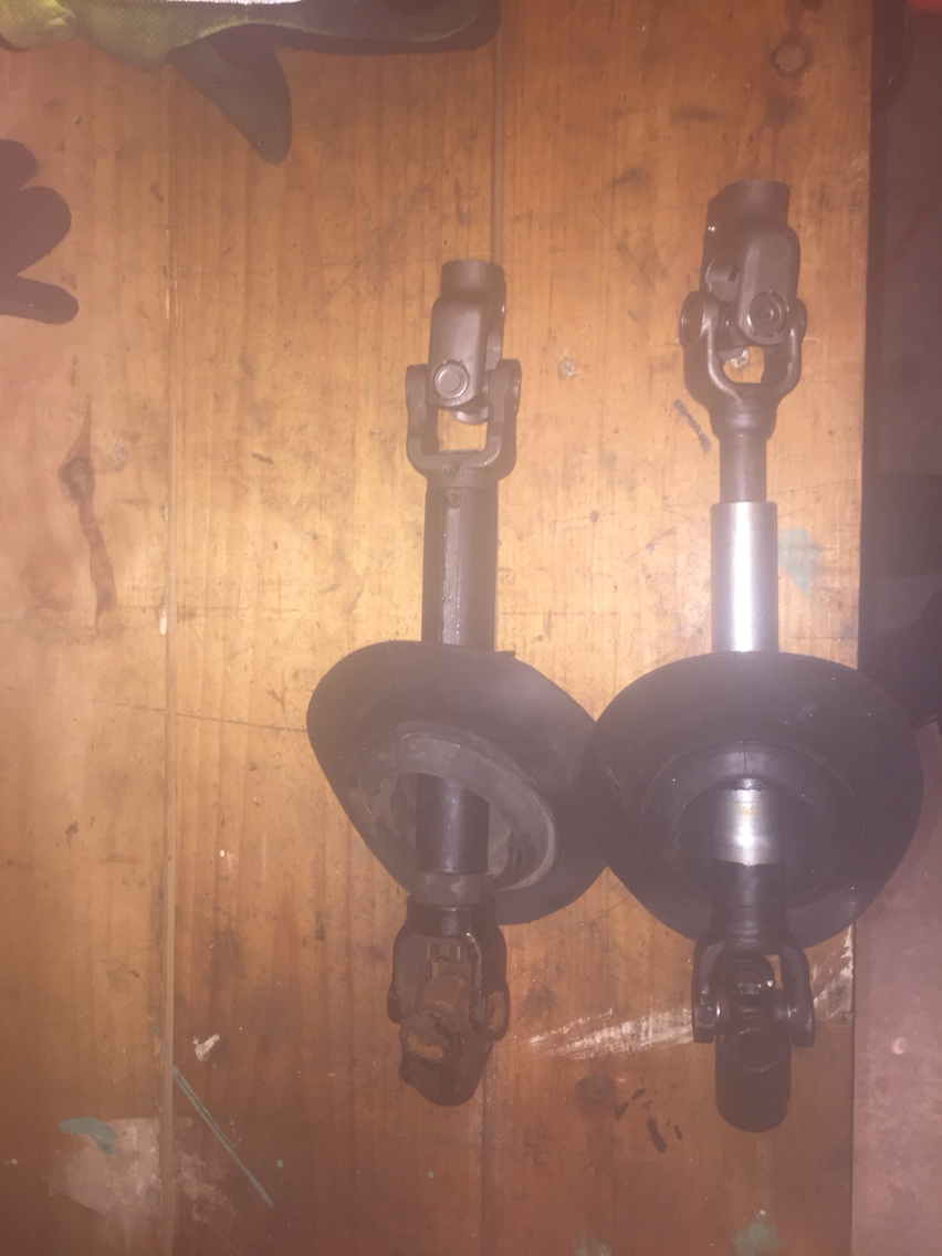

Put the old shaft back in. Rattling gone.
Noticed the new one was longer than the old one. New is GM, old is Dorman. Both shafts fully compressed.

That GM one looks way different than the GM one that I put in mine.

Dorman (old) left, GM (new) right.
I did some research, Amazon refunded me for the Dorman part (originally purchased in 2013) and I bought the GM one online in 2016. Part # 15800140.
