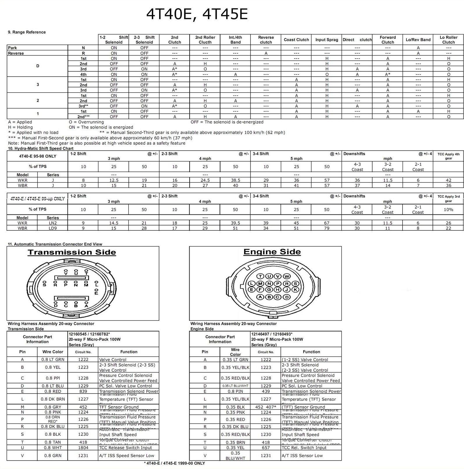

Looking for any advice where to start on tracking this electrical gremlin.
The 10A trans2 fuse blows anytime the key is turned on, unless the pigtail is disconnected from the transmission. Car will run while the plug is disconnected.
possible short to ground inside of the transmission wiring?
2007 saturn ion 2 with 2.2L ecotec vin F
Picture for connector reference only.
