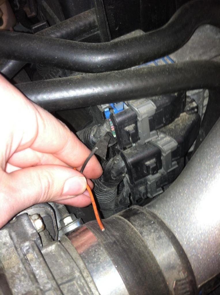

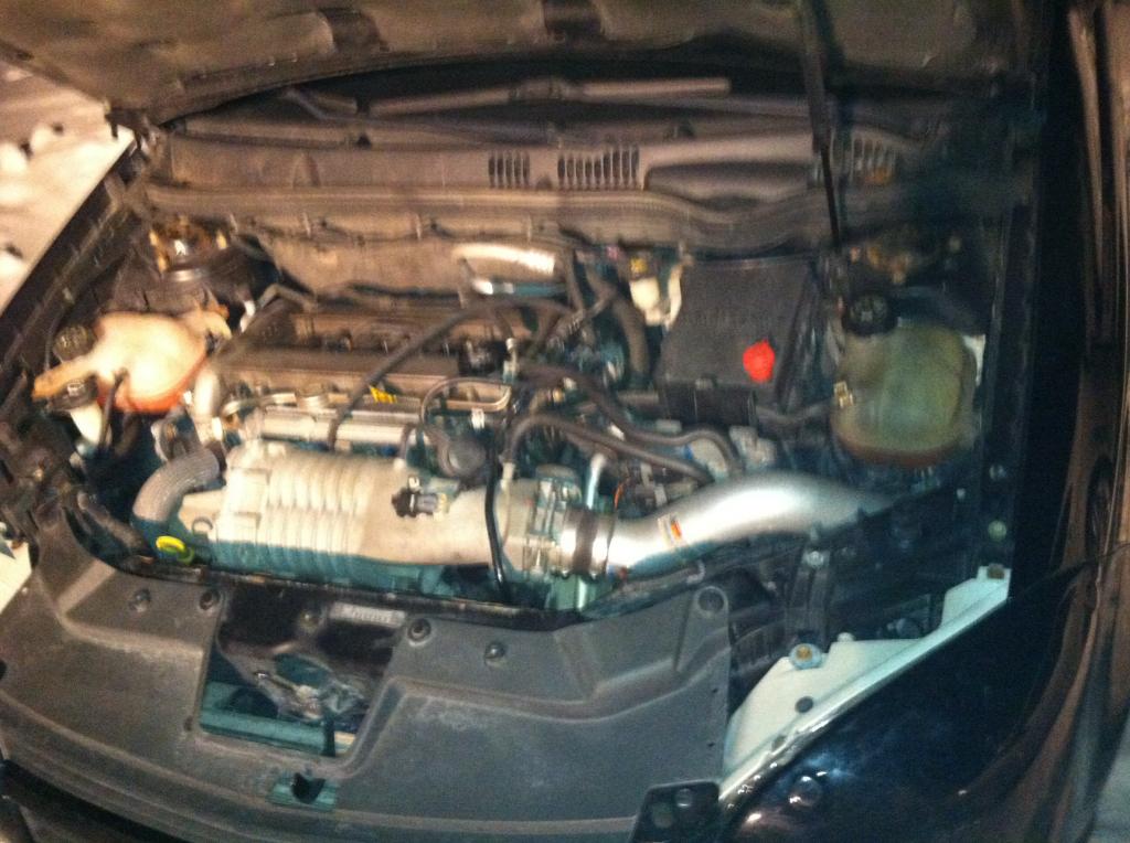

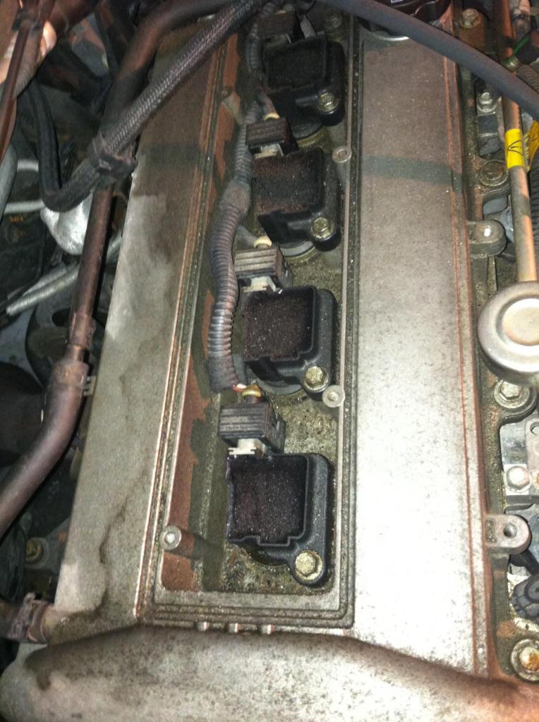

Post some pics of the engine bay, the injectors, the pulley, and said cut wires.
Old Feb 10, 2014 | 08:51 PM
Slednecks96's Avatar
Joined: 12-10-13
Posts: 31
From: New Hampshire

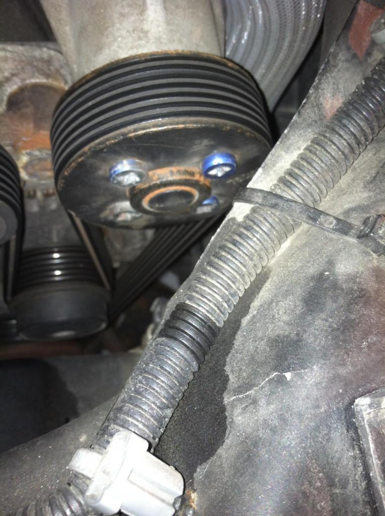

Get us a pic of the S/C pulley or read the size off of it if you can.

Old Feb 10, 2014 | 09:23 PM
Joined: 12-10-13
Posts: 31
From: New Hampshire
Looked like it said 76.00 mm Name:  image_zpsfbfec1f0.jpg
That's a gmr s3 pulley.
I'm a full gmr s3 car and have never seen boost levels anywhere near that.
Clogged cat, and colder temps are the factor for sure.
Those look like the gmr s3 nitrous jumper wires, but they arent hooked up to the PCM (OBVI).
A gmr s3 car with the M62 and full exhaust will be closer to 250whp while running 93 octane.
