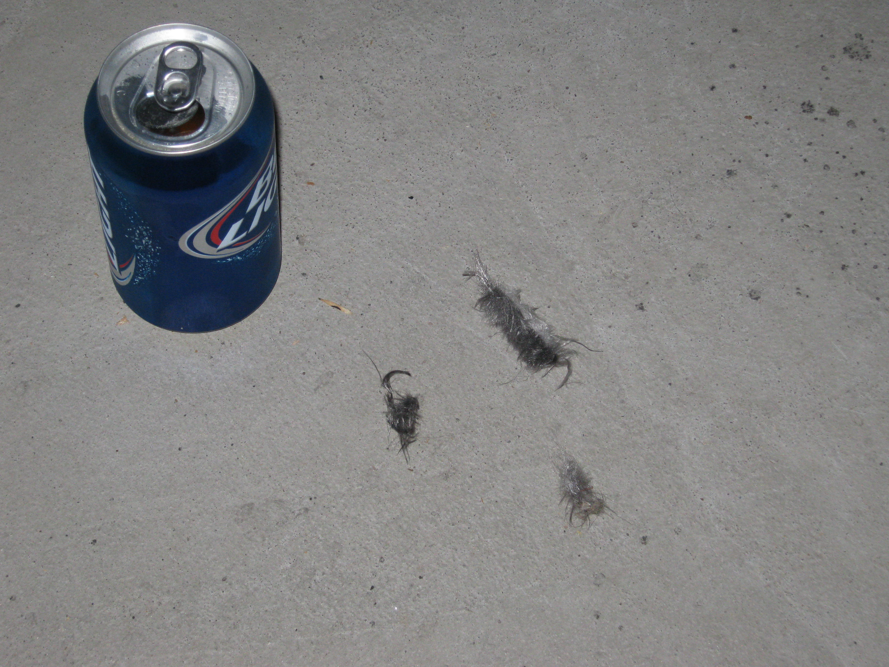

can be my cat? I see wool exhaust in my garage ... my exhaust can be clogged and causing misfire?

I see that in my garage? can I have porblem with my cat or resonator? and causing misfire?
