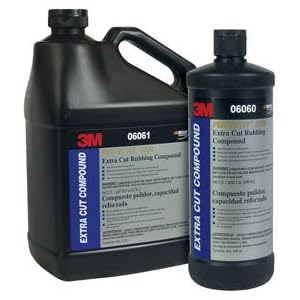

This stuff is MAGIC:
But it is expensive..... This is what I used to remove acid rain from two vehicles here on my lot that sat under a sprinkler that was left on for 4 days on a long weekend in the middle of the summer! Worked fantastic. It relies on heat, which is difficult at times because you have to know how much is enough and how much is too much. Just buffing did not do it, I had to go max speed on my buffer, lay the compound heavy and put some weight into it in moderation.
Also, I am not sure that you can find this in stores, I can it direct from my Detail supply dealer. Costs about $44.95 per bottle retail. (for the smaller bottle on the right)
Hope this helps.
Hope this helps.
Price isn't an issue when it comes to cars paint looking good... I spent $45 on a gal of megauirs diamond cut and it worked on every single one of the families and family friends cars that we detailed, but not my balt. The water marks are about permenant. If you say this is some serious stuff, I might give it a whirl. If not, I'm out another $45. But hey, it'll be another car care product to the collect.
