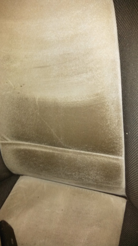

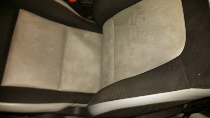

So I picked up a full set of SS/TC seats. Only negative was that they were probably the blackest version of white possible...
Picked myself up a Suede Brush, Suede Cleaner, and Protectant.
Already did the bottom cushion. Gotta work at suede in little steps.
You can easily see the difference... Lots of work left to do.
Anyone use anything easy to get a hold of to stain/dye them black?

Damn, dirty ass seats haha

Stained with butt and reverse happy trail sauce............ewwwww

Wow! Makes me thankful for the set of black on black that I have. I'd have to strip if i had the slightest bit of dirt on my clothes

Dam thatvsurebis dirty. Bleach it! Lol

I would not recommend dying them with store bought methods. Youll find that that dye will bleed off on your clothes.

Multiple sprays of Tuff Stuff will take care of that.

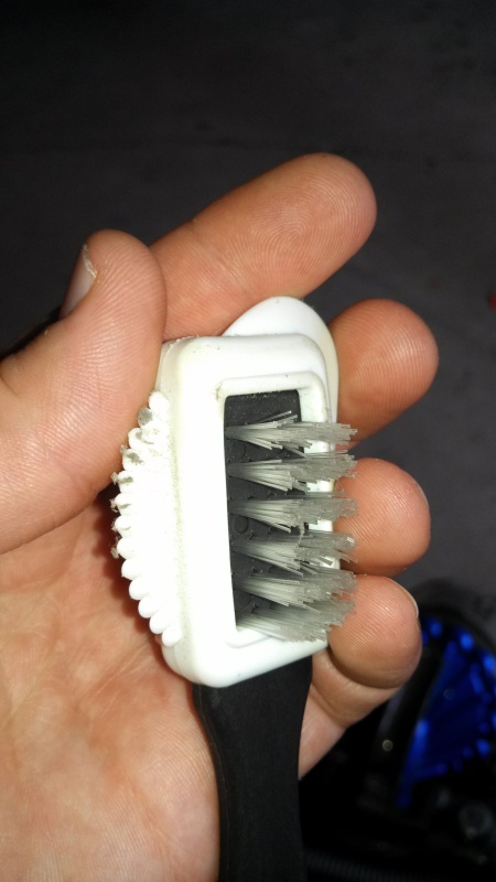

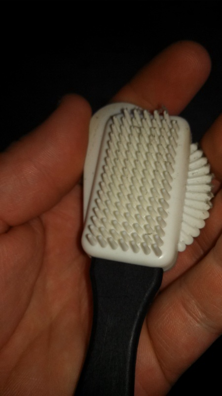

We'll for light cleaning with suede you should use a suede brush... Can find one at Walmart somewhere with the shoes.
Also for a little tougher stains you'll want to use a pencil eraser. Light-medium force. Then use the suede brush to clean the excess off and return the suede back to it's original look/feel.

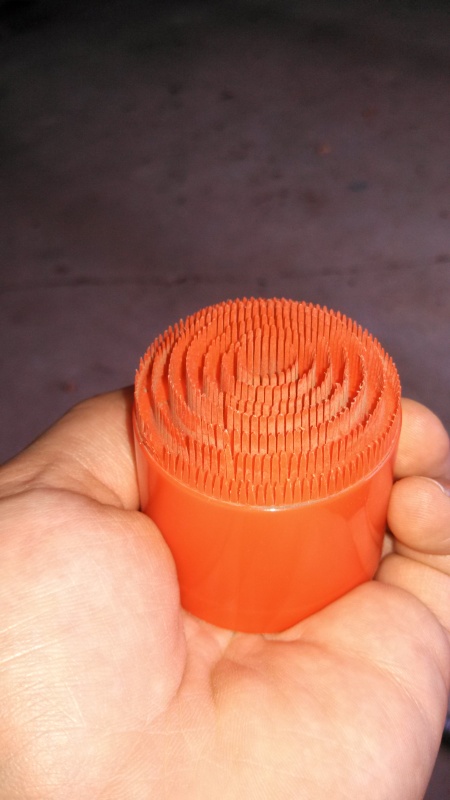

If you have a TON of excess dirt as these seats did you'll want to use a brush with many soft plastic bristles. For this I will have to grab a picture to better explain. With this type of brush you can scrub VERY hard. You'll want to have a vacuum handy to suck the loosened dirt both off the seat and the brush.

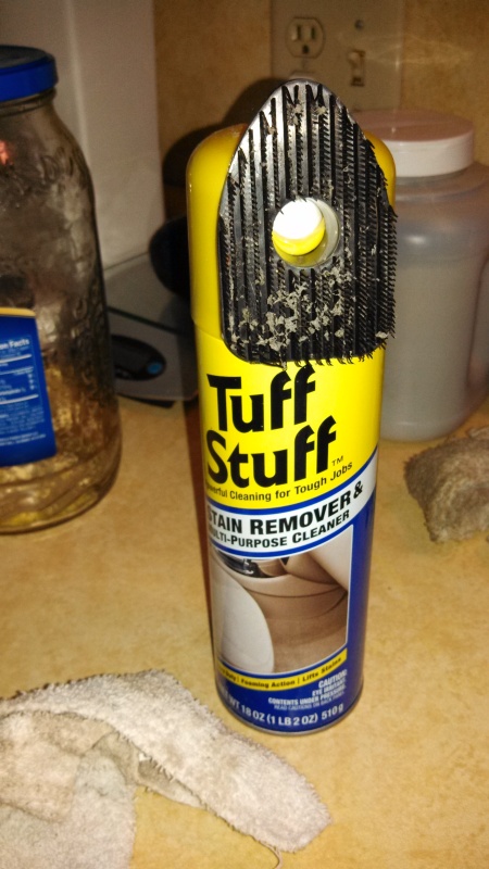

Now... If you have STAIN's... You're pretty SOL. I have tried suede cleaner... It won't work. So next step coming up is Tuff Stuff with can be found at about 99% of Autozone's. Follow the instructions of the bottle to a T!!!

Suede Brush:

Plastic Bristle Brush I was talking about...

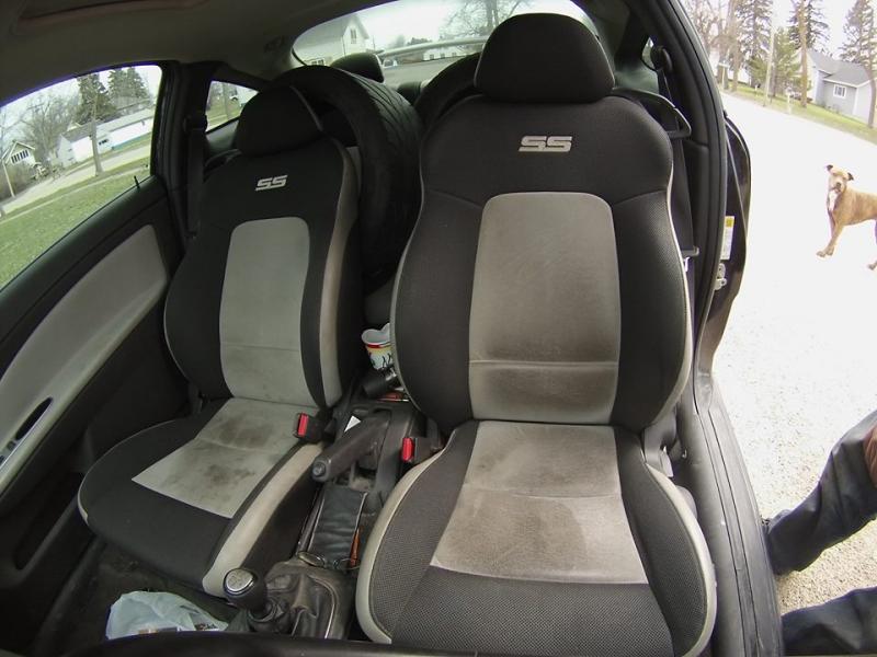

Pic of the seats from awhile back... So they were about 5x worse at this point.

What I used to clean. Spray on thick and allow 40seconds to soak into the dirt. Then use light-medium force to scrub it. Use a dry towel to pull the dirt/stain up.

Seat cleaned... Still needs a tad more time to dry. Will take at least a day.

generally my routine for cleaning the seats is soak in tuffstuff or even a different fabric cleaner thats ok with alacantara, then wiping quite lightly in one direction with a microfiber, then use the vacuum and sock that microfiber over it to see how much dirt gets onto the mirco. good way to gauge the progress while still pulling up the dirty solution, and also keeping the sharp vacuum hose off of the alacantara. i need a suede brush

no wonder they are dirty you have tires in the back seat!
they look good tho man nice write up!
