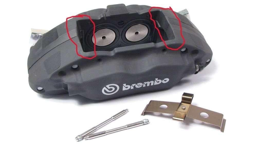

Another thing to look for on Brembos, make sure there isn't a buildup of brake material on the caliper where the pad should move. I just did brakes on my Touareg (they have 4 piston Brembos only slightly larger than the Cobalts) and the car had sat for a while and there was a buildup of brake dust and rust that prevented the pad from being able to move freely.
It's tough to explain so here is a picture, the red circles are the areas I'm talking about all surfaces that are internal to the pads
I noticed that before after one winter there was some caked stuff in there for sure. You know what drives me nuts in some of those videos guys guys smacking the round part of the caliper with a hammer to get the pins out. Just use a punch for god sakes lol .
Just full ape banging away at the caliper lol .

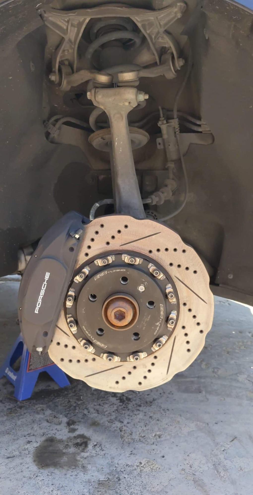

That's a crazy looking rotor. I think the best I had was baer rotors on my ls1 ws6.
Sure is a simple device no doubt. That's why when something doesn't work right it makes you scratch your head sometimes or overthink it. Usually something simple.

As an engineer, my only response is that a caliper is a simple mechanical device that applies a force via hydraulic pressure. Eating rotors depends on the hardness and quality of the rotor combined with the aggressiveness of the pads are being utilized.
A fixed caliper like the Brembo will actually eat the rotors less than a sliding caliper since they're able to apply pad pressure more evenly to the rotor. I experienced this with my previous Audi S5. The single piston, sliding caliper would eat the inside of a rotor far quicker than the outside. Swapped to a set of stock Porsche Brembos and the problem went away.
