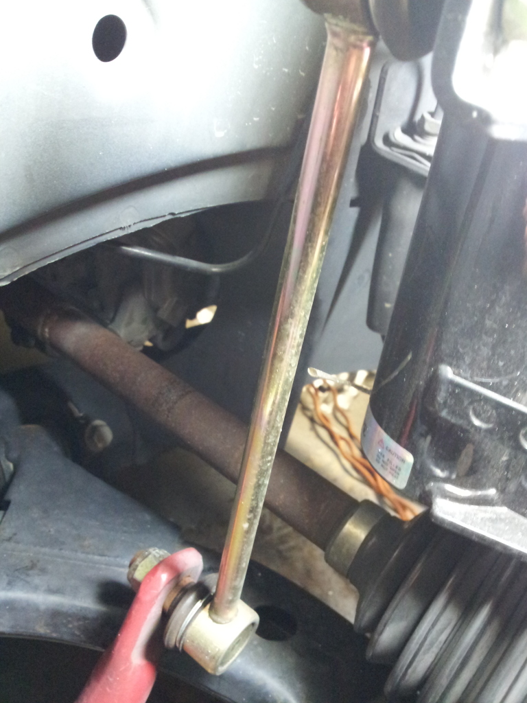

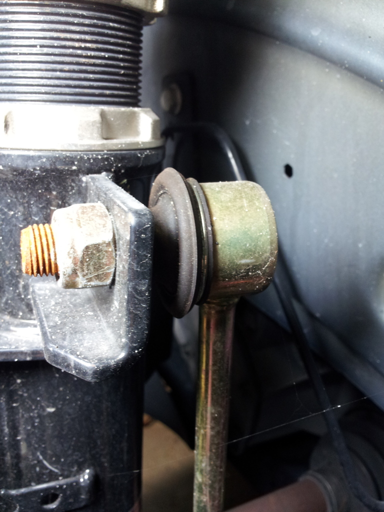

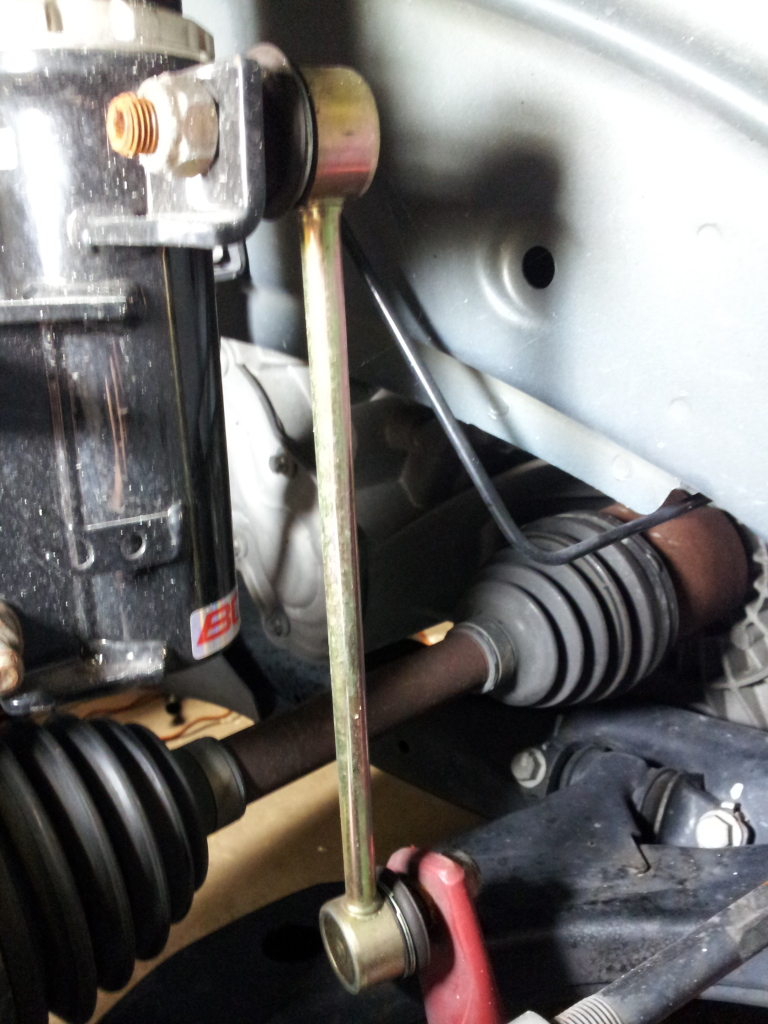

Damn lol, I have BC Coilovers as well and have a "clunking" noise coming from the passenger side. I was reading on the forums and people noted that the noise could be coming from the bushings of the control arms or endlinks... I looked at my endlinks and they look fine.
I was going to try some new bushings from Powell but that's down the road... For now I have been just ignoring the noise haha.
These are what my endlinks look like, I don't even know how to tell if/when endlinks go bad -_-?

Grab a hold of the sway near the end and push it up and down. If you feel play in one side, then that side end link is no good.

just did a quick Youtube search and the method is as you described dwarrick
Here's a link if the OP wants to try it..
car end links - YouTube
I will give this a try maybe in a week or two.. but how feasible is it for endlinks to go bad within months?
