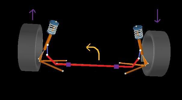

Yes it is an issue of reduced traction. Besides limiting body roll the key feature of a sway bar, which is what I have been trying to help people understand, is that it is designed to reduce traction on the end of the vehicle it acts on. Look over my first post again, I thought I made i fairly clear whats happening, but heres the short version:
A sway bar lifts UP on the inside wheel in a turn. It reduces the amount of ground contact the inside tire has The stiffer the sway bar, the more dramatic this effect will be.

Heres a little pic I drew up, it show how the sway bar reduces traction. This car is turning left, the yellow arrow points that way. On a LH turn we know the car is gonna roll to the right, and push down on that side of the sway bar, as well as compress the spring, forcing the tire into the ground, a good thing. We can also see how the sway bar(red) which is conected to both struts is actually keeping the left side spring compressed, not allowing spring to keep wheel in contact with ground/lifting the left tire up. The stiffer the bar the more dramatic this reduction in tire contact/traction will be

Good post Maven.
So what it sounds like to me, is that before messing with sway bars, you want to get your car's suspension set up first.
IE if you are gonna get sportlines, get those first and see how the balance is.
If you like a slight oversteer, get a rear bar. Slight under, get front. But not huge bars.
Makes sense to me. Thanks for the explanation
that made perfect sence. now the stupid quesion. why on earth would you want to lift up the inside wheel?

i think its time for me to chime in good buddy dont take offense: DUH! If the damn smilies would work i would make duh bigger and rofl cheers
SO NOW do a drawing that shows the reduction of body roll from the front bar keeping the rear wheels on the ground lol

You need to determine what kind of ride you want for the car, then you can determine the spring rate that will provide that ride. Once you got the spring rate, you then determine what kind of roll gradient you want for the car. With the roll gradient picked and the spring rate you can then calculate (combined with other variables) the required roll stiffness for the ARB.
No one wants the inside wheel to life off, it is a side effect or trade off when providing roll stiffness for a car. This is exactly what Maven is trying to say all long and all race car engineer strive for. Too much or too stiff is not better, a car is a system and the art of set-up or tuning is to "proportion" the different components "appropriately" to derive a "balanced" system for a specific application.

k I'm getting all this to make sense more now. It has helped, But wouldn't the stiffer bar in the rear be ideal for most stituations, autox and daily driving. I mean i like oversteer better than under, and i'm sure that oversteer would be better for autox with less push from the car, meaning better turning, faster times. And yes i see how there is a lift on the inside wheel, but would it be a safety issue with the wheel coming off the ground completely? I am lowered two inches too so that would lower the center of grav. and weight transfer too so that should lessen the amout of traction being lost too right? Also Going with the Theory the bar effects the opposite side it acts on, wouldn't the ttr only benifit fwd cars more keeping the front tires both planted?
thanks for the info. I just don't want go with the stiffer is better idea and have it end up being some thing that hurts more than helps.(ttr rear bar)
There is such a thing as excessive oversteer. Again the key is to find a balance to suit a specific application.
I cant display both axles at once yet........:dancingpickle: I am trying to figure out a way to get it to show corner weights though, once I get that, youll get your damn drawing
I would like to know how it is that so many people have to come "like" oversteering?
What are you guys that like this handling trait driving that allows you to make this claim?
How do any of you defend "snap" and "trailing-throttle" oversteer as desirable or safe handling dynamics for a road going car?
