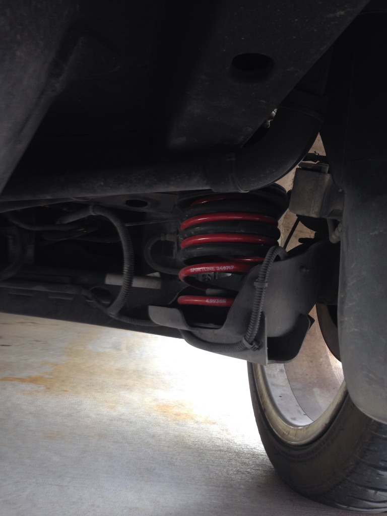

I just purchased my 2009 Cobalt SS / TC coupe and I seem to have Eibach Sportline springs in the rear.
Is this garbage?

If so your front should sit way higher than the rear does. Jack the car up and look to see the inscription on both the front and rear springs, if it's not completely rusted over it shoudl say Eibach on them.
I doubt anyone would be dumb enough to put only the rear springs on.

My rear ones are very easily visible because they're red lol but the one's in the front look untouched and they're black?
I'am low in the front and have lots of scrapes though and had a sad face once I saw all the boo boo's
I'll get pics soon once I figure out how to post!

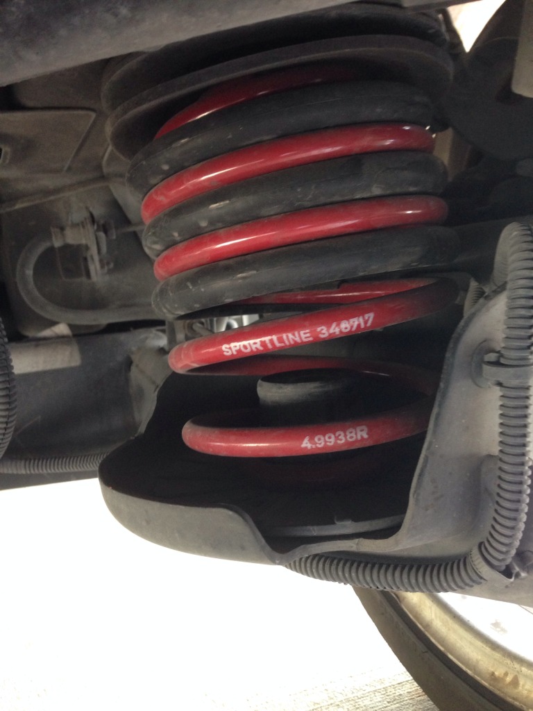

Probably is the case as the stock springs are black.

Oh man, I forgot how bad the Sportlines coil bind in the rear

So if read correctly, I should get these Powell YYZ Spring Pkg YYZSKIT
AND
These? KONI: shock absorbers kit containing front & rear shocks

Only get the shocks if you have a lot of cash to blow- Koni shocks are an upgrade, but the stock LNF shocks are still quite good. As for the springs, understand that the powell springs will not be very 'aesthetically appealing.' By that I mean they aren't going to be very low. Their primary purpose is for the track.

Yep and also a powell rear swaybar.

I like how the Powell springs are. I have them and Koni shocks.
