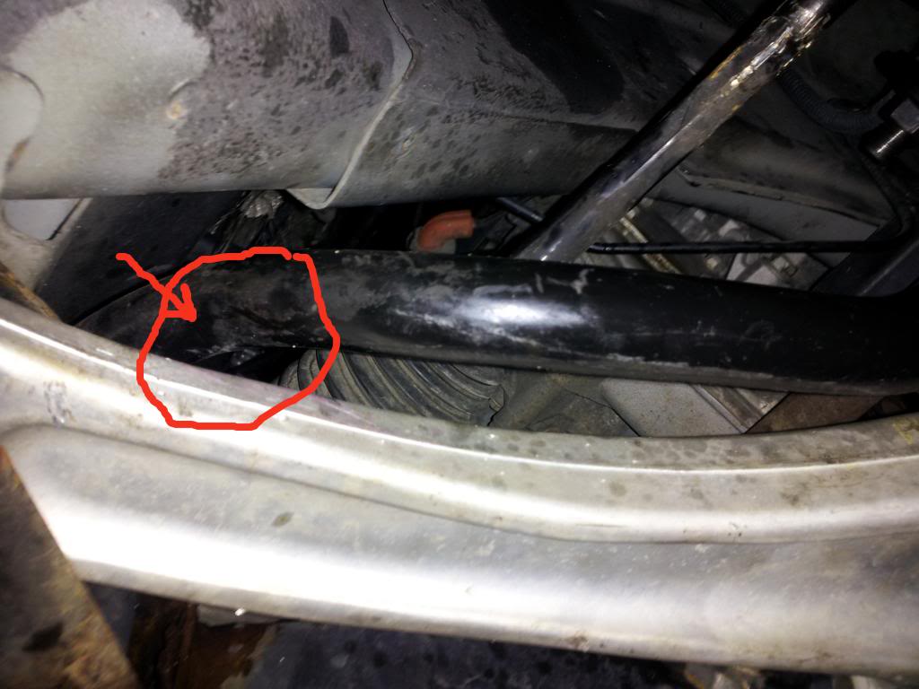

Today I had a lot of metal on metal noise coming somewhere from my passenger side front suspension. We have replaced the sway bar bushings, one bad endlink on that side and checked the integrity of all bolts, ball joint, and tie rod (control arm bushings were replaced in Feb.). The only thing I can figure is the sway bar I have (from a SS/SC) is making contact with the control arm (see photo). This noise did not present itself until I replaced the struts from SS/SC struts (05-07) to SS/TC struts(08-10). Below I have provided pictures from my SS/SC sway bar and control arms and SS/TC endlinks and struts compared to my friends SS/TC sway bar, endlink and struts with stock control arms. Side note, SS/TC struts is about a 1/2" drop from the SS/SC struts.

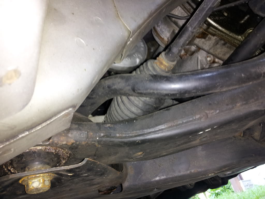

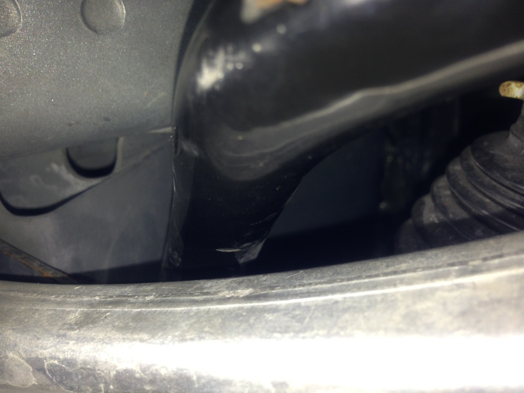

Question 1: Is it possible that because of my setup combination the sway bar is contacting the control arm (causing the noise I was hearing all day).
Question 2: Should I back out of my event tomorrow or will it be fine to live with and get a new bar before next race? Side note, the sway bar is solid steel and the control arm is aluminum.
(my sway bar location and curvature)

(gap on my sway bar/control arm) (arrow is where I think you can see scuffing from the contact)

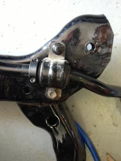

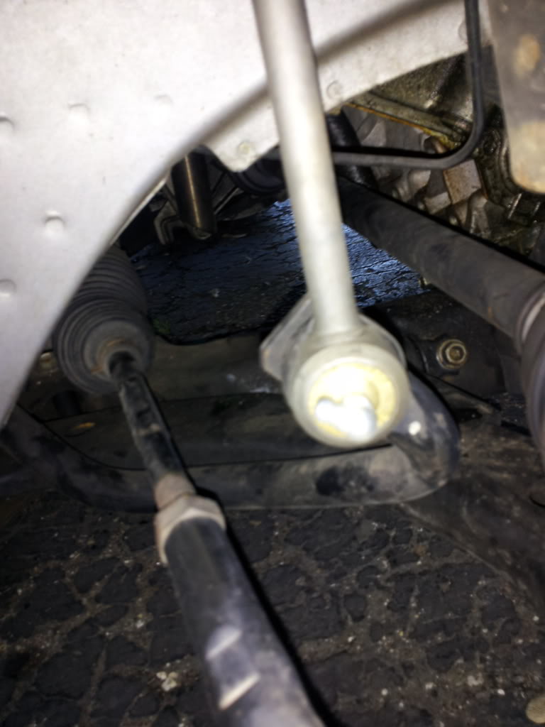

(his sway bar location and curvature)
(his gap from sway bar/ control arm)

Sort of a late reply... but I believe I am having the same problem lol! If I make an aggressive turn I hear some metal on metal rubbing/noise from the passenger side. I lifted my car up and I saw some rust in the same area as your red circle. I am a base Cobalt, I swapped my old sway bar for a Cobalt TC (LNF) sway bar, upgraded my control arms from Fe1 to Fe5 (pre-2008), and I am lowered on coil overs.

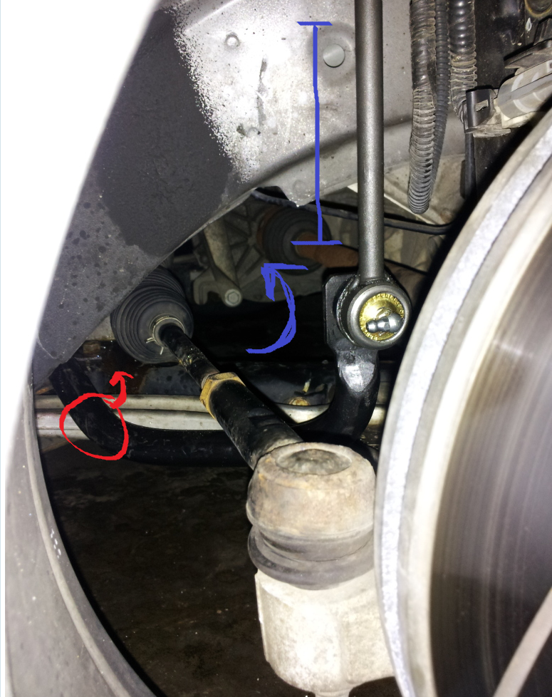

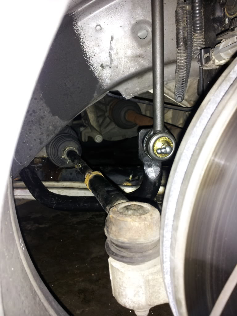

This is what I saw when I took off my end links are rotated the sway bar a little bit to get a better look.
Have you tried using smaller length end links? If you try smaller length end links it'll rotate the sway bar up giving you a little bit more clearance in your red circle. That is what I was planning on trying.
I tried using Microsoft Paint to explain my reasoning visually haha, so excuse my artistic touch -_-

I have the shorter 12in Moogs already. I was considering getting shorter ones that just fit, but I've opted to try a TC bar instead. I put painters tape on the control arm and none of it scratched off after a full day of AutoX so I've ruled that out as the cause. Two other theories have arrised now.
1. The sway bar is flexing due to the amount of stress (dont know how that produces the noise) but it came from a respectable car guy
2. My new theory is that the base models came with a one bolt system for the sway bar bushings. With as much load as I put on these things the tab might be semi-lifting out and popping back in every time. I wish I could switch to the two bolt system like the SS's have, but that would require a lot of front end swapping that I'm not willing to do.
If I can beat a 12 WRX in autox and nothing broke I'm not terribly concerned about the safety of it any more.
Too bad .net community doesn't have any input on this topic. I was hoping at least John Powell would chime in.

I believe you can fit the two bolt style clamp in your car. I think all you have to do is drill the hole and add a bolt. John Powell has done this before if I'm not mistaken...

two bolt fixing already posted on here. and clamps for the bar to stop it moving side to side.

To test my original theory of the sway bar and control arm making contact I put some painters tape on the arm, no rubbing. I think I will do the same with the bushing bracket and see if it is popping or not. This fix looks like a lot of work just to find out it possibly doesn't fix anything!
Adjustable endlinks might come after I replace the sway bar if I still get the noise.

i sell a clamp for the bar you chisel off the old plastic sleeve which walks on the bar, and put in this clamp.
