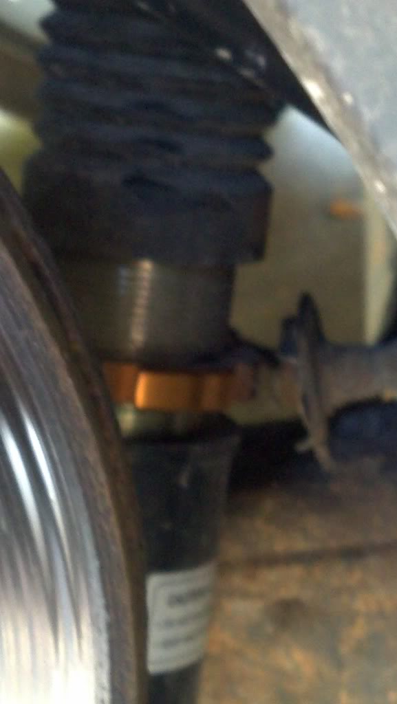

Hey, just looking for some help since its my first time adjusting my coilover since putting them on. I have the Stance GR+. I looked on their website, adjusted the lock ring 1\4" higher since it started on the bottom. Put the wheel back on and lowered, and no change. I guess im confused how they work and would appreciate some guidance and knowledge.
Here is the lock ring up a 1/4" from bottom
As soon as i lower it back down it sits onto the tire. What am i doing wrong? Lol

are you trying to raise the car up?

Adjust the ring/perch on the springs to Lower/raise

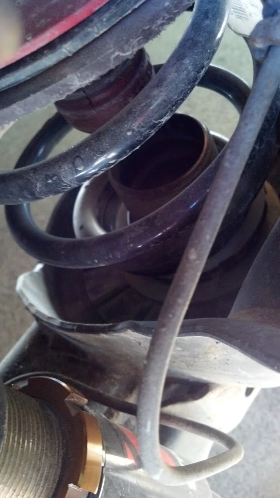

Im trying to raise so its not rubbing the fenders on the wheels. And im on the rears right now. Havent messed with the fronts yet

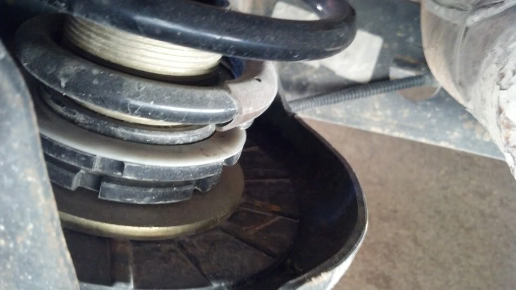

Take a picture of the spring in the rear

From: Moline

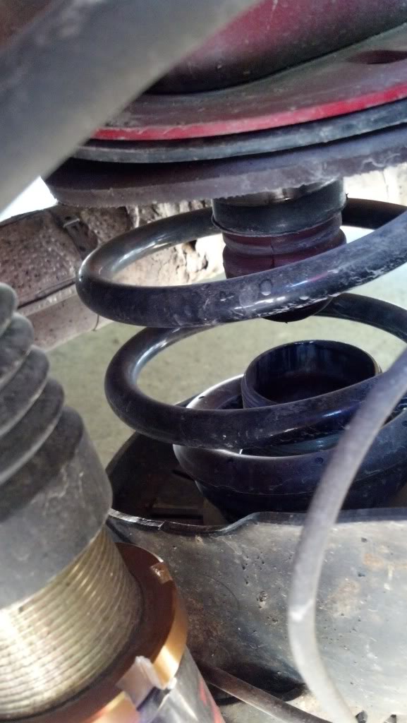

Old Aug 10, 2013 | 03:45 PM
the only thing u adjusted was the length of the shock in the rear from the looks of the picture.
adjust ring on the perch where the spring sits
edit: turn the rings on the perch up about an inch and u will be fine

Screw the rings on the bottom up

Ok thanks, i see what you meant. Also where should the rings on the shock be?
Old Aug 10, 2013 | 03:53 PM
to get the preload, keep the top of the shock bolted and let it hang, jack up the axle to compress the springs and do that 1/4 thing to adjust the shock length to match the spring
something like that, then u can bolt the bottom of the shock back up and have a good day haha

you want to adjust the springs to your desired height. then you just adjust the shock to meet/line up with the holes
