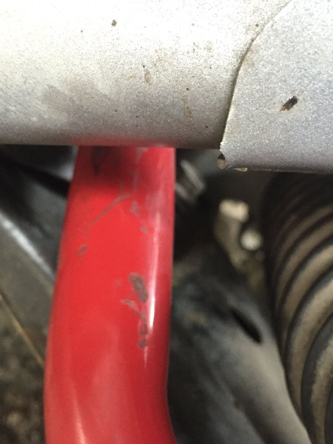

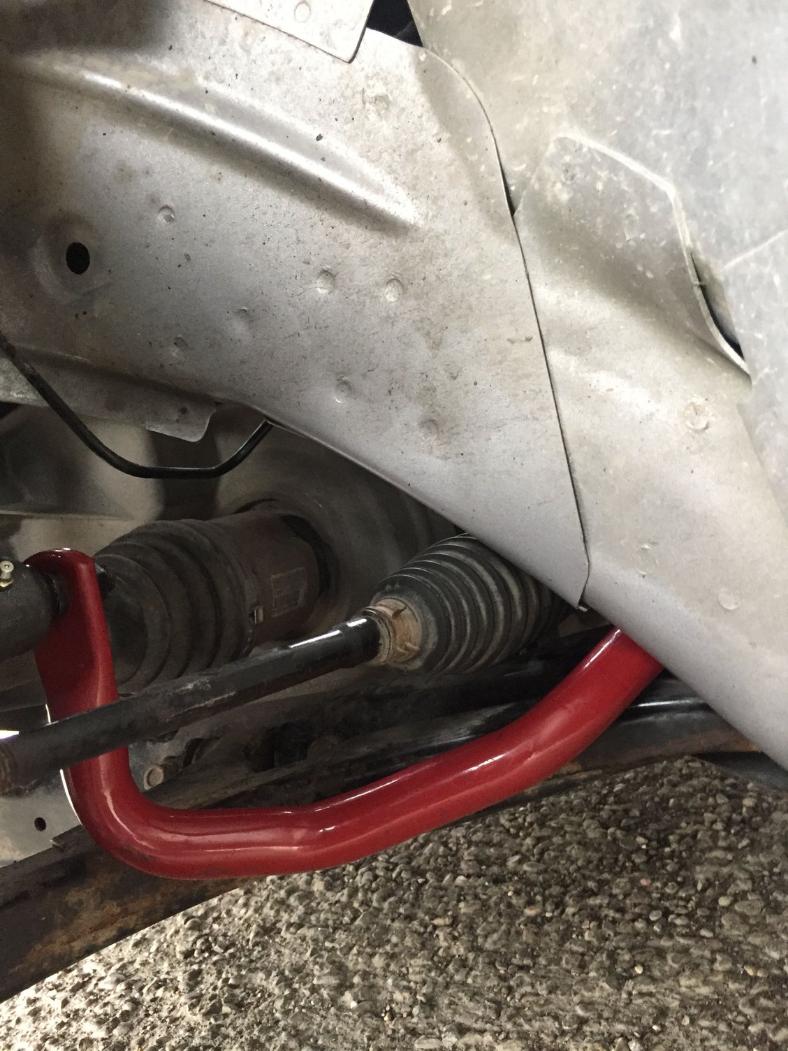

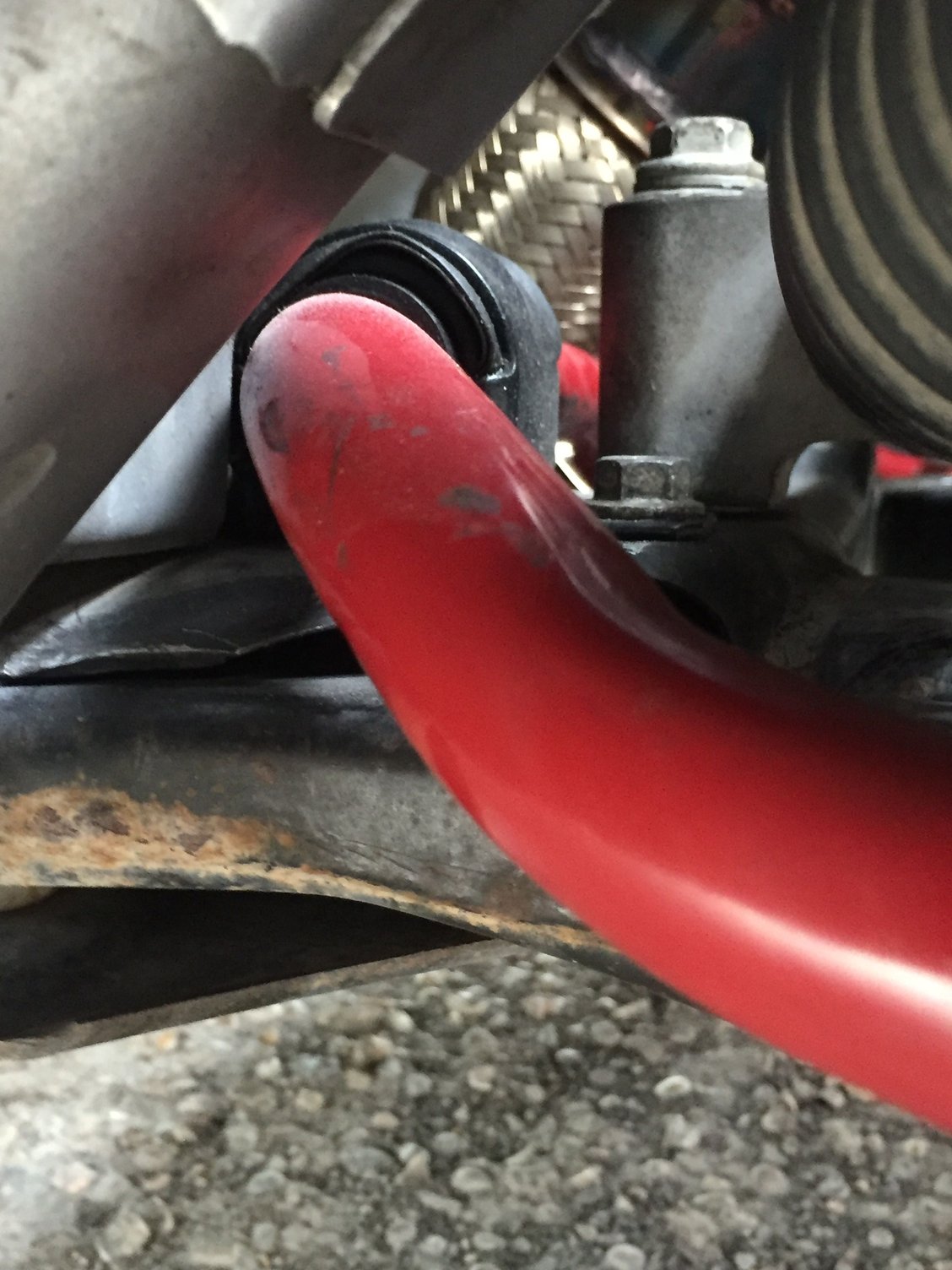

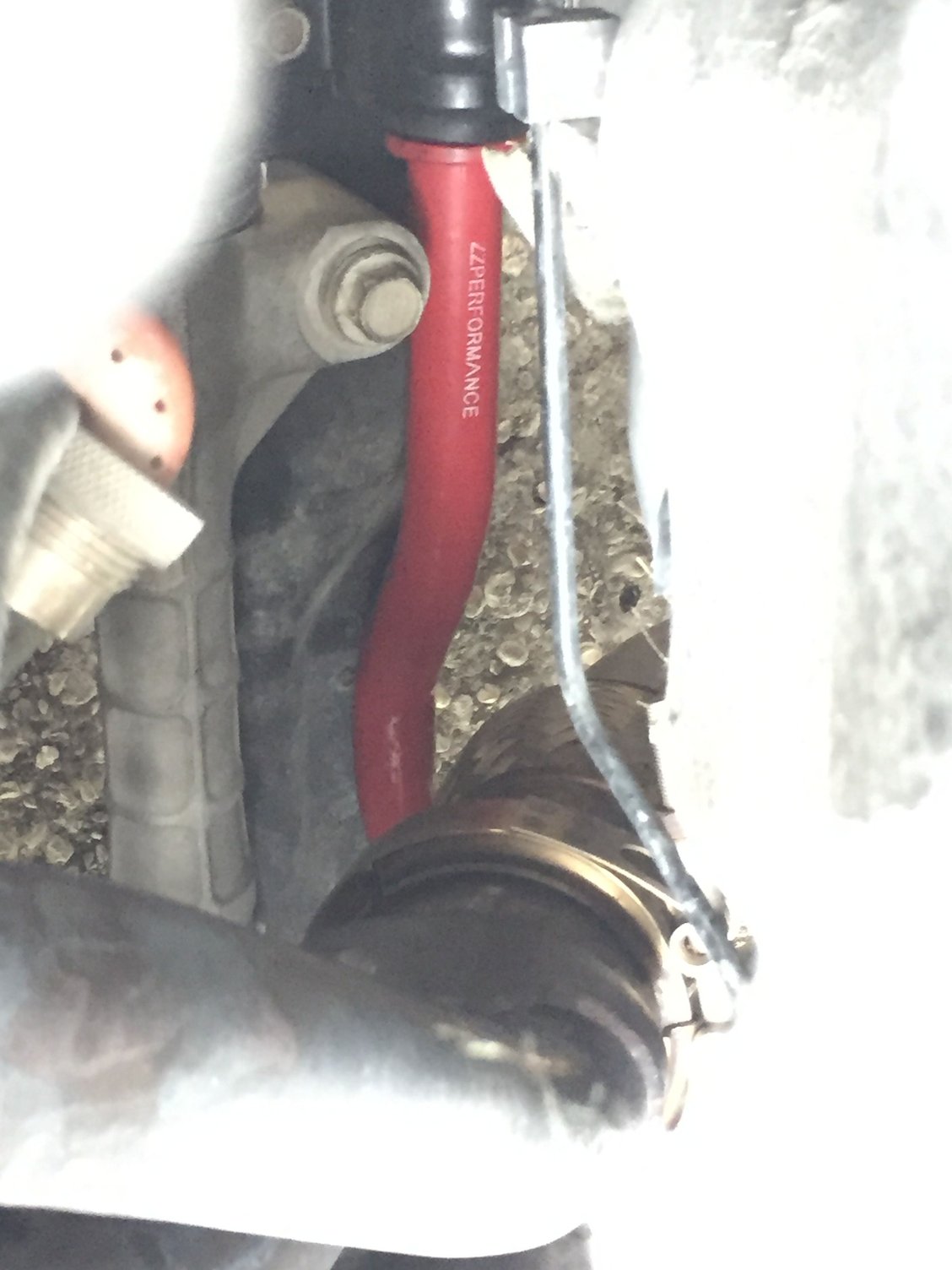

Gonna post some picture. Guys my problem is still not solved **** my life. Point me to the nearest bridge...
my bushings, my clamps are fine, forget about that.
I currently have 9.86” links on, if you read up I originally thought this was my issue.
I know my vehicle should have 11.8” links on and today I booked in my car to have the swapped out yeah my problems will all be solved after this and I can enjoy a drive home.
well the mechanic would not even install the links clamimimg I should be getting smaller links like Jesus.
To his measurements he said a 7” link would avoid my control arms and avoid my tranny mount etc.
Well ive read no where that anyone has used smaller than 9.8” links. I’m ready to give up, I homestly don’t know what to do.
Old Jul 16, 2018 | 06:41 PM
  #30
G5ALIVE's Avatar
Joined: 07-04-18
Posts: 967
Likes: 139
From: Oak Lake
underneath up
Old Jul 16, 2018 | 06:52 PM
  #31
G5ALIVE's Avatar
Joined: 07-04-18
Posts: 967
Likes: 139
From: Oak Lake
someone tell me it's upside down? maybe.

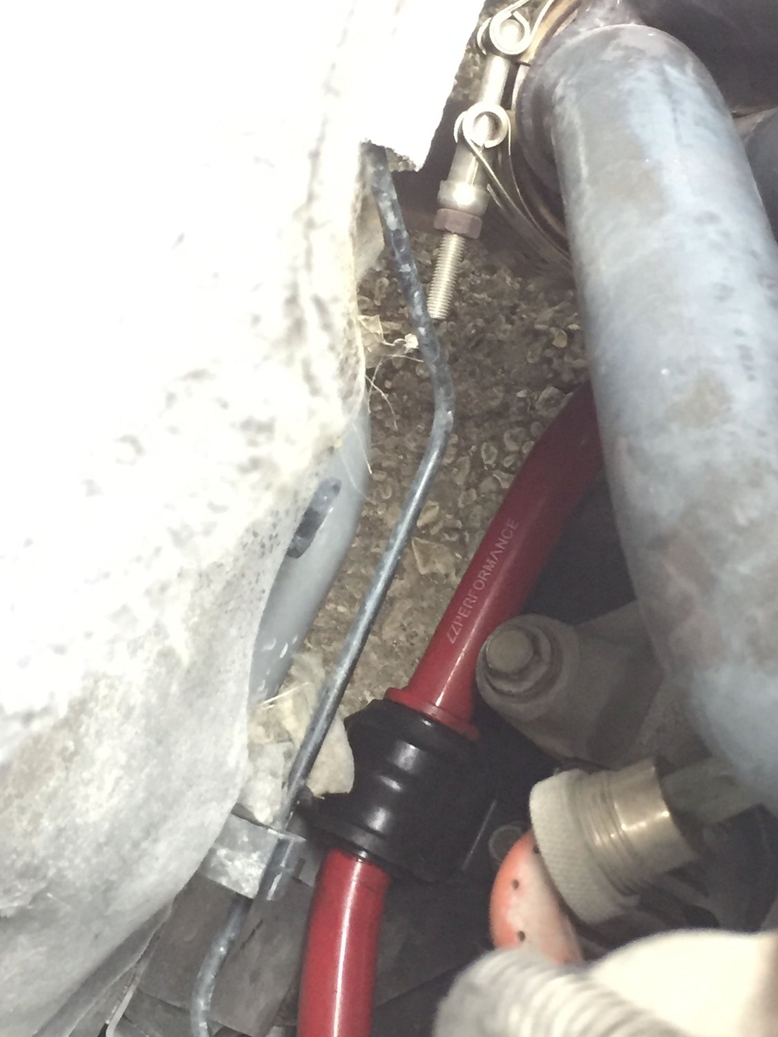

Old Jul 16, 2018 | 07:47 PM
  #32
G5ALIVE's Avatar
Joined: 07-04-18
Posts: 967
Likes: 139
From: Oak Lake

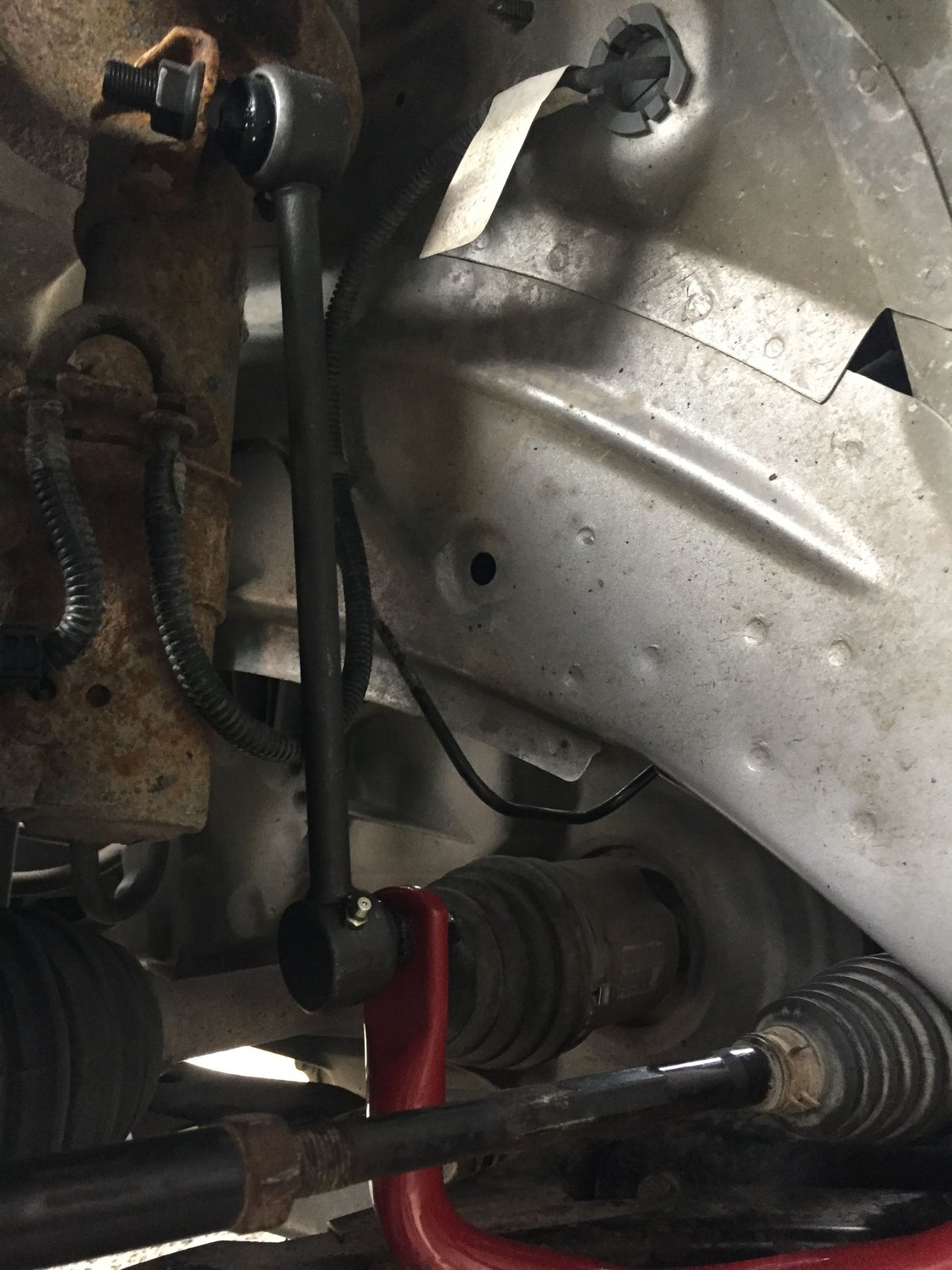

Tomorrow I'm going to have a mechanic put on 11.8" links and see what happens, he said he would do it in his down time for free.
To be honest I can't even find one other person who installed a ZZP front sway bar on their cobalt and posted pictures...
The bar never came with instructions for install.
Can anyone tell me perhaps what position their ZZP lettering is in? can you see it from the engine bay straight up/ is it on an angle?
-grasping at straws

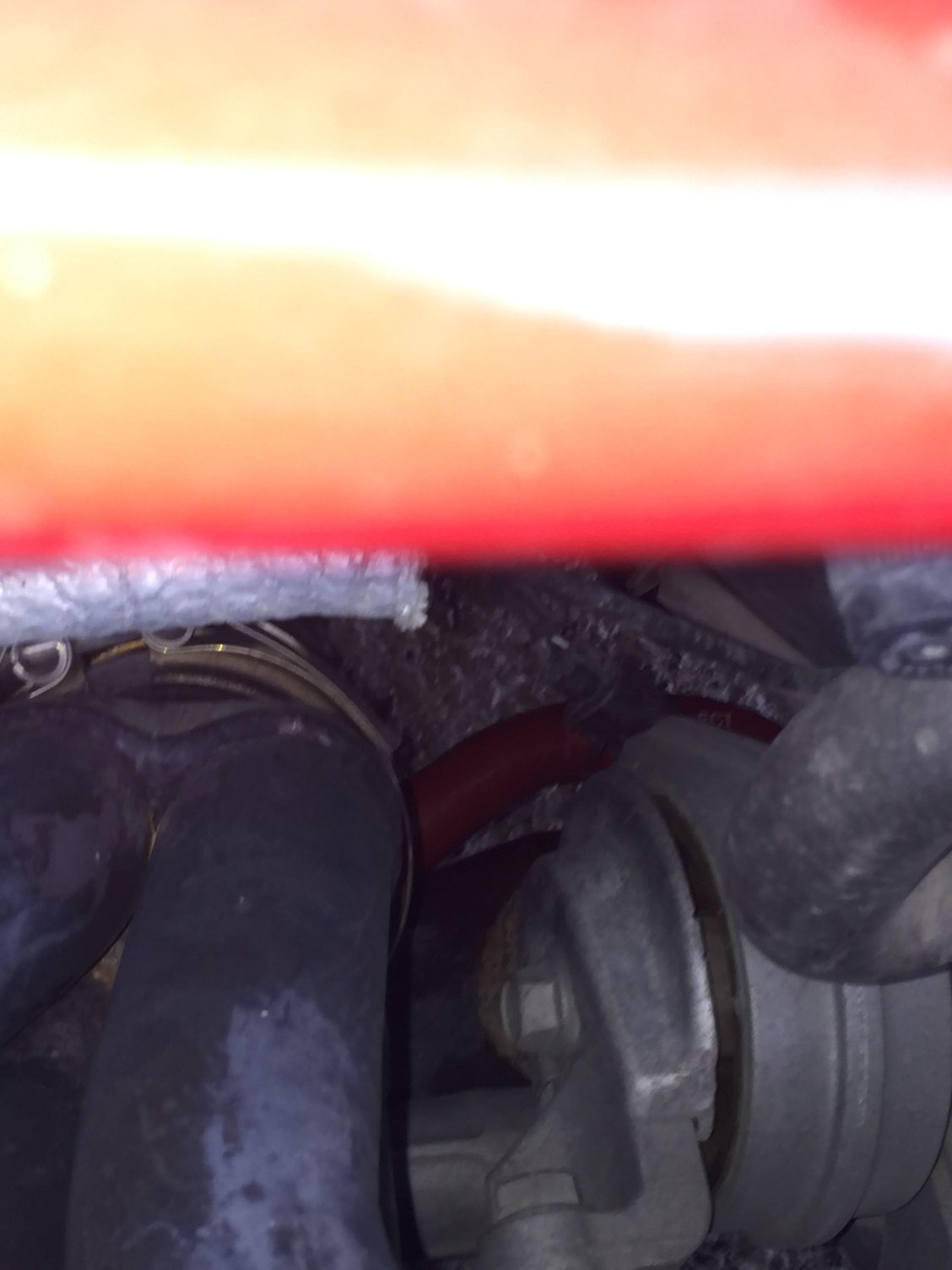

Old Jul 16, 2018 | 09:13 PM
  #33
G5ALIVE's Avatar
Joined: 07-04-18
Posts: 967
Likes: 139
From: Oak Lake
I haven't tried that yet, maybe I will be very soon
To me now that the bushing clamp noise is out of the picture, what I'm hearing distinctively sounds like worn out stabilizer links.
Going over Speed Bumps, At a crawling speed of 1km/h is pure ironing boards unfolding as I come down the hump.
Found a picture of someone with 11.8" links on their cobalt with a Eibach sway bar, I know its not the same, but a longer link would put my bar in a smimiliar position as 07ls sport has on hsi car. IDK

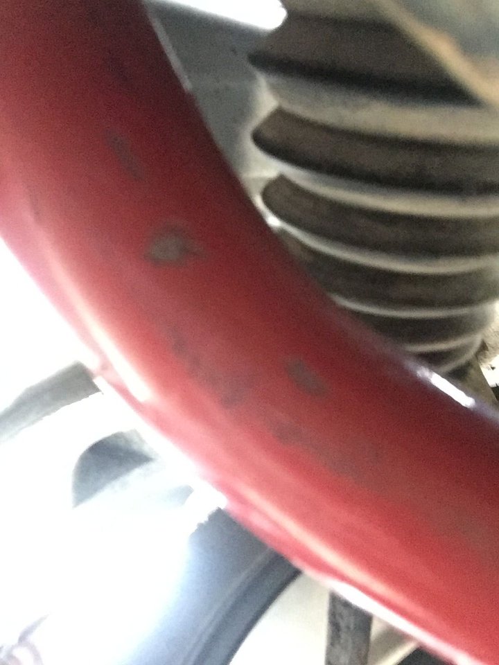

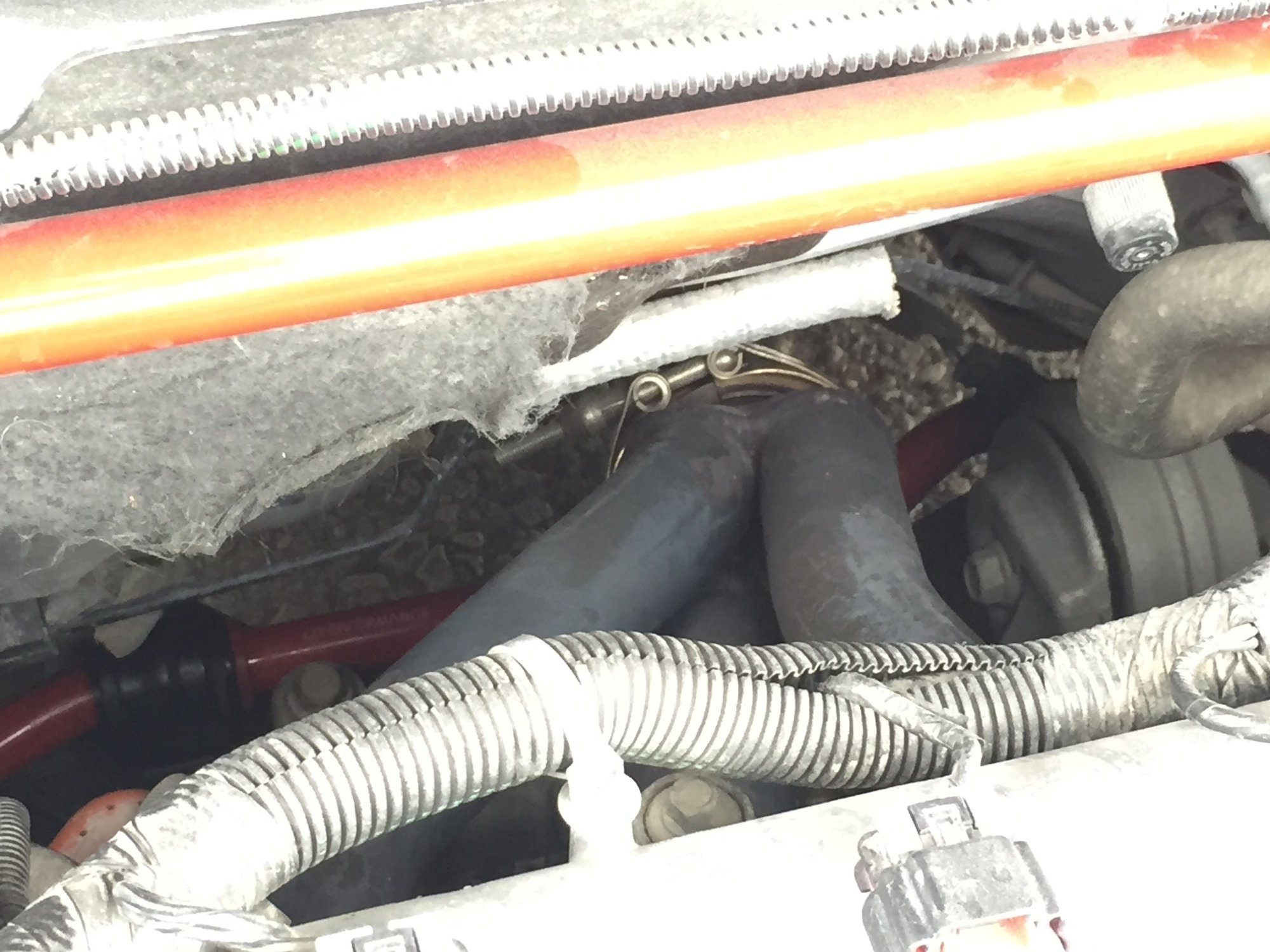

I did, with the bar still in place. The noise was still there.
Links play a part in bar position, the bar regardless of being in a 9.8”/ 11.8” position, is hitting my control arms and the the frame from above, as it comes into the wheel wells.
As my shocks go down body goes down, closing the frame to bar gap.
As control arms go up, it’s closing the gap from below.
As I go over a speed bump what I am hearing is the bar grinding on the control Arms, as I come down, I hear my body coming down on the bar.
Not sure if this bar is simply not curved to clear everything. Been comparing their bar to stock bars all night and I’ll twll you even an fe5 bar like 1 mm smaller, angles like crazy at this point, bending all over the place to avoid everything.
The zzp bar just does not appear curvy enough to avoid the two

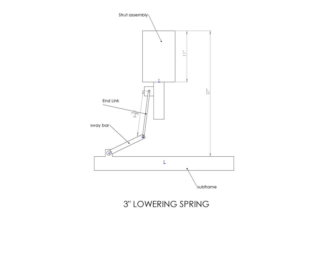

Originally Posted by SSuperchargedLife
The end link length is for ride height. Are you lowered?
I don't know where this started but I believe it to be a common misconception. As far as I can observe the different length end links correspond to the different geometries of the FE1 and FE5 sway bars. When side by side the FE5 sway bars curve upwards further on the ends than the FE1 bars do thus requiring a shorter end link to keep the bar clocked the same relative to the pivot point. Considering the geometry of the suspension it doesn't make any sense that a lower ride height would require a shorter end link as that would just clock the sway bar even further from it's stock position. See illustrations below which are exaggerated for clarity.
Old Aug 1, 2018 | 10:31 AM
  #49
jdbaugh1's Avatar
Joined: 02-03-16
Posts: 6,435
Likes: 358
From: Kansas
^^Definitely agree. I'm assuming the GM engineers optimized this geometry in the stock configuration and that using the wrong end link for the bar will rotate further away from the stock clocking and that the shorter bar combined with a lower ride height moves it even further in the same direction rather than correcting to stock geometry for the ride height change. Therefor I don't see how it makes sense to use a shorter bar because you dropped your ride height.
Old Aug 1, 2018 | 05:26 PM
  #50
SSuperchargedLife's Avatar
Joined: 05-04-12
Posts: 21
From: L.I. New York
Those are good illustrations. Its great to learn more about it.
​​​​​ I never put lowering springs on my cars. I thought lowering the car changed the suspension geometry, control arms, sway bar relative to a fixed point like the subframe. The body is lower but the suspension is up higher in the wheel well, making for less travel. I guess with bigger wheels and more grip and ss suspension shorter end links won't flex as much as the base model links and help under higher loads?
Looking at my stock endlinks, the sway bar mount points up almost parallel with the strut allowing force to push down on the bar. I understand with an even shorter end link the bar would be at a different angle (pointing slightly towards the windshield) and the end link would angle back at the bottom. Would that affect the stiffness since now the force is not pushing straight down, its more of a pivot point since its a ball type mount?
Sorry it got off topic you guys are very knowledgeable. I still wonder why his bar hit all over.
