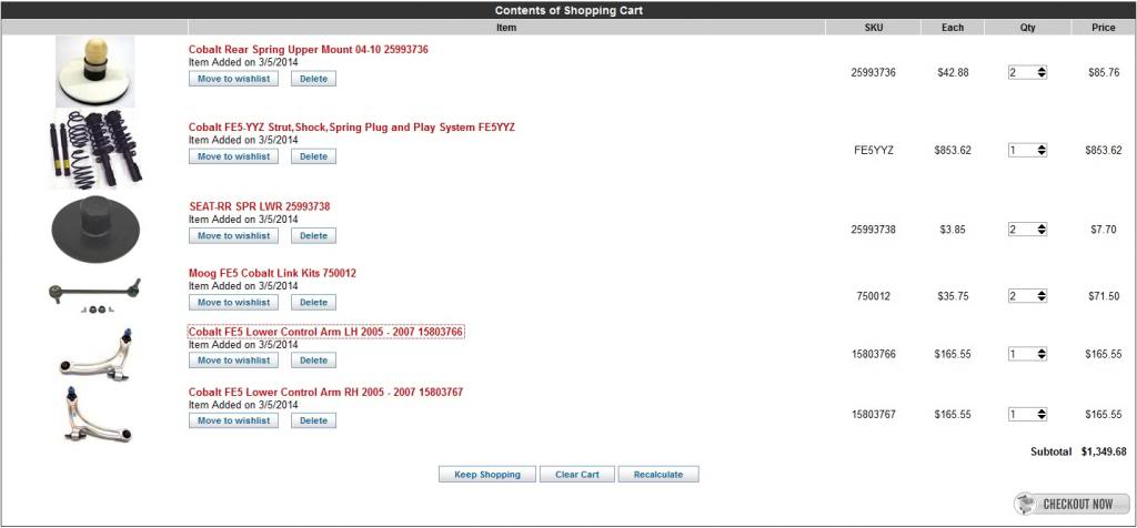

Okay, last question(s).
So if I go ahead and just get the FE5 control arms from CED, I want the 2005-2007 ones, correct? These here? (LH and RH obviously)
Cobalt FE5 Lower Control Arm LH 2005 - 2007 15803766
Those are ready to go without needing to purchase bushings and whatnot?
Lawd this is already way more than I planned on, lol.
Old Mar 5, 2014 | 09:35 PM
Interitus's Avatar
Joined: 02-28-14
Posts: 37
From: St Louis, MO
Or here's the cart from CED if it helps.

Wow, those end links are expensive.
Old Mar 5, 2014 | 09:40 PM
andrewcarr1993's Avatar
Joined: 10-23-12
Posts: 5,095
From: Clarence, NY
Yep that's it.
That's about their going price.
Old Mar 5, 2014 | 09:42 PM
Pitbull2o08's Avatar
Joined: 11-08-12
Posts: 1,691
From: San Diego
Rockauto has that exact part for 19.40
Interitus's Avatar
Joined: 02-28-14
Posts: 37
From: St Louis, MO
I'll have to close my eyes and look away, but I'll hit that order button tonight then, lol.
Thanks again to everyone for helping the newbie
Old Mar 5, 2014 | 09:44 PM
Joined: 11-08-12
Posts: 1,691
From: San Diego
So that's the 9" one correct?
Old Mar 5, 2014 | 09:49 PM
Joined: 10-23-12
Posts: 5,095
From: Clarence, NY
Yep the FE5 ones are that size.
