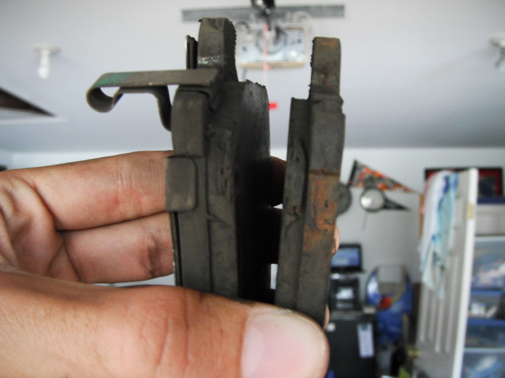

did i really new new pads?? dealer said i was in the RED..

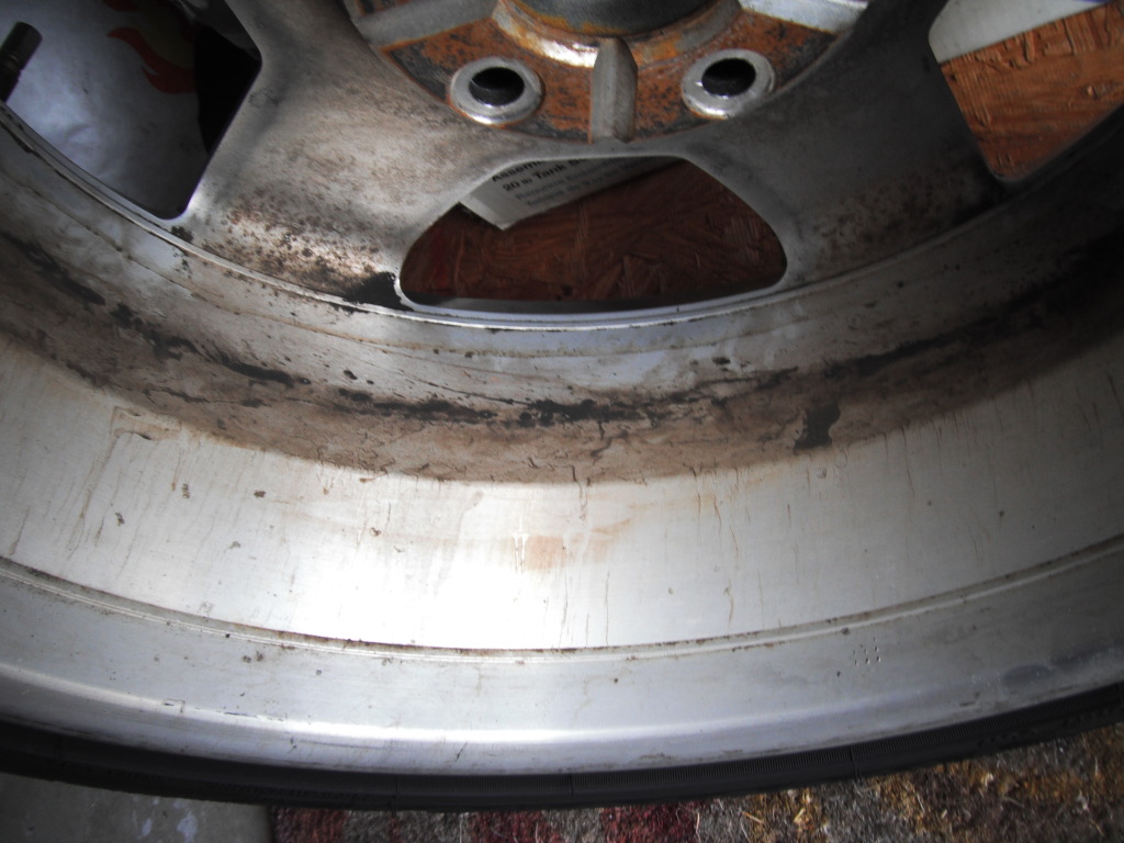

and what is a good degrease i want to clean the inside of my rim..

Yes you need new pads. Your inside pad is done, and ur outside pad is nearly there as well. As for degreaser, find one at autozone or something. Not sure of any huge differeneces in degreasers

ok it just looked like to me that there a little bit of life left and i found some simple green here at the house.. going to see if that works
