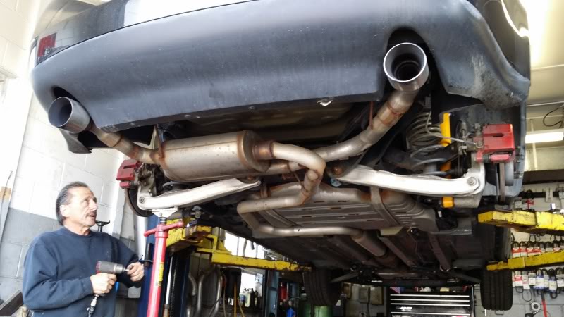

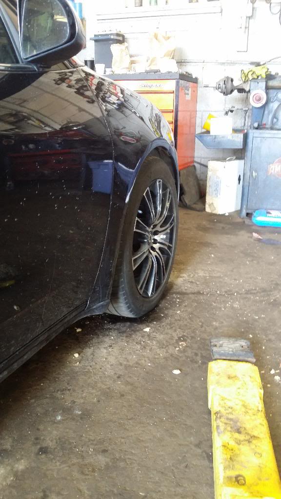

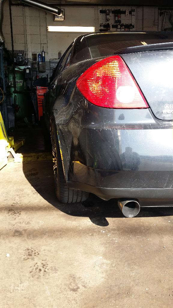

I'm basically at a stand still at this point, about one thing, a manner to adjust rear chamber. I've thought about a E-centric bolt for the rear but I can't find one! - fortunately the Saab, Malibu, Cobalt, Impala, Saturn, G6, and Cobalt all share the same parts so there has to be something other than shims....
If anyone here knows of something please share!

There's a couple people that have done rear camber, they're all pretty secretive though. Why do you want rear camber? Are you getting wider wheels, cause I don't see you needed it with those.

I don't see the point in needing camber if you aren't going to be lower than you are. If you were going with bags or slammed on coils then I could see but really I see no point with the setup you have now.
