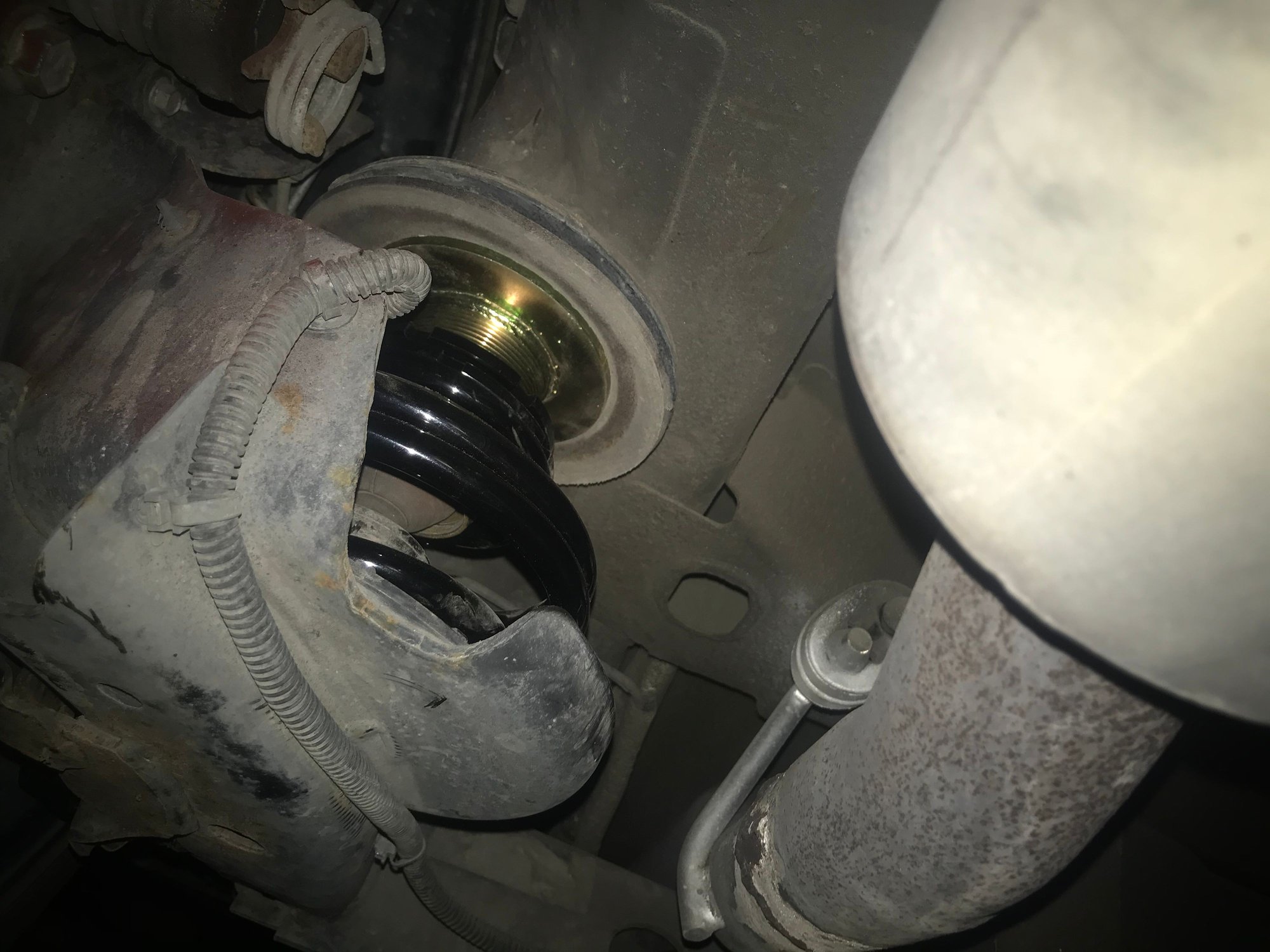

I got a set of Stance GR+ Coilovers and they didn’t come with instructions for install or dampening adjustment (which way is (+) (-) etc, so I don’t know which was is 16 and which is 0. Anyways real question is I currently have the rears in with the adjustable part at the top and wondering if that’s wrong / matters.

right is + and left is -
As for the threaded height adjustment, that depends on personal preference. I also put mine on the bottom.

So all the way + is 16?

Yeah + is 16. And I also have the adjusters at the bottom, pretty much every coilover kit I've seen or used is like that.
