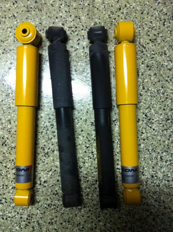

Old Sep 15, 2011 | 11:31 PM
gumby3558's Avatar
Joined: 12-07-10
Posts: 113
From: Florence SC
heres a pic. how do you adjust these?
Old Sep 15, 2011 | 11:42 PM
Wangspeed's Avatar
Joined: 10-22-09
Posts: 3,145
From: Northern Virginia
Adjusting Koni Rears
I just shove down on a piece of wood, and turn it to full soft, then adjust it as appropriate. For you, I'd say 1/4 off full soft.
