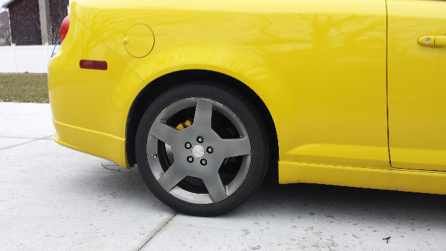

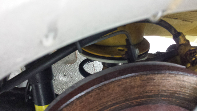

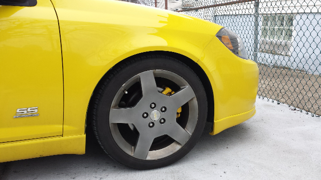

So i bought the lnf strut and yyz package from ced. After the install it seems the rear height didn't go down all that much and seems really bouncy and squeky. If I push down on the rear end the car moves up and down quite a bit. Here are some pics. Any ideas?

Excuse my language, but holy rust!
Guess I see why the northern guys have issues.
As for the car. That doesn't look right as far as ride height. Did you install the shocks the correct way? Does the drivers side look the same?
What springs do you have up front?

yeah same height on both side. the fronts have yyz springs as well. the shocks are installed right as far as i know.

The shocks wouldn't affect the ride height.
It's possible the springs aren't installed completely on the isolators. They are a tight fit sometimes. I can't tell in the pictures.

Not sure if it is the case, but most of the time the tight coils on a progressive springs sit at the top. Your pic shows them at the bottom. I would do some research, maybe email Powell, and see if they should be flipped over.

Let us know what you find out. I did a quick google image search and it showed the tight coils facing up towards the trunk pan. As easy as it is to change the rear springs, you may just wanna flip them over and see if that cures your issue.

I talked with powell, he told me to flip the springs and see if that fixes it.

No change. Exactly the same.. very strange.
