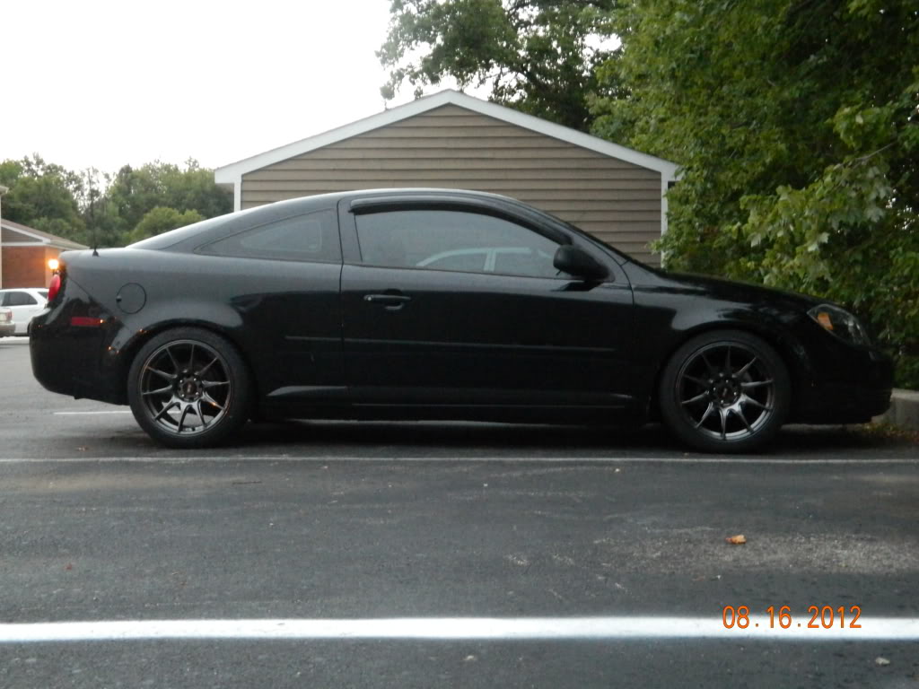

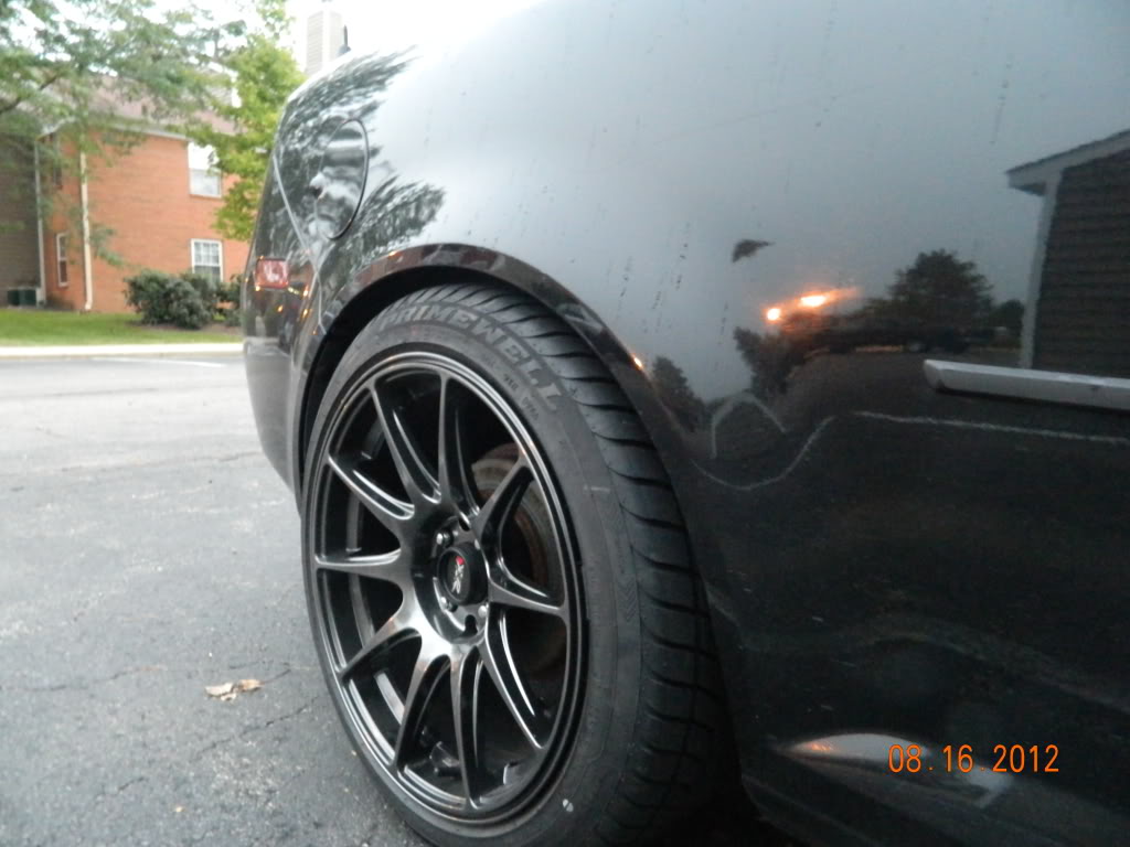

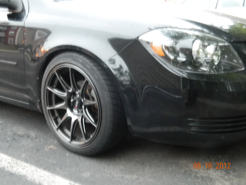

The quality seems really nice for the price, the only complaint i have is the rear is way too soft. I have all rings on and low as possible, nearly tucking tire, about 1/4 from tucking and i bottom out a lot in the rear. I have the fronts on 9 and the rears on 7. I wouldnt reccomend them to anyone until they come with a stiffer spring in the rear. I will be ordering different springs for the rears and have the shock revalved.
17" XXR 527's +25 offset.
215 45 17 Tire

Hey those are the 8.25 wide right. I haven't seen anyone with the 9.75 wide on the four lugs.

Miles Power - Rim size is 17x8.25 +25 offset.
These look great on the coupe. But some people think I should try to run the 9.75 wide on mine cause I will make it look more agressive. But I feel like it would poke a lot and ride like crap.

yea the 8.25 with the +25 offset make my car sit really really flush, i have rubbing issues too. I cant imagine have 9.75 on there, it would look stupid. If the 8.25 isnt enough you can always buy spacers. Also my fenders are rolled and they still rub pretty good.
