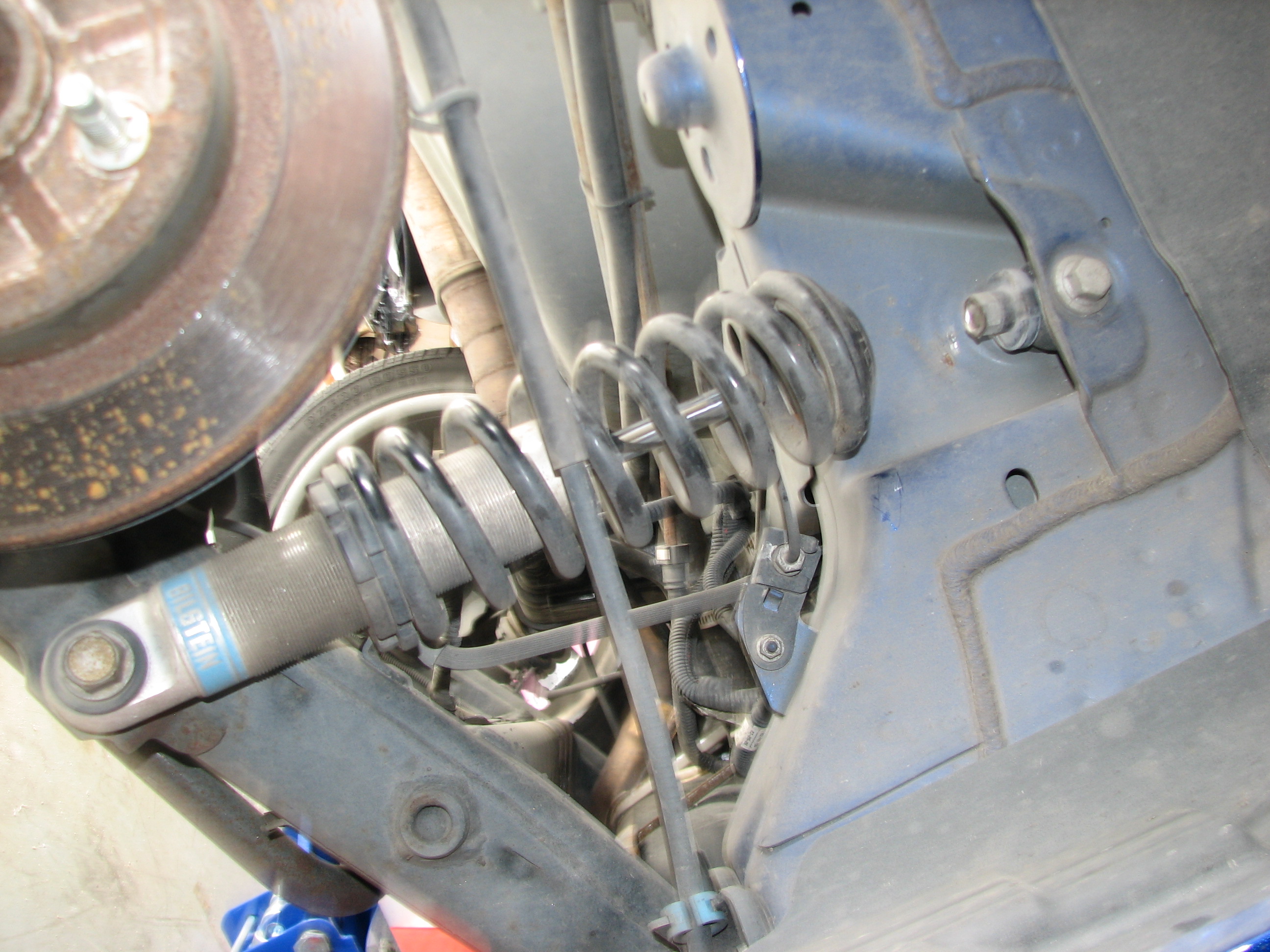

DO NOT run a coilover in the stock shock location. 2 have tried, both coilovers snapped.

Thanks for the warning.. But what part of the coilover shocks snapped? Oh and can i just run some adjustable coilover shocks withoit the springs on the and use my lowering springs?

Oh i see thanks alot man.. But it wont snap if i used the seperate springs with just that shock right?

yes it wont snap thats why its made that way lol just buy one of the options out there kw megan stance ksport pedders there is already a ton of options
