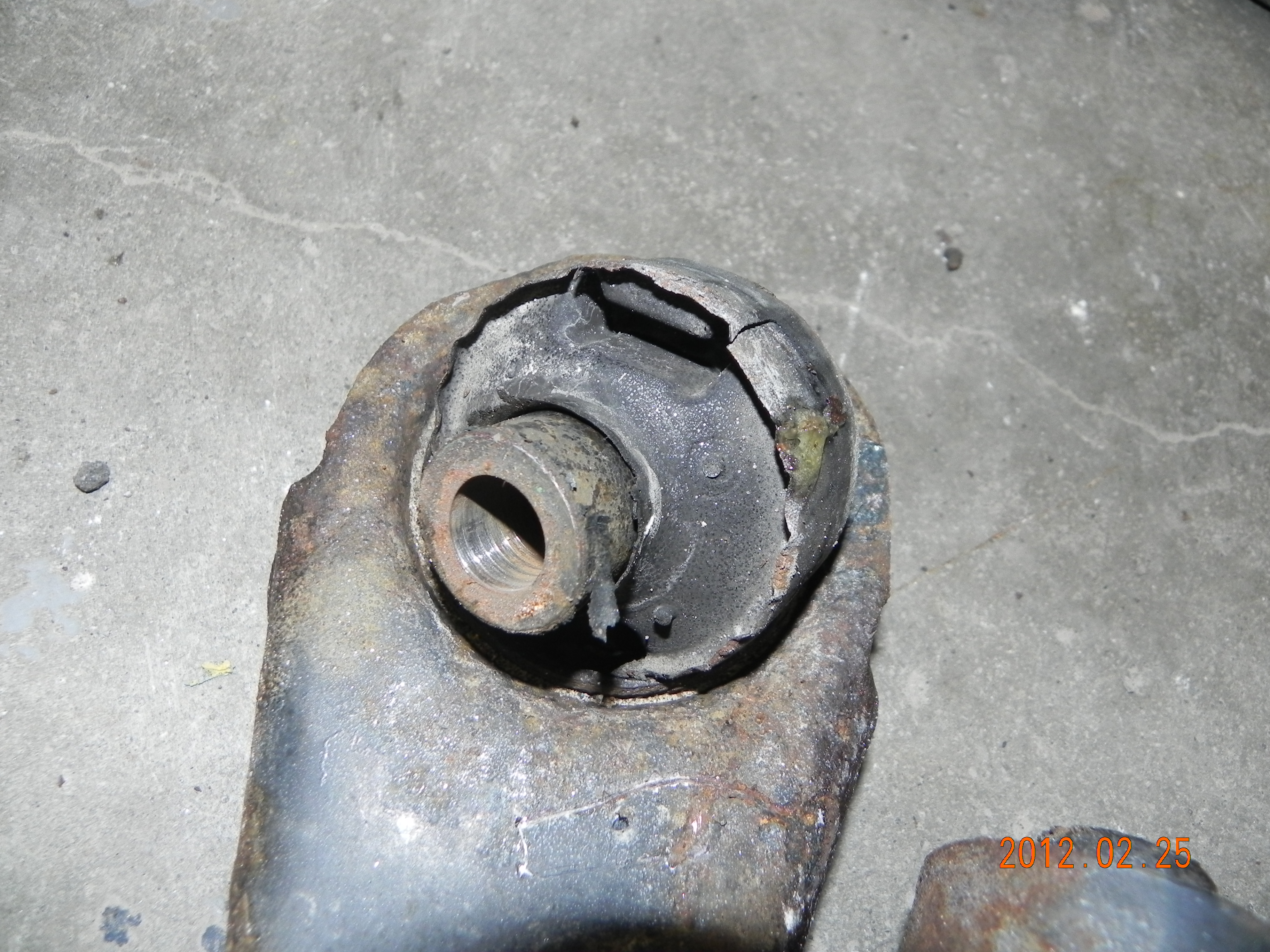

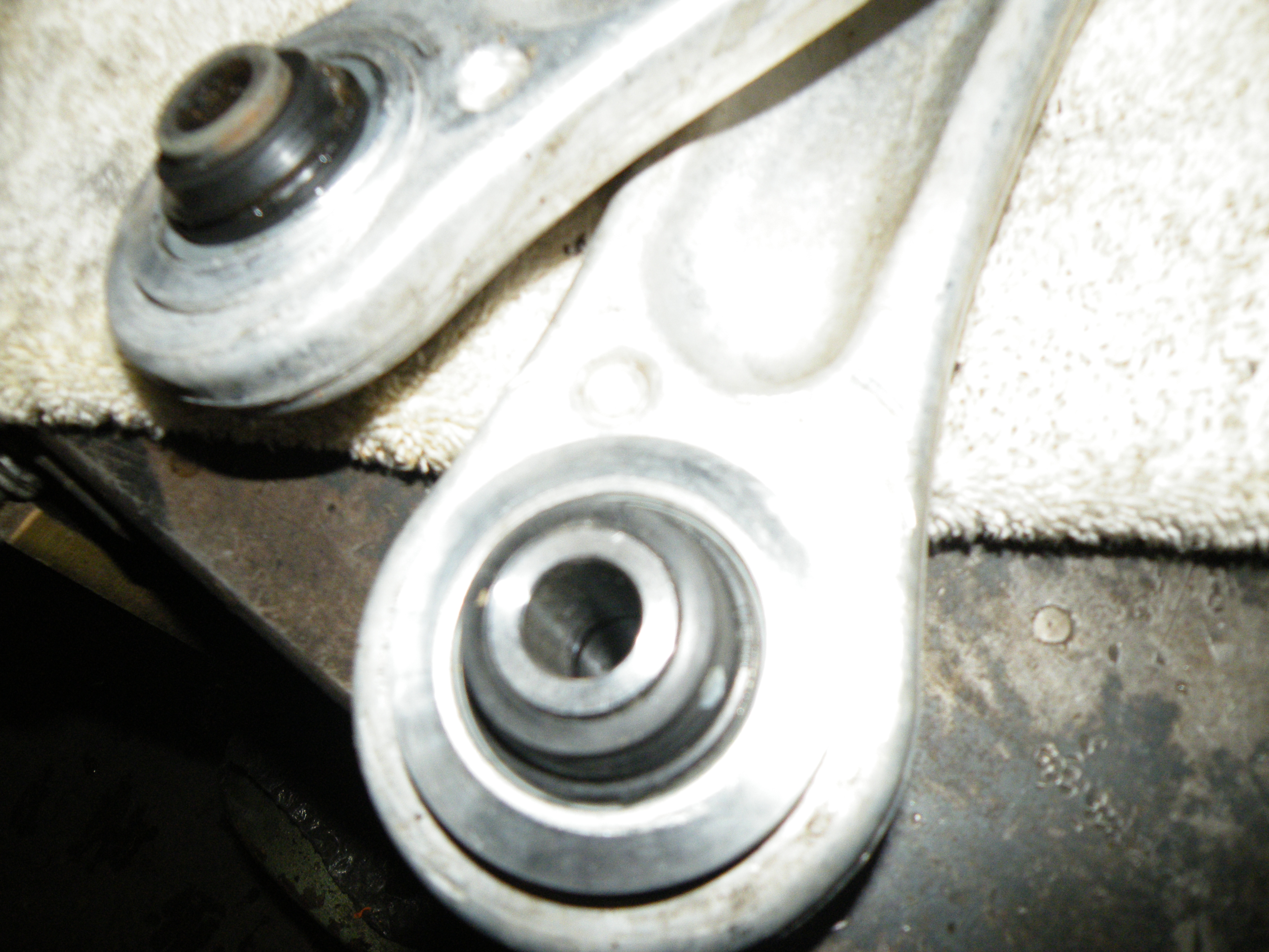

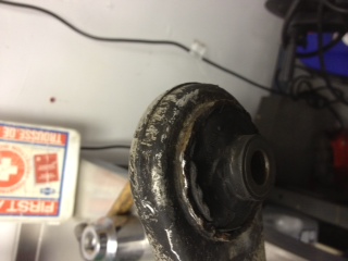

^^^ For the price the latest 2010 valving , brand new FE5 struts and shocks ; cabs and a rear bar when you can afford it will complete the picture. If tight for money CABS above all the soft rubber rear training bushing is wimpy.

this photo, someone thought the malibu non voided bushing would be better.
this is what 199 gets you; cross axis joint

and this is what stock bushings look like when they are ....toast

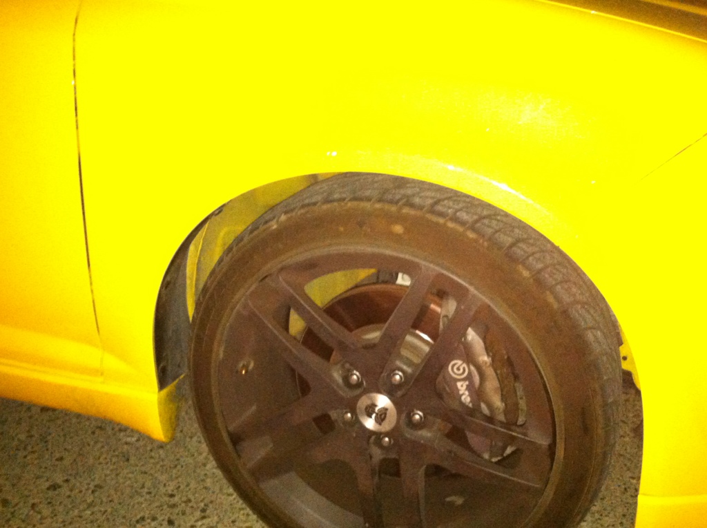

I have V2's and they are amazing looks gud with the added drop, will be doin koni rears and already have the hardcore rear sway bar, love it
Kind of a bad angle but my front with yyz v2's installed
