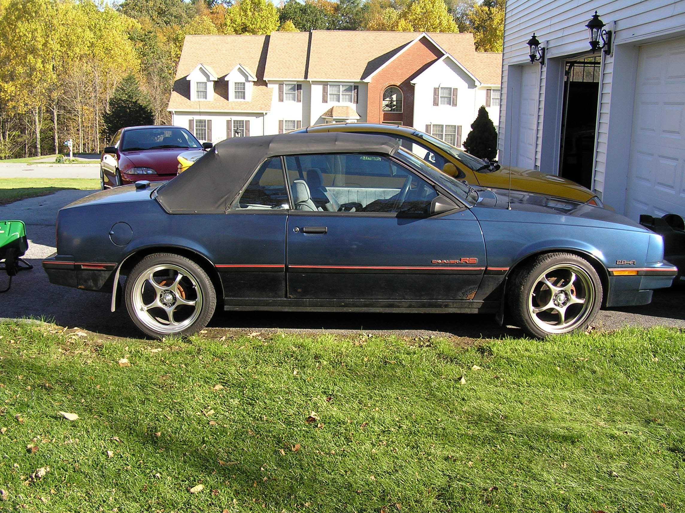

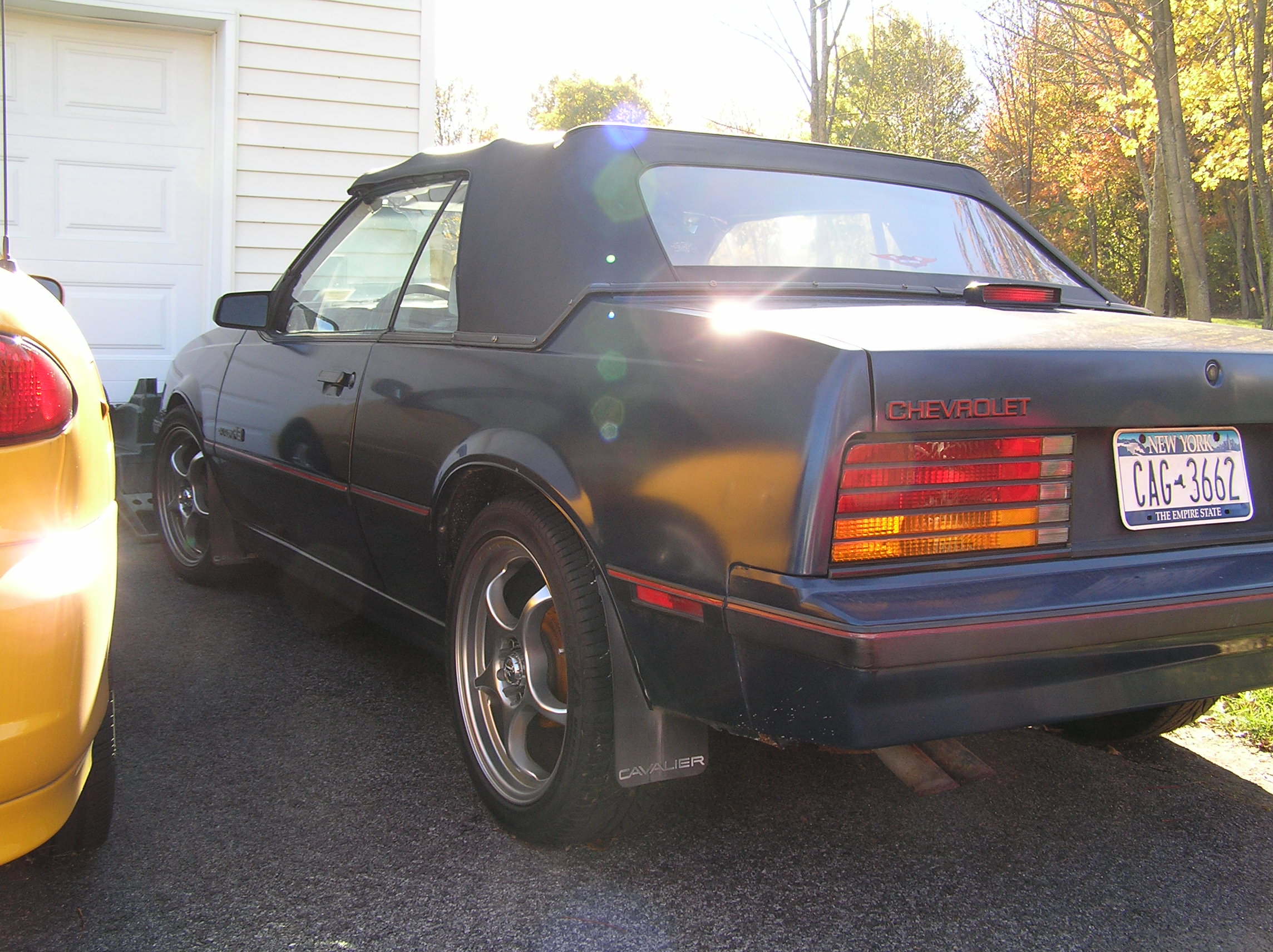

I can't remember if we had to open the bottom 2 holes up. I don't think so. I think we kept them loose until the top was tightened down. I never had any problems holding alignment on the car. The following pictures show the drop. I will see if I have a picture of the top strut mounts.
