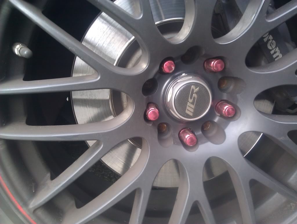

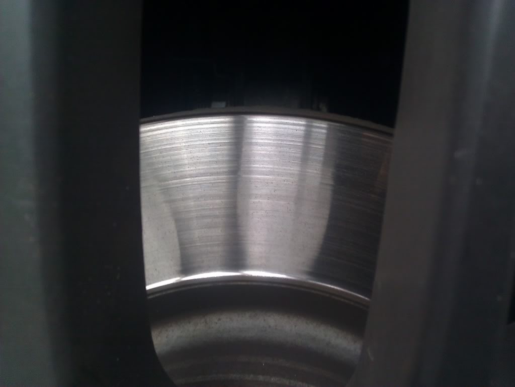

heres some pics

that seems to me to be normal wear. its from the edge of the pad, cutting into the metal of the rotor. not sure what the SS/TC factory pads are constructed of, but performance pads are typically noisy.
Old Jan 9, 2013 | 07:10 PM
aaol1's Avatar
Joined: 01-01-13
Posts: 22
hmm, i would have thought that something cutting into the rotor would have been bad. yea they are extremely noisy, like from 40-0 km/hr its squeals all the freakin time
Old Jan 9, 2013 | 11:15 PM
might check your rotors for wear make sure they aren't at or under their minimum thickness (don't know the specs for that on the brembos)
