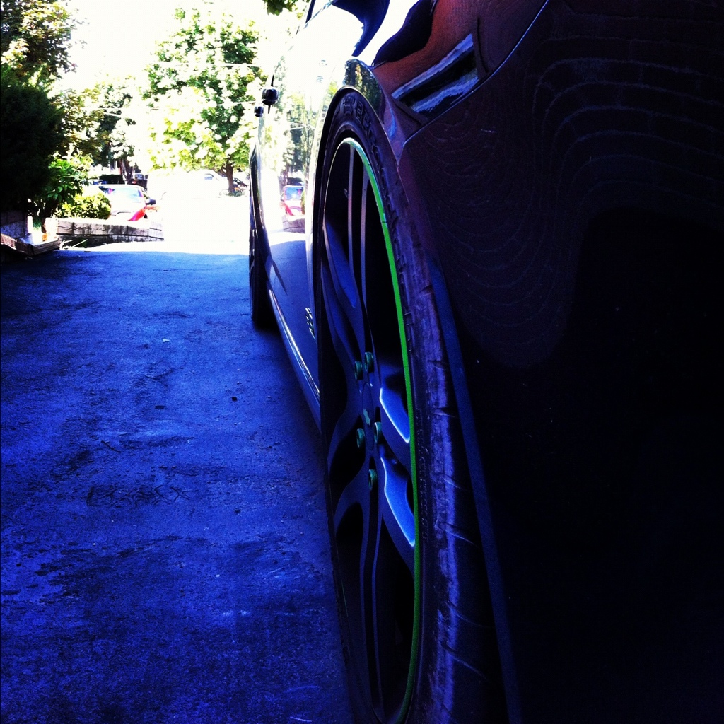

5mm spacers in the front are perfect on tc rims
Old Dec 14, 2013 | 02:31 PM
C_A_D88's Avatar
Joined: 12-05-10
Posts: 3,877
From: newmarket
